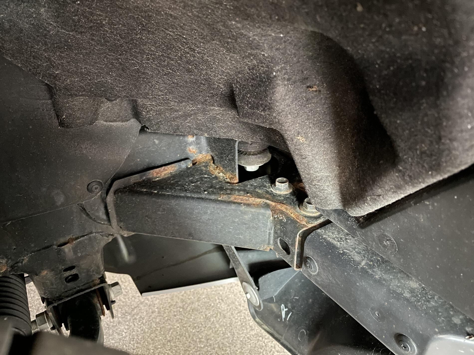

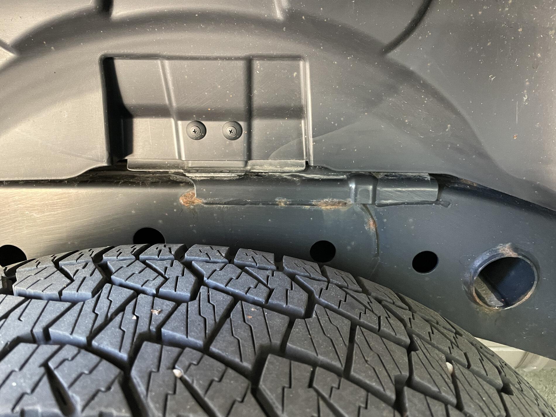

Appologies if this has been asked already but I was wondering what you all do about rust on the frame. I'm more a car person and there, any kind of rust is bad (with the exception of rotors and such).
Our Ranger is now two years old and after 2 Chicago winters and a good detail last weekend I found some rust on the frame. Do you just sand/brush is off and then prime/paint? If so, what paint (to match the rest of the frame)?

Fact is you live in an area that is absolute Murder on vehicles. I've seen 4 yr old Silverado's and such with body paint bubbling down low from areas like yours. All you can do is get some sand paper and a good can of black enamel paint and spend a few hours a couple times a year up under the truck and 'try" to keep it under control.
those crash bars could actually be removed and painted better and they might last a long time. If you don't do something to them they will be total crust by this time next year.

I put a copper brush wheel on my driver and get all of the rust off, spray primer on the area, and paint with flat black quality paint. Normally can't even tell it's not factory. I actually get under my vehicle and inspect it once every 6 months or so.

Highly recommend fluid film or a rust inhibitor, sanding and painting is okay, but rust will still form under the paint if it’s anything deeper than surface and now you can’t see it.

I live in Iowa so we have similar weather. I got this Woolwax kit last fall and it's held up really well. It doesn't stink like Fluid Film, it's non-toxic, and it's not petroleum-based. I just put a decent coat on any metal parts on the underside of the truck (minus the brakes) and also used the optional 18" wand to spray inside the frame. I bought the Ranger new last summer so this was the first winter driving it's seen. Based on my experience, I'd definitely recommend it to anyone.

I have a 2011 Ranger. Wish to purchase a 6G. I climbed under the Ranger this Spring. Knew there was some rust forming. The WET COAST.
I take the truck up to the local Mnt's in the Winter.
So, I wire brushed the rust spots and sprayed it with a flat rust paint. Not incasing the Rust.
The common spot's are, Seams and the Rad support.
Dirk, if you can see Rust on those accessible areas it will be Rusty on the Under Carriage.
A lot of the undercarriage landscape is inaccessible. With a hose you can wash around those areas.
I was wondering what members feelings are with getting a brand new truck and having it coated underneath. Most thoughts are that its not a good process. The rust get's under it and then you cannot see the rust. Would Rino Coating work ?
