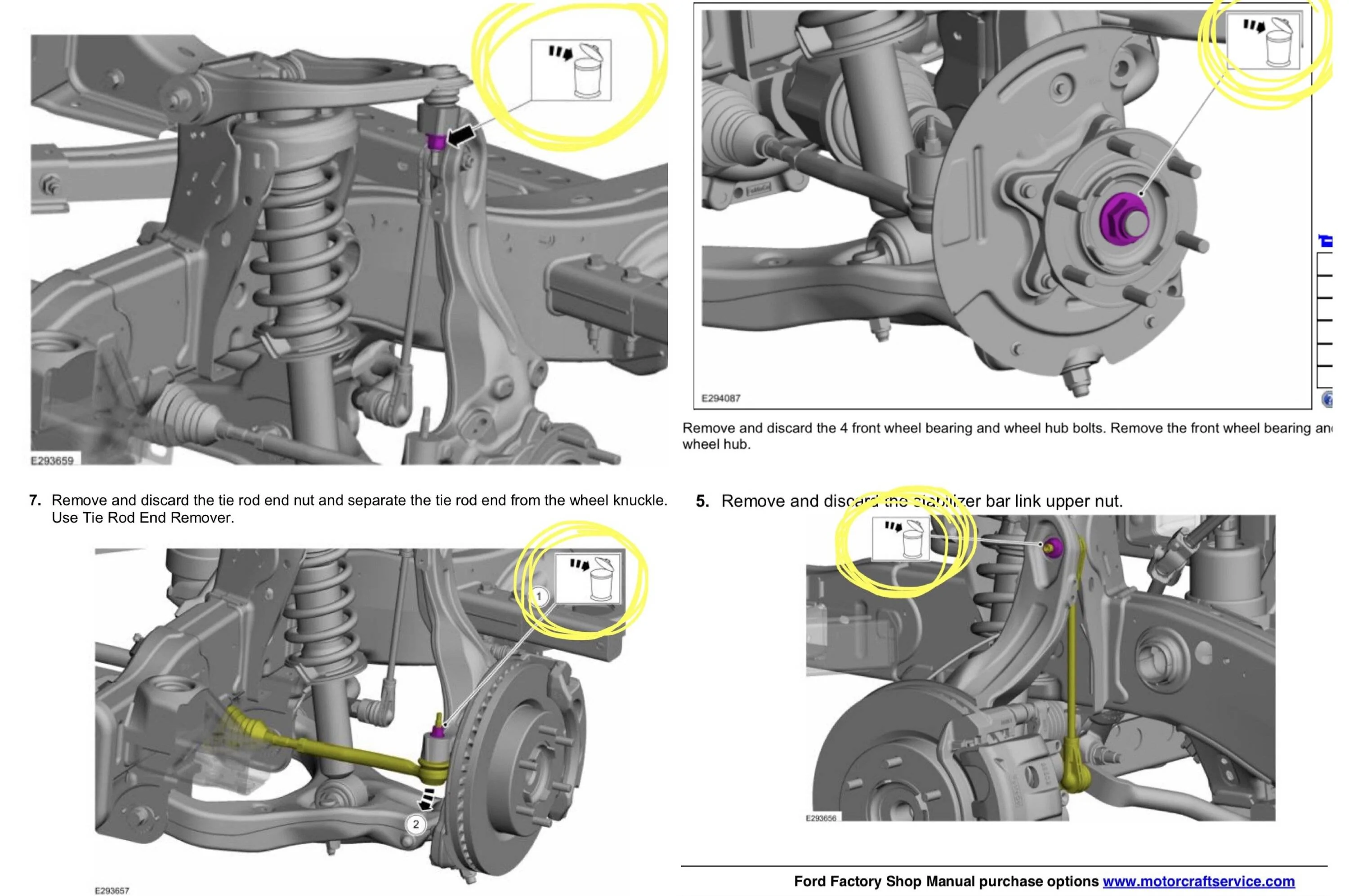

I'm looking to getting the fox 2.0 kit or the fordperformance version. If i ordered would I need to buy anything else with it? I would like to keep the same height. I would have it professional installed.
I purchased this kit from Ford website and had it installed at my local dealer install. There are no extra parts needed. The coilovers are adjustable, but I believe the warranty is voided if they adjust them at all from how it comes from Ford. Love the suspension by the way.

The instructions for the FP Fox kit call for most of the removed hardware to be replaced. That's probably the extra parts you are seeing.
Personally, I only replaced the axle nuts.
did you take the axle all the way out of the hub, or just loosen it up a lot?
I am hoping to do this on Saturday.
