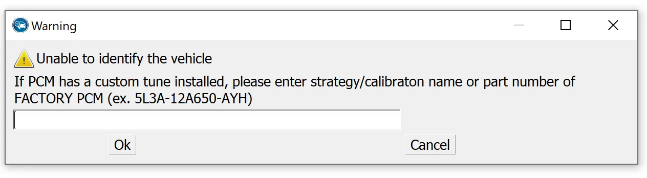

if you can post the exact error you’re getting, that will help. Without it, I don’t know what we’re working against.
unable to identify vehicle...
Jhbryaniv
Sep 19, 2022
2,790
7,479
2023 Ranger Tremor
https://www.mustang6g.com/forums/threads/getting-forscan-to-read-a-tuned-car.122019/page-2
Using some of the steps here I attempted to input the part number it is looking for.
(downloading as builts, opening them and dissecting them)
thus the ask if anyone has gotten it to work on a '23 yet... Because if no one has, I will need to email the forscan folks and see what they say. according to their website though it could take a while for them to ge back to me... (longer if they have been conscripted :/ )

In the past, it required a new version of FORScan to pick up new years. First thing I'd do is make sure you have the absolute most recent version installed. If you do and it still doesn't work, then email the FORScan folks.

Yeah, I removed and reinstalled 3.5 yesterday a few times... Each time going back and clearing all the leftover files hoping there was something left behind from a previous install. Log files, database, reg entries...
Intriguingly it says the 3.5 version has 22 & 23 my vehicles...

They used to have "beta builds" that had the newer models sometimes but I didn't see that. I remember way back in the "dark ages", when the 2019 was new that we had to get beta builds for a while so it would work. Every year the app lags the MY release a bit, but they eventually catch up.

I am not a Forscan Guru, and it is still new to me and still learning how to use it.
But I don't remember having to input PCM Part Number, it should read it automatically when it scans the system and loads the trucks profile, now being a MY 23, might be the factor IDK.
I am assuming you are using OBD-Link EX, by your statement.
1. Try updating the Firmware on the adapter: OBD-Link EX
2. I know that when the truck is connected for the first time, it takes a few minutes to load the trucks profile, and I never fully understood if it automatically finds the as-built files I downloaded from the Ford Motorcraft Services or does Forscan download the file itself after it performs the initial scan of the truck, I just remember it did take some time to finally get into being ready to read and tweak.
3. So, on initial first-time scan, it may need WI-FI, I just do not remember for sure.
4. Try, having the truck running with the initial hook-up vs (KOEO) Key On Engine Off, this might help in getting Forscan to read the VIN# and or PCM part number.
5. Although you mention clearing files, did you clear out the old profile and start a new profile?
Just some thoughts to throw out from a novice user.

I will try and update the firmware on the adapter . . .
https://www.amazon.com/gp/product/B081VQVD3F/ref=ppx_yo_dt_b_asin_title_o01_s00?ie=UTF8&psc=1
Yup, per forscans instructions I bought the reccomended adapter.
I tried in all 3 key positions (well 4 really, but I knew off wouldn't work) and the one I got to connect on was truck running.
I ran the app as administrator thinking it was a permissions thing on the laptop. . .
:-/ shrug - I'll send them an email this evening when I get home. . .
