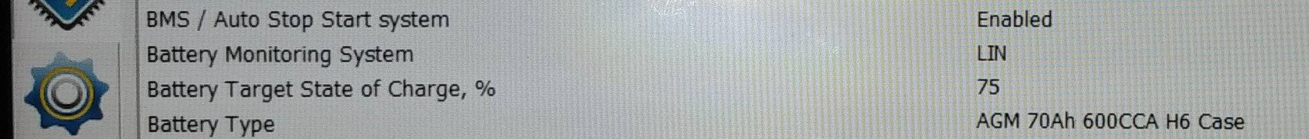

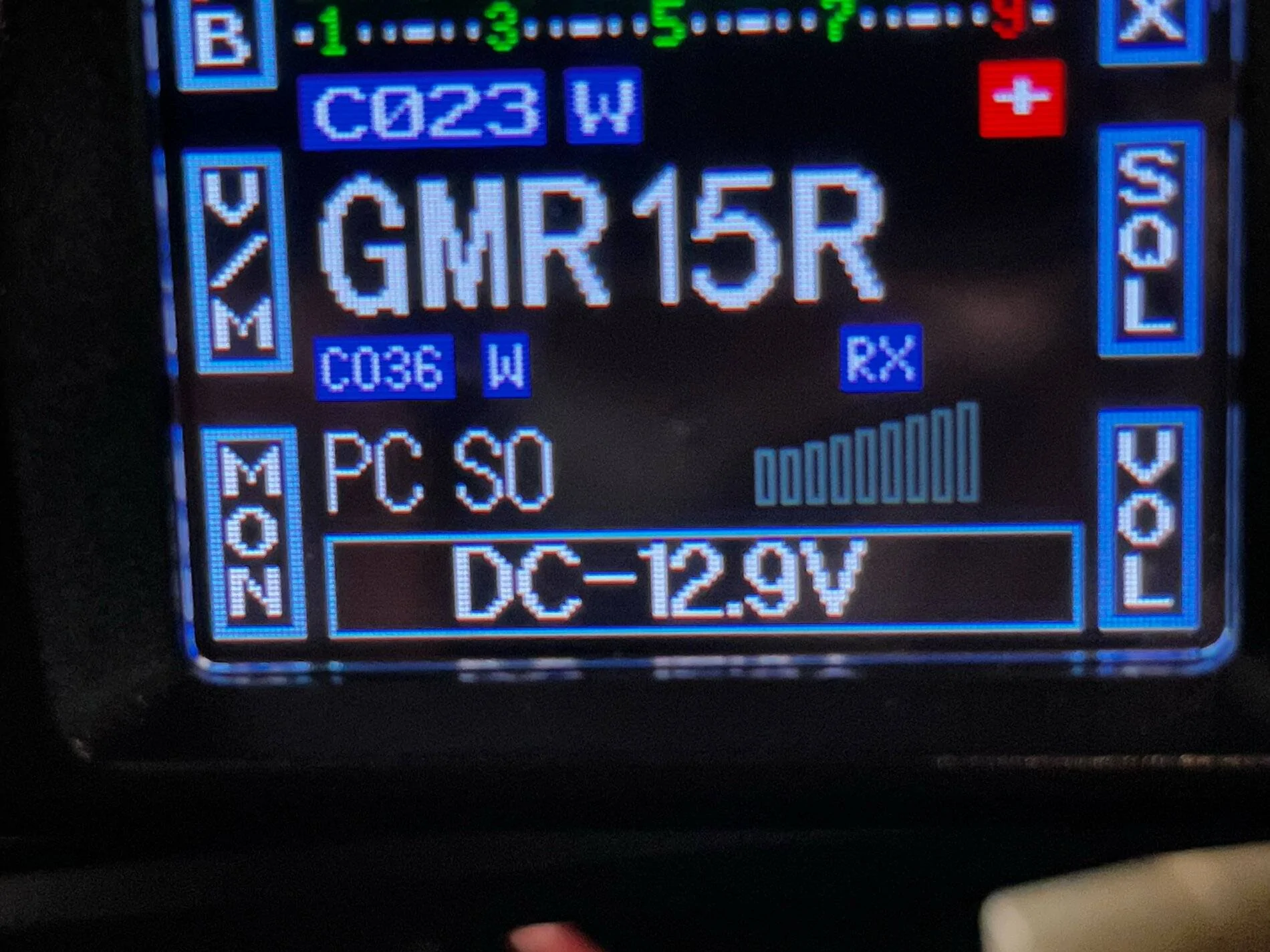

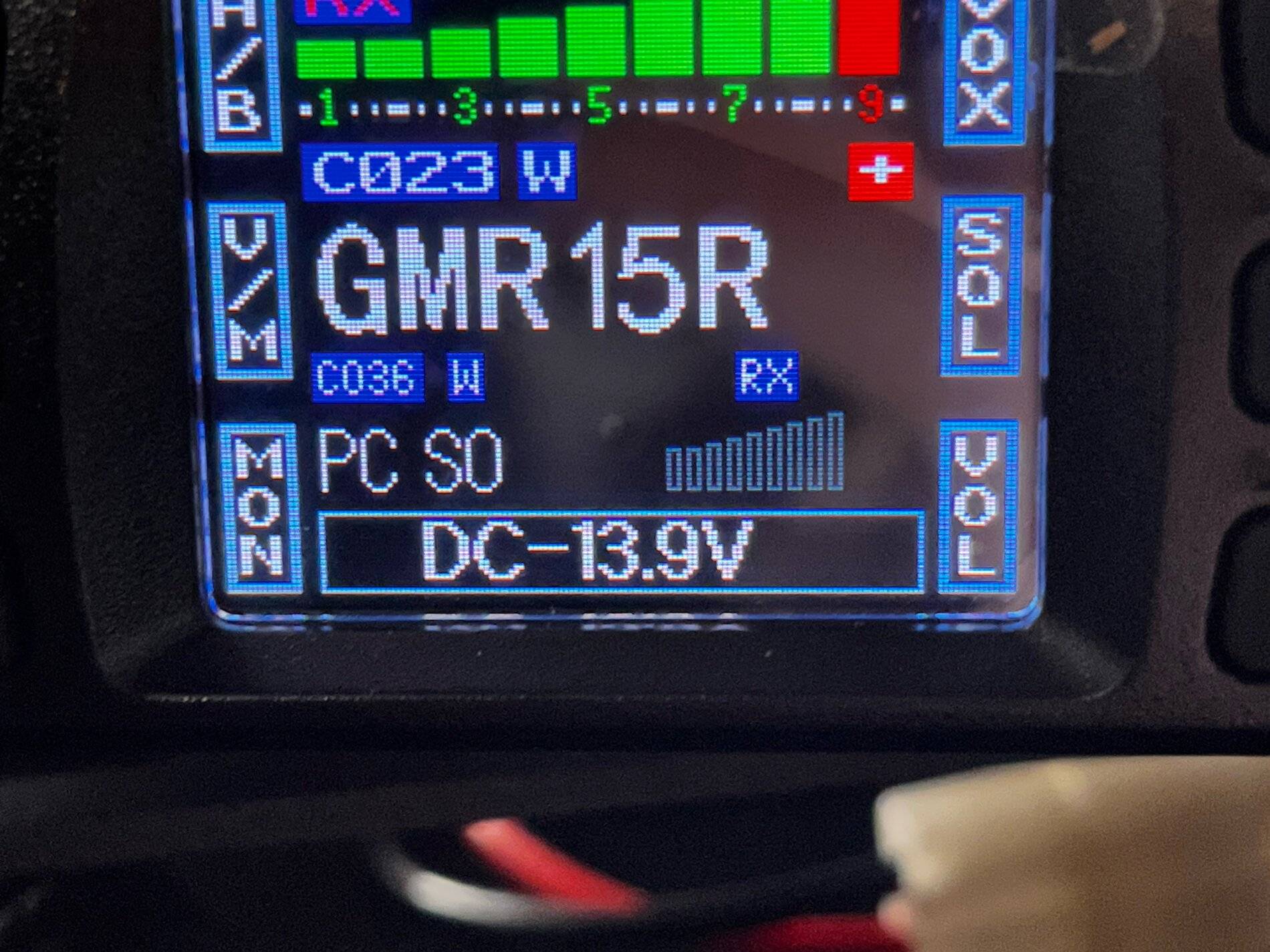

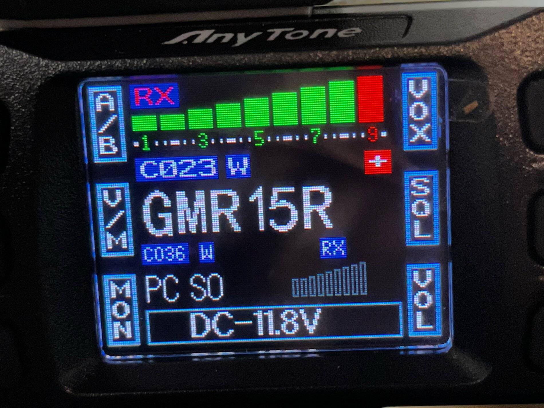

I turned it off in the BCM, as I also changed my SOC to max 90% it may affect the charge rate. I get 14V first thing starting the truck, then after running or driving for awhile it drops to 12.8, if I turn on fog/headlights it will go back up. I have a digital voltmeter in my HAM radio that is connected directly to the battery.
After sitting all night:
After Starting:
After driving 10 miles"
