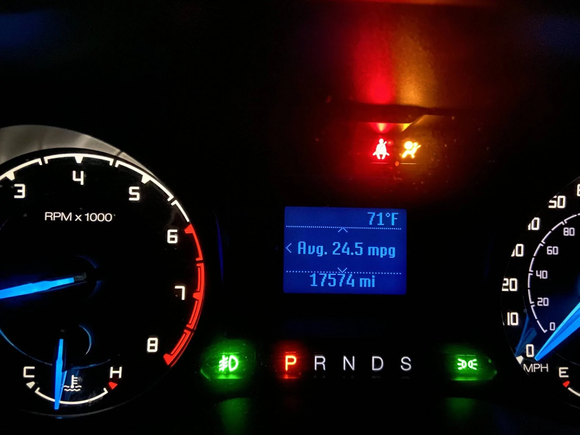

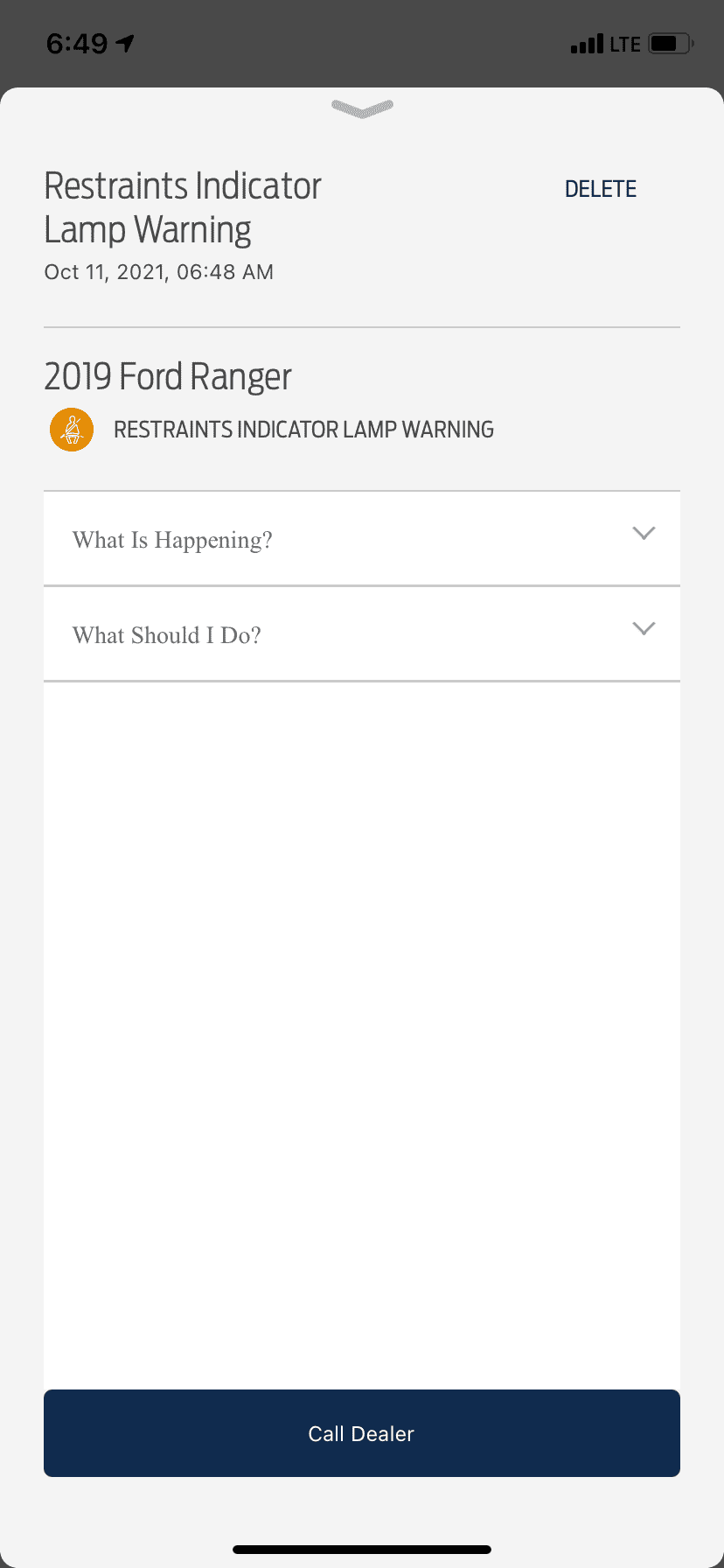

So I went trough and tried to remember what I set and set it back and I think I was mostly successful except now I have the airbag light on… any ideas what I did?
