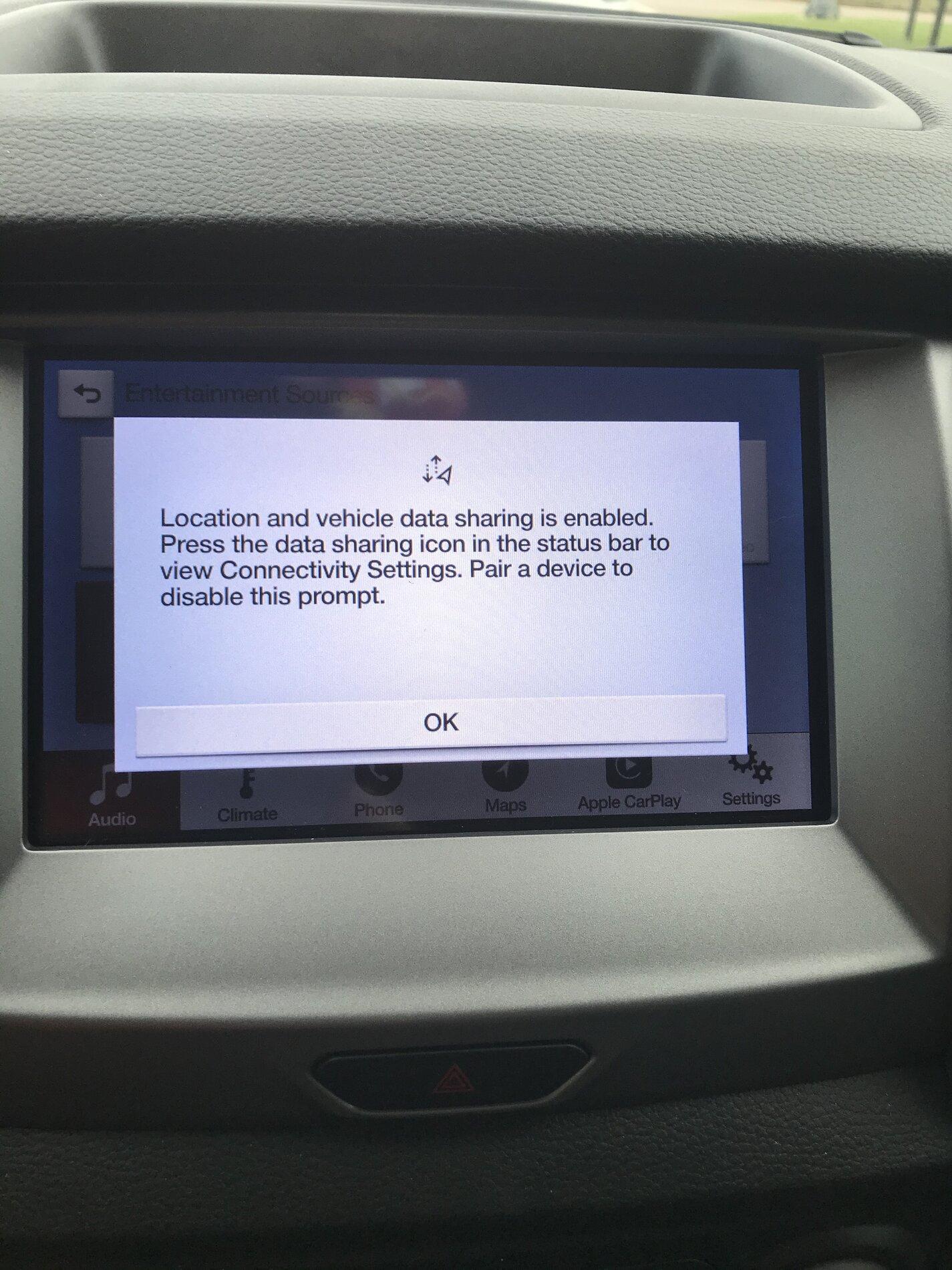

"Location and vehicle data sharing enabled" message
scubalizard
Nov 23, 2019
81
47
Houston
2019 Ford Ranger XLT
How do I fix this error message
slowmachine
Jul 18, 2020
930
1,972
New Hampshire
“pair a device to disable this prompt” ?

It seems only to happen when I pair my phone via the cable to the truck, it is already paired via BT when I start the truck. It wouldn't be so annoying if it came up soon after, but it seems like it is random. Sometimes it pops up by the time I leave my driveway and other times it is 15 minutes down the road and the prompt pops up and you cannot do anything with the radio until you tap the OK button.

This is due to how your vehicle communicates with Ford Pass. The catch is when you connect via usb for CarPlay, this service needs a bluetooth connection. CarPlay disables that bluetooth connection upon connection. Once that happens, the system throws this error.
There are 2 ways to get rid of this message permanently and both suck.
1. Don't use CarPlay (not sure about android auto) and allow your phone to connect via bluetooth when the truck starts.
2. Turn off the Ford Pass features which will disable Ford Pass remote start, lock/unlock, vehicle location etc.
Sync 3.4 does not fix this message. I get it every single day. It goes away on its own after about 5 seconds so I just ignore it now.
