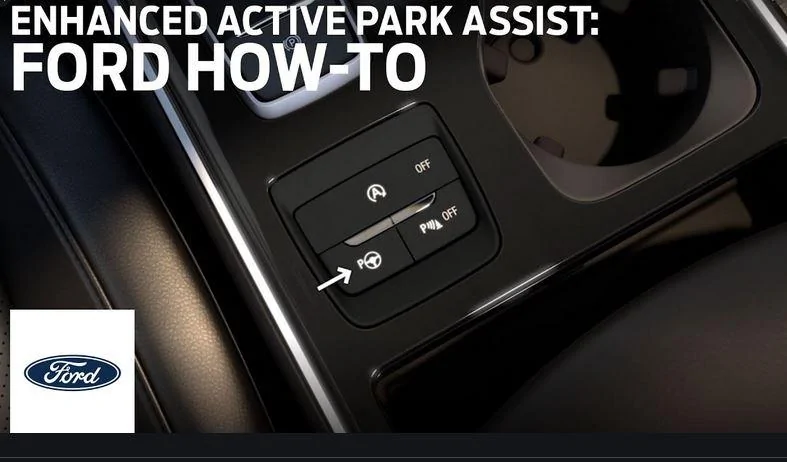

It'd be nice if they had included it on the NA ranger, but even if we found the correct code to turn it on, it wouldn't work. Ford's semi-assist parking has to be activated via a push button that is typically located near the shifter.
Since ours lacks this button, and likely the harness is different as well so even if the button were added in, there would be nothing to connect it to.
