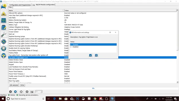

Anyone a guru here that can walk a noob through some simple changes for example, Bambi mode? I tried and failed but think with someone talking me through it I would be ok after completing a change. I attempted the change for Bambi mode, hit write, and it did not take effect.
Unfortunately I am not an expert. I have made some changes but I have only been in there a couple times so I have to do some trial and error each time. The screen below is the one you want for bambi mode. The video linked was helpful to me. After you select enable and click on the check mark and click on the Write button, I think it prompts you to cycle the ignition . I failed to do that on my first attempt.
I am thinking about attempting the one about the speed limit sign display. I will try to document my steps so maybe I can be more helpful.
I am sure there are many more knowledgeable than I am, so hopefully one of them will jump in and help you.
