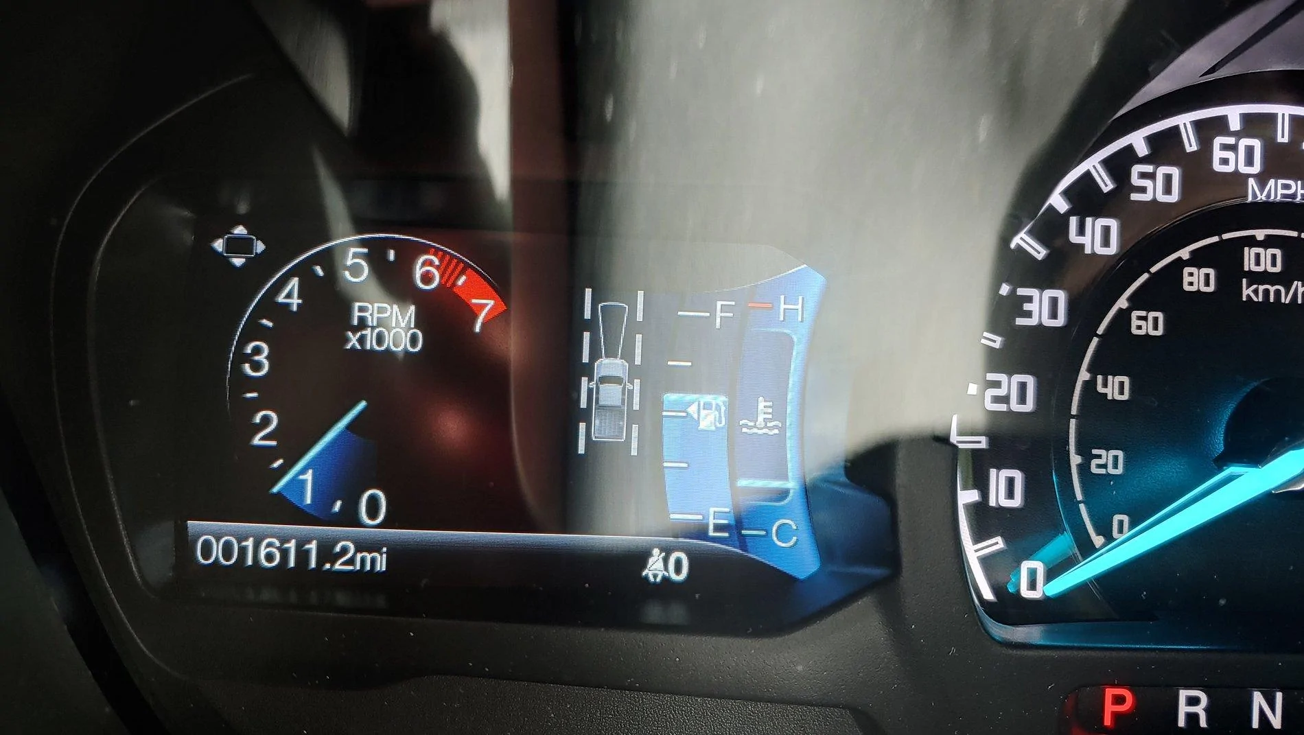

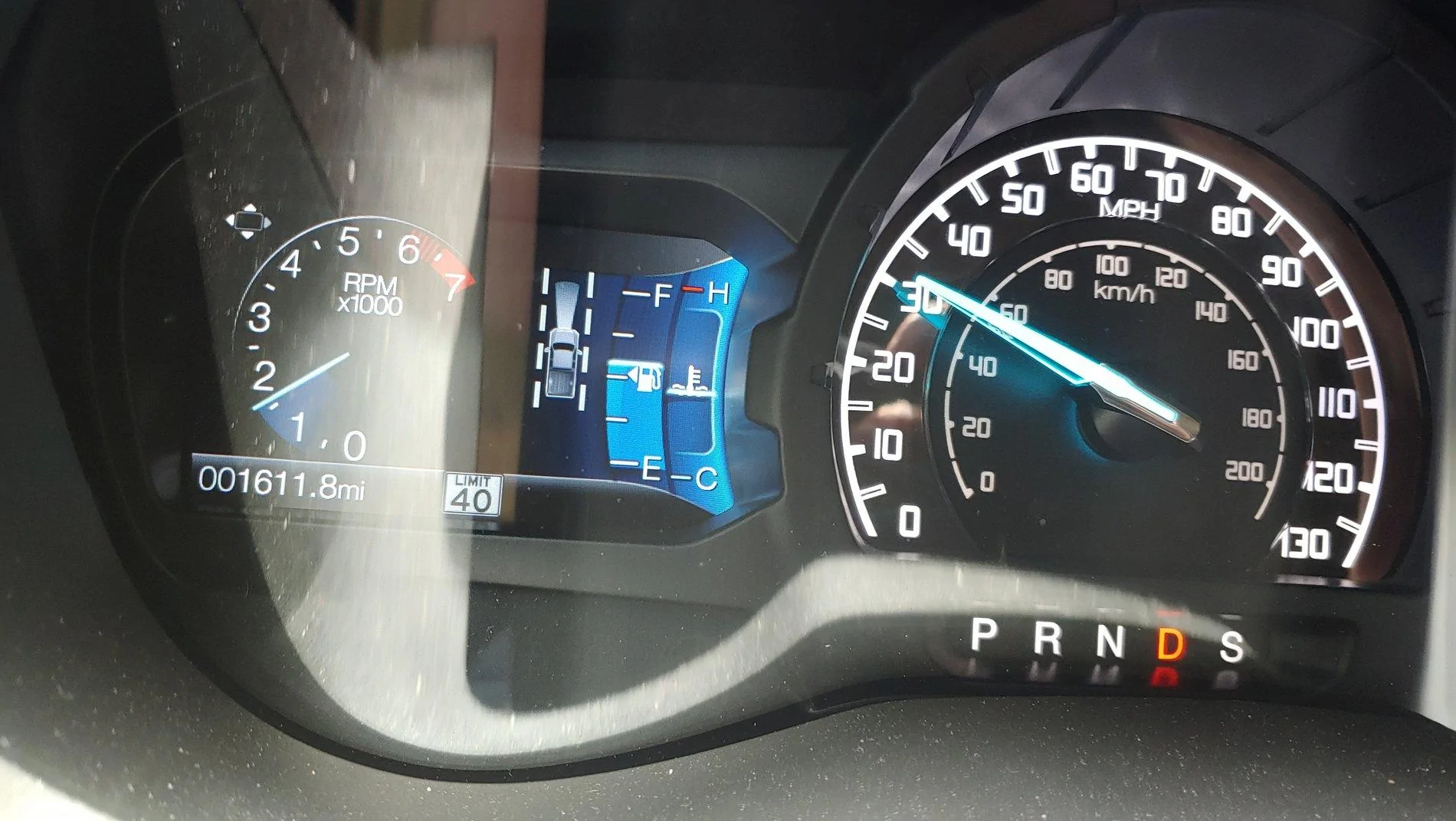

Yeah.. Sorry about that. Here you go @Big Blue @quangdog.
This is what it shows first starting up or prior to detecting a speed limit sign.
And this is what it shows when it detects a sign.

Whoa. That's ... odd. Yours is a 2020 Lariat? (Mine's a '19, but not sure that makes any difference at all)
I wonder if it's a) difference in system software version numbers or b) something else is gummed up in your Forscan settings.

Interesting, I haven't seen anyone post seeing NA signs like that! Wish I could get mine to do it. Does it flash at you if you go over your tolerance setting?

Lol yeah. 2020 Lariat with Sync 3.4.20136 installed (Cyanlabs) so now that I think about it, this could be why it's doing this.
Honestly I don't know if it does. I have barely driven it since I enabled this in Forscan and have not pushed it past the speed limit. The only sign I have actually driven past is only 60+ feet once I turn out of the neighborhood. So unless I romp on it, I'm usually only going 30ish when I pass it as in the pic.
I can always try to downgrade it to 20021 or 19274 if it doesn't show the speed warning alert and see if it's something that changed with the version i currently have installed.
