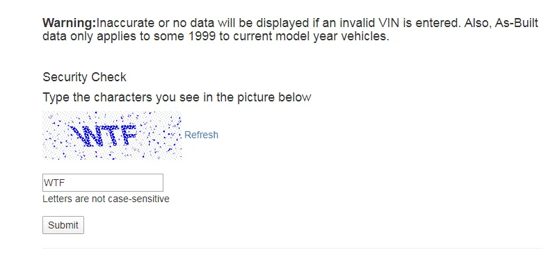

Use https://www.motorcraftservice.com/asbuilt/ -- on first use, the site will ask for language then toggle to login. Reload https://www.motorcraftservice.com/asbuilt/ enter your vin and answer the robo blocker and you'll get a full list of the data. There's a download tab so you can save off the data.
But... Ford and FORScan use different formats so you can't just download from Ford and apply using FORScan.
Thank you! I guess it was that refresh that was tripping me up. I was able to download all my asbuilt data.

I just did this, I thought the Robo locker was funny?

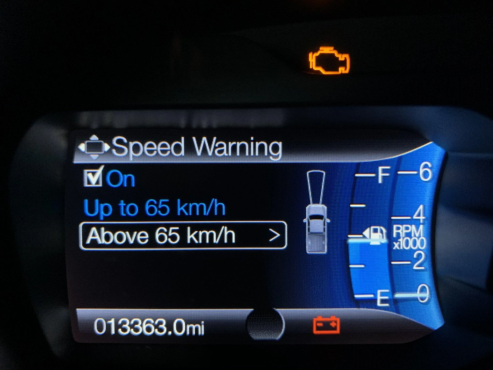

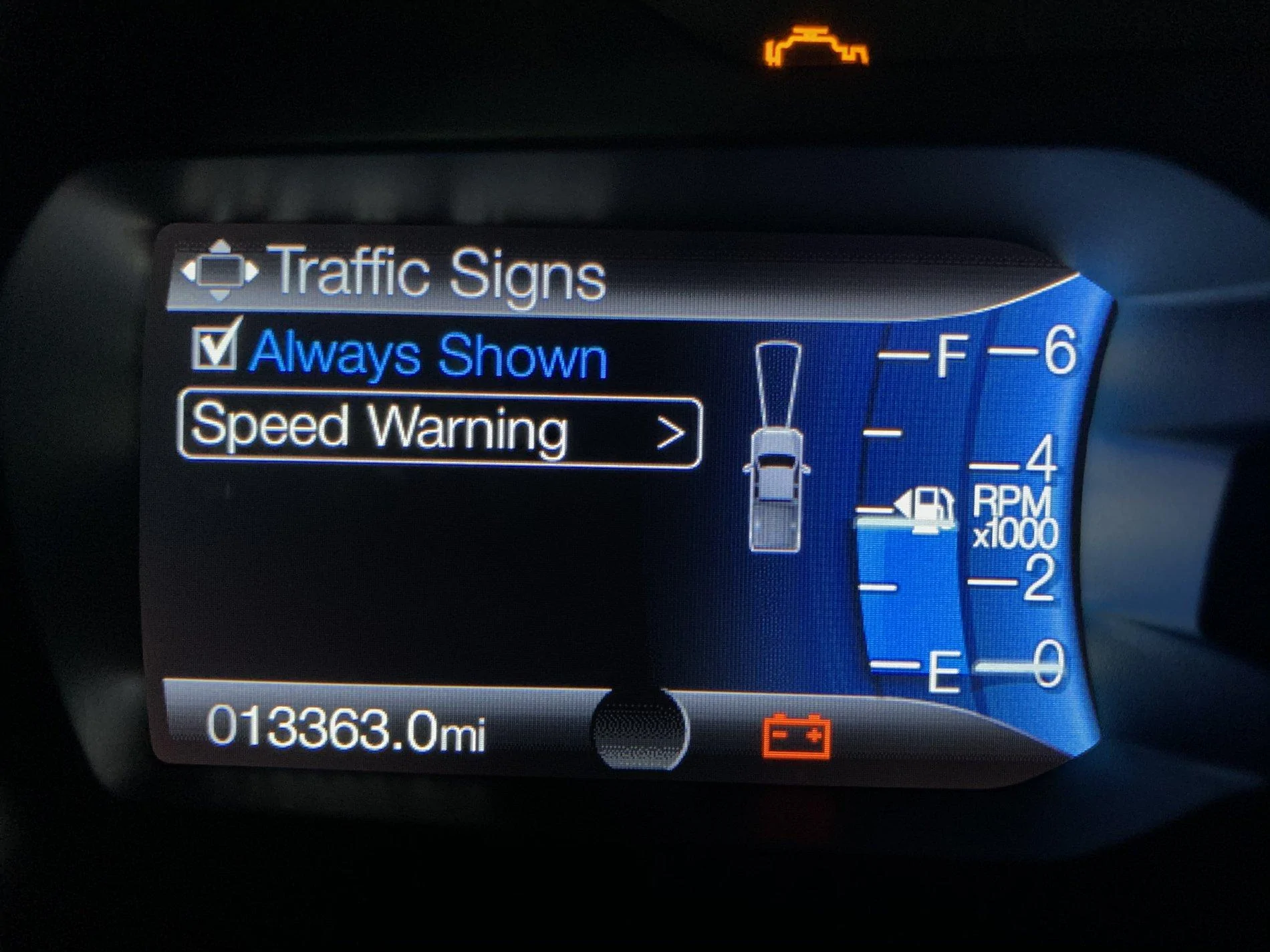

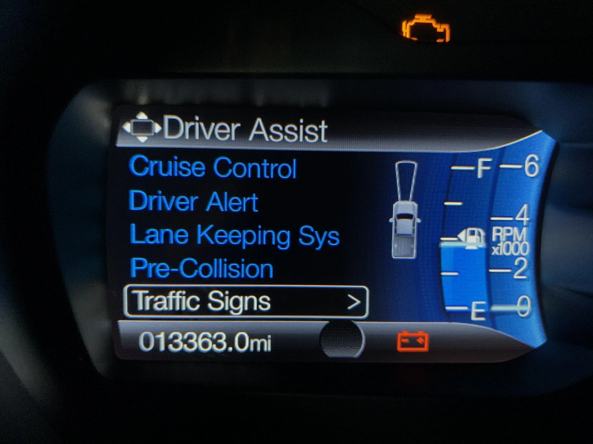

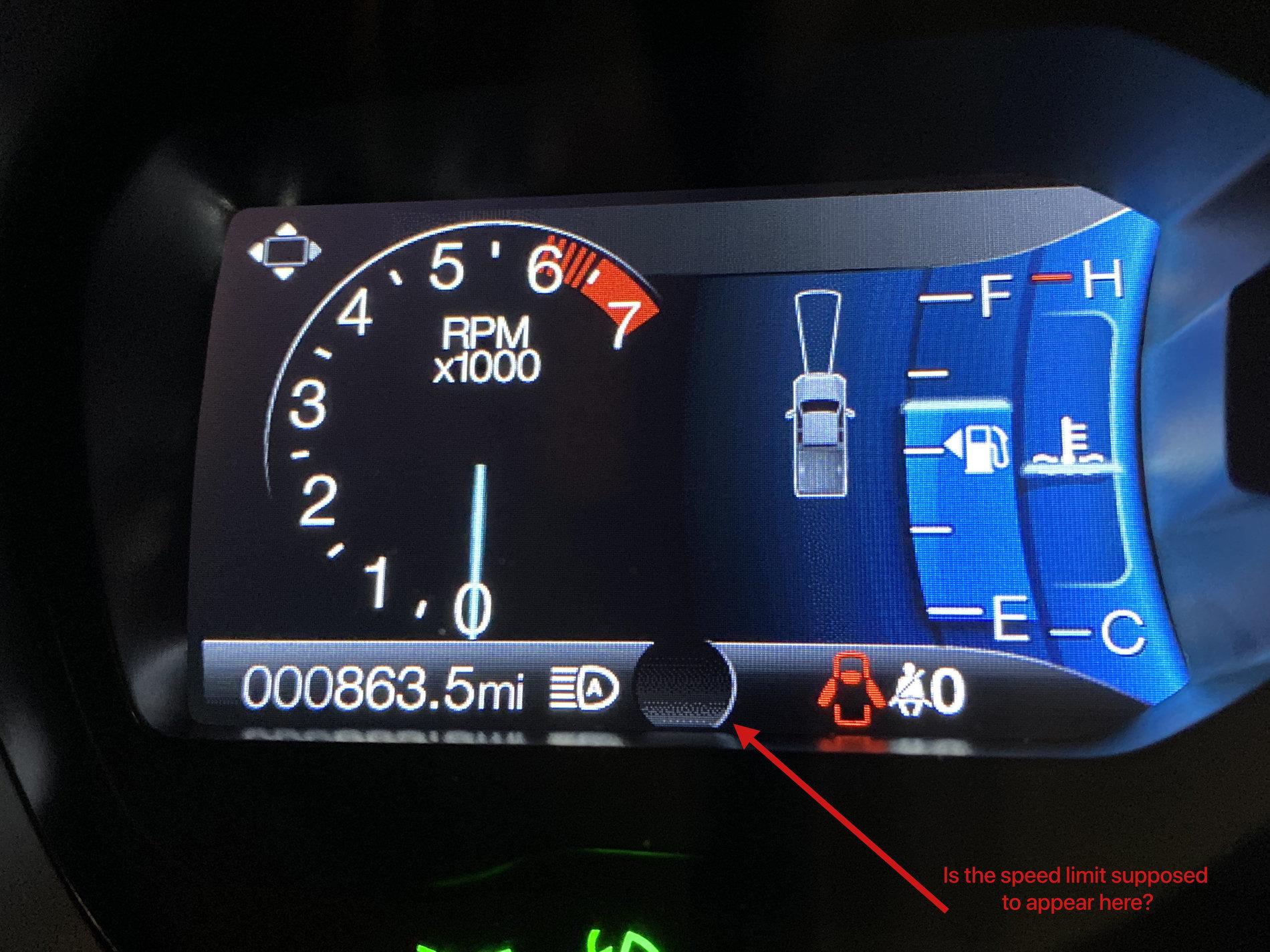

I have the same option enabled now, but it does not seem to actually do anything. It added the small round area to the lower portion of the left hand screen, but no speed limit ever shows up there, and even with all the warnings turned on the truck could not care less if I exceed the speed limit. I really want to know if this truck can actually read the street signs as I pass them. Prior to enabling this feature today, I've intermittently had a speed limit indicator present on the navigation screen, but that seems to come out of GPS data, not actual posted speed limit. Sometimes it's been off.
Can a 2019 Lariat actually read speed limit signs?
Here is the bit that turns on when I enable the "Traffic Signs" system.... but no icon or anything ever appears down there. Just a black circle:

Only works for outside North America. Most likely Europe.

It seemed like a non-US option to me and never worked.

Try enabling Navigation on the Right screen. It shows some speed limit signs but not all.
