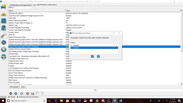

Update: I went back and looked at everything, tested everything and all of my changes are working as expected, except the Daytime running lights. At first, I thought they were working, but today is a sunny day and they do not come on even though they are Enabled. I tried reprogramming it by first turning the light switch off (I leave on Auto). Connected and disabled the Daytime running lights using the bcm menu. After Writing and disconnecting, turning everything off. I then connected and changed the Daytime lights to Enable, write and disconnected. The daytime running lights remain off with the light switch in the Off position or in the Auto position. of course they turn on if I put the light switch to Parking lights. I'm not sure why, but the double honk, Raptor for the Sync screen, 3 doo doo doo and Bambi all work as expected. I don't understand why the change for the daytime running lights doesn't work on my truck.
I also found the setting in the BCM for the Remote Start Parking lights. Somehow it got disabled. After I enabled it, they come now when I remote start just like before. Weird how they got disabled??
Any ideas or suggestions on how to get the Daytime running lights working? I would try changing via hex if I knew t he module numbers.

@gfitzge2 I must have screwed up when I did this. So I really goofed and forgot to do the Backup before making changes. As mentioned above, the Ford VIN report doesn't list everything.
Can you please open ForScan and look up the Daytime running lights module and take a screenshot of the settings? I would like to compare yours with mine.
update: I just realized that using the ui to change things does't tell you the hex numbers for the Daytime running lights, so not sure which line is for that. Maybe if we can figure that out, we can add it to page one so people can change manually via hex.
This is the screen I used to make my change. I took this screen shot when i did it. I may not get to hook up today but I will when I can. As you probably already know I think the settings are in the 726-26 and 726-45 and 726-50 range. I will try to get these settings when I hook up. You may already know this but remember that the truck must be in gear fr the DRLs to work.
NO! I didn't know that, holly cow. Thank you very much sir! This made my day :)
I just checked and they are working as expected. I was testing this in my driveway so I never put in Drive. To add to it, the installment panel does not show the "lights on" icon so I also thought it wasn't working. The "lights on" icon does illuminates when you turn on the lights with switch (other than Auto in the daytime). I had to put it in gear with the parking brake set, then get out and go look. All good to go now, and it was likely working from the first attempt. Same as you, It's cool having these lights on, as this means my raptor grill lights are always on. :)

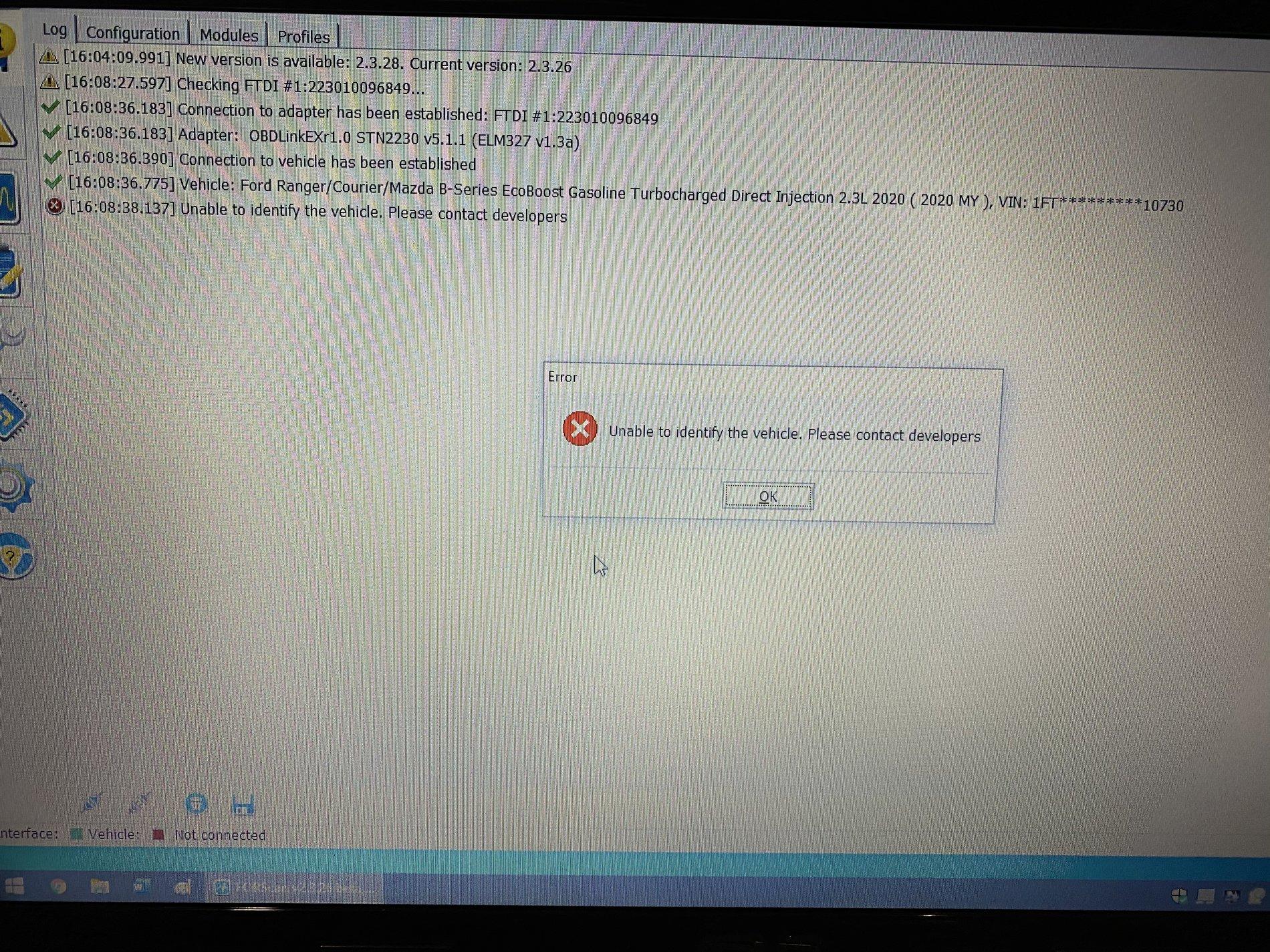

Having issues connecting with my 2020 using ELM and now bought the FORDSCAN approved and same issue.
Anyone else experienced this?
What is the error/issue you are seeing?
Nutty 5.0
