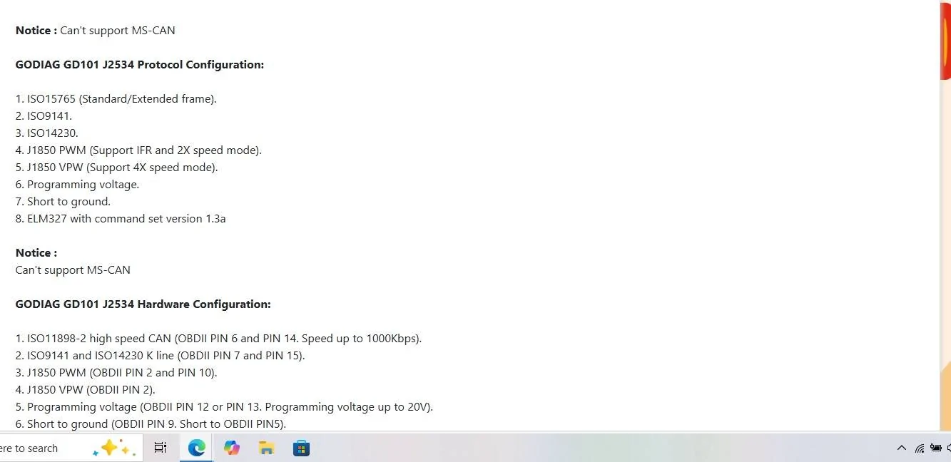

See the NOTE - Can't Support MS-CAN
Plus, I highly doubt a cheap cable will ever support J-2534 Passthrough
If you want J-2534 Pass Through and need it to communicate with a Ford Product no cheap cable available will ever let you do it.
It MUST be on a set of approved cables listed by Ford and the cheapest available that will work is the Mongoose Plus

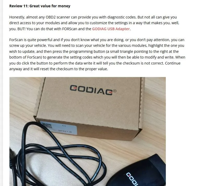

Have you tried this: From a Review of the Cable

Tried that, as well as updating from GUI mode, neither helped. Forscan just requested debug info, haven't heard back from the cable manufacturer yet. I'll update again once I have more info. Thanks everyone!

No - In fact it will not support MS-CAN, that's the issue, it is marketed as a J2534 Pass Through (Cheaply) but I believe if this cable is truly used on a Ford Product as J5234 Programming (Actual Programming) the Ford Servers (Software Authorization) Handshake, it will not allow the connection.
Even if you get the connection, it will be slow & buggy and risk bricking the module.
There is not a cheap (option) option available that Ford Will allow unless you spend the $575 for the Mongoose Cable.

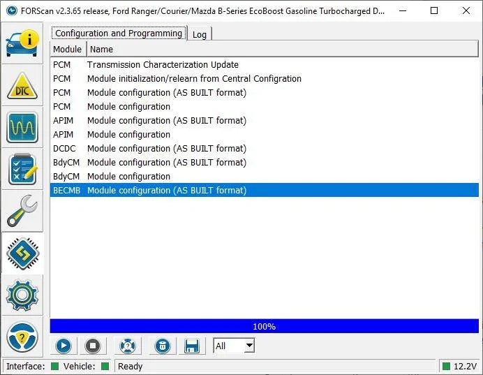

Update - And I'm going to try to make it keyword-rich so anyone else searching about this cable can learn from my pain. ?
I was able to get Forscan to connect with my Godiag GD101 cable and resolve my "service procedure was interrupted" error, and I was able to write changes to the vehicle successfully. I was initially able to read OK but got the error when attempting to write. I was further confused because I had downloaded Godiag's utility and it showed no errors or connectivity issues.
I had emailed Forscan, and they said the cable was incompatible due to poor implementation of ELM327. Godiag has not yet responded to me, but it's less than 24 hours at this point so I can't ding them.
Turns out that the cable needed a firmware update, which was done through Godiag's utility. Please note that this had to be downloaded from their website and was not included in the package. After running the firmware update, the cable connected successfully via J2534 and was able to write changes. I did not make another attempt at connecting via ELM327 since there's no need to deal with the slowness.
So now I'm a happy camper. Although this was a little more of a PITA than it was worth and you're still better off sticking with one of the recommended cables. Please note that I'm only using J2534 for changing settings listed in this thread, I'm not trying to do anything more advanced that may brick the vehicle and don't recommend that.
Now on to the next step... I'm trying to disable the seat belt reminder chimes, which the first post in this thread says is in the IPC. See the screenshot below, I don't have an IPC? Mine is an XL with STX, so I have the cheapie cluster. I don't see anything pertaining to belts in the BCM, anywhere else I should look?
Thanks everyone for your help!

You are still not getting (MS-CAN) network modules to load and also missing most of the modules on the (HS-CAN) network
You can try - Creating a (NEW) profile, this will force a new scan for modules on the network, if it still comes up with the same list of modules then as I stated - You need the proper cable
as the description of the cable states - DOES NOT SUPPORT (MS-CAN)
I think you are fighting a losing battle with this cable
