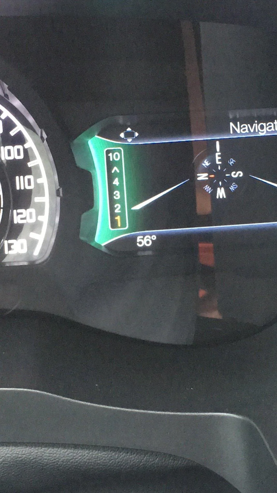

Is anyone aware of a ForScan modification to keep the active gear screen up between all ignition cycles? I’m use to pressing the + button about 90% of the time, but I noticed my friends 2014 F150 3.5L always has it up. Maybe there’s a way to mimic the F150 code?
RCMUSTANG
Ray
Jan 22, 2019
1,867
2,192
Los Angeles
2017 Fusion 1995 Ranger
As stated before that's only through the pcm and a tuner. No one has unlocked that yet. I've been requesting since before I got the truck.
