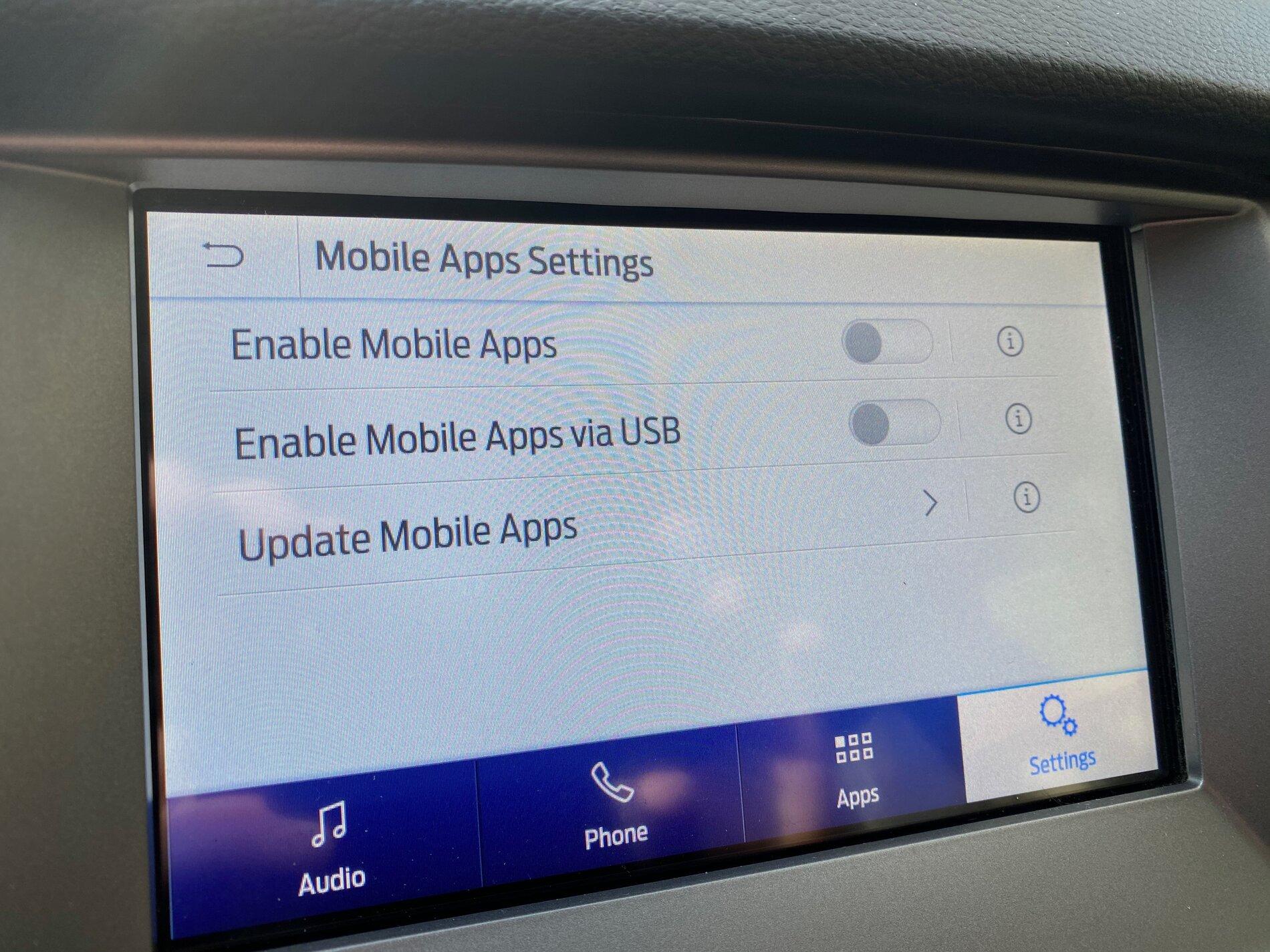

It might be a little early, but I think I may have identified the problem and a workaround.
Others have mentioned that the battery drain only happens after connecting via USB or Bluetooth, and I've had the same experience.
I've uninstalled the app, re-installed and everything is fine.
Until... I have to drive somewhere when I usually plug-in to use CarPlay.
So this connection related trigger got me thinking.
I remember that the SYNC head unit has "built-in" apps which I never use.
I only use the apps natively on my iPhone, thru carplay.
So I dug into the SYNC settings on the head unit and turned off these options.
See the screenshot below.
My theory is. that these settings allow the built-in SYNC apps to use my phone's data connection over USB or Bluetooth THROUGH the Ford Pass app.
I turned them off.
Took an hour round trip drive last night, and another short trip this morning.
So far the battery usage on the phone shows a relatively normal 10% reading for the FordPass app.
I'm thinking that the SYNC apps use data THROUGH the FordPass app on your phone in the background and that activity is never severed when you disconnect, causing the battery drain.
We'll see if the phone's battery drain returns, but I thought I'd share my short experiment so far.
-Todd

I’m going to try it. Annoying problem.

The problem is a bug in iOS 14 in the code that handles external accessories. When a supported external accessory is connected iOS recognises it and tries to launch the matching app.
Turning off the mobile apps is a good idea and a potential work around since it should stop the car from triggering this code in the phone.

So far disabling the apps has worked. Thanks ToddlerCO.
After several days still fine. ToddlerCO nailed it. Thanks again.

Thanks for the update on this. I was wondering why my iPhone battery was running down so quickly AND heating up. I have corrected the issue now...
