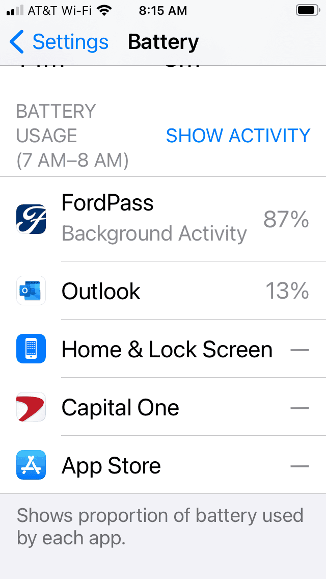

Lots of reviews in the Apple store about this topic. Despite disabling the app from all services, it continues to drain my battery. I've gone from a full charge to about 25% in a matter of two hours. And FordPass accounts for almost 90% of all of that - shown as 'background activity'. I'm at the latest of both iOS and FordPass. I'll just have to delete until it's fixed. This is a screen shot from this morning.

Do you have the option for FordPass to track your Motion and Fitness turned on? You can check it under settings, then scroll down to where all the apps are listed and select FordPass. If it is on, try turning it off to see if it makes a difference.
I have everything turned off.
