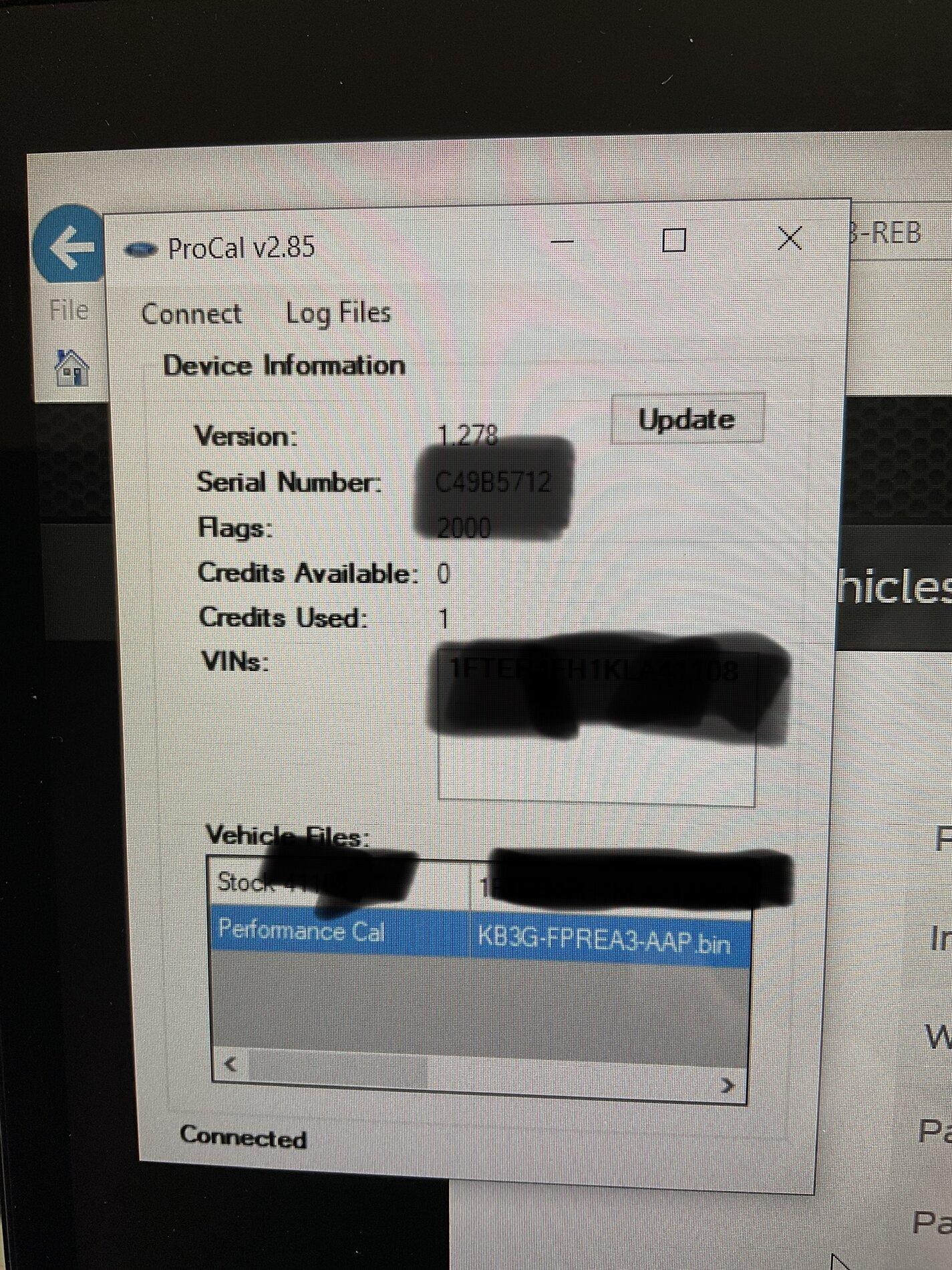

I just updated to the new Performance software, I did not go back to stock and then to the new software.
I wish there were detailed steps as I’m not sure if you need to reset anything to trigger the relearn
Rp930

Do you know the version of the file. File name
I did not have to “reset” anything. Once you have the new file connect it to the truck and select the performance tune just like the first time.
Strange, we have the same pro cal version and software version my perf Cal bin file is named entirely different. FPP rep replied back but did not back up his findings with a version number. I will try calling again before I upgrade it. Ill update the thread with my findings.
I think the AAP.bin is the new file.

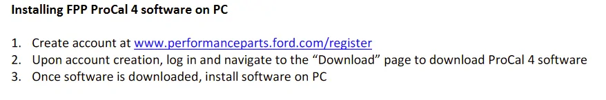

So I updated my ProCal desktop app as prompted and when I plugged my ProCal 4 unit in, it won't connect due to some Windows error. Any ideas?
LoneRNGR
May 8, 2020
470
862
Lubbock, Texas
2020 Ford Ranger XLT
Systems Engineer
The desktop app may have updated the driver for the ProCal 4 unit, but didn't prompt you for a reboot. Also, I remember mine triggering a .NET update after I installed the desktop app update. You might need to check for a .NET update or reboot so that .NET finishes installing. Windows :explode:
I had two updates recently, and on the first one, Windows Defender said it was a virus.
Disabled Defender and tried again.
Then, several days later, another update came along, and this one went right through.
You might try uninstalling the app and download the newest version?
