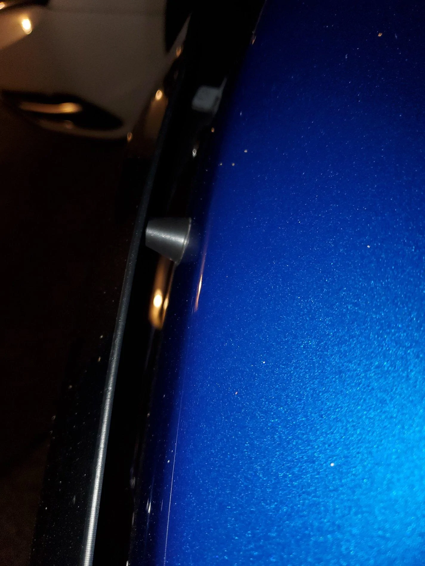

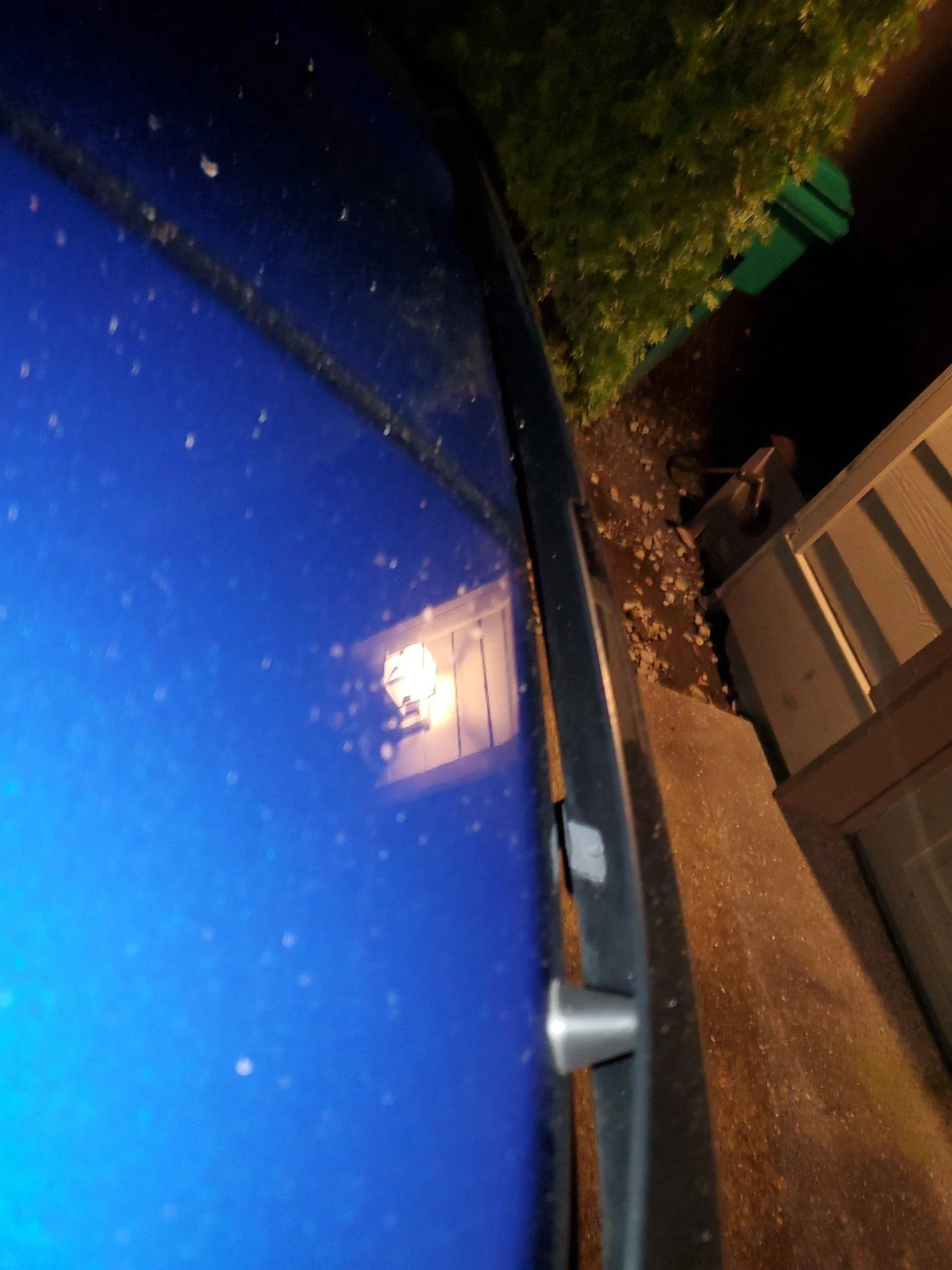

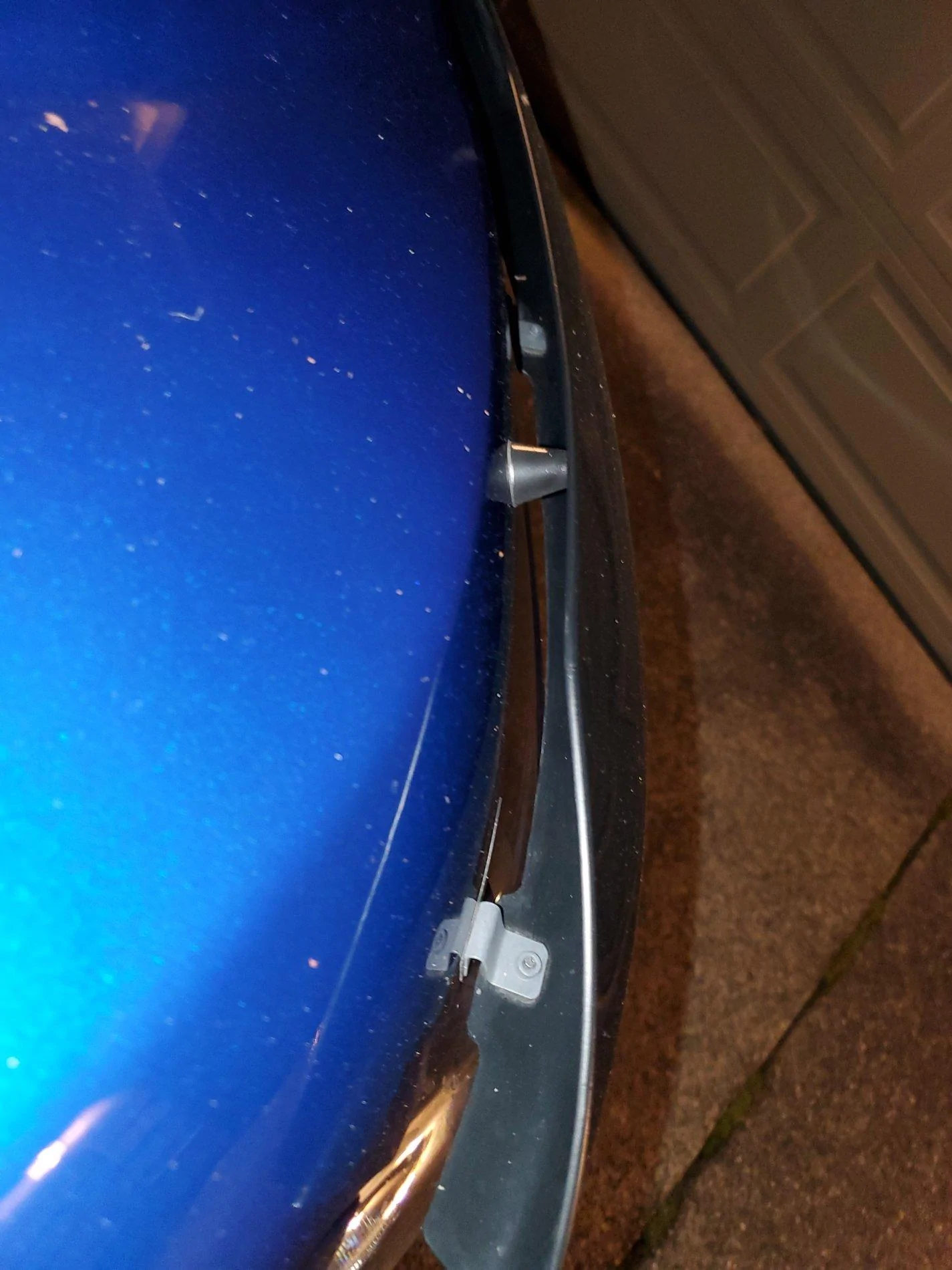

Took these for you. Not the best pics since it's dark out.

No problem! Glad to help or at least get you pointed in the right direction. I'm betting that's your issue without the back support on the top edge. Since the cones are installed wrong and not touching, its causing the deflector edge to vibrate and whistle at higher speeds.

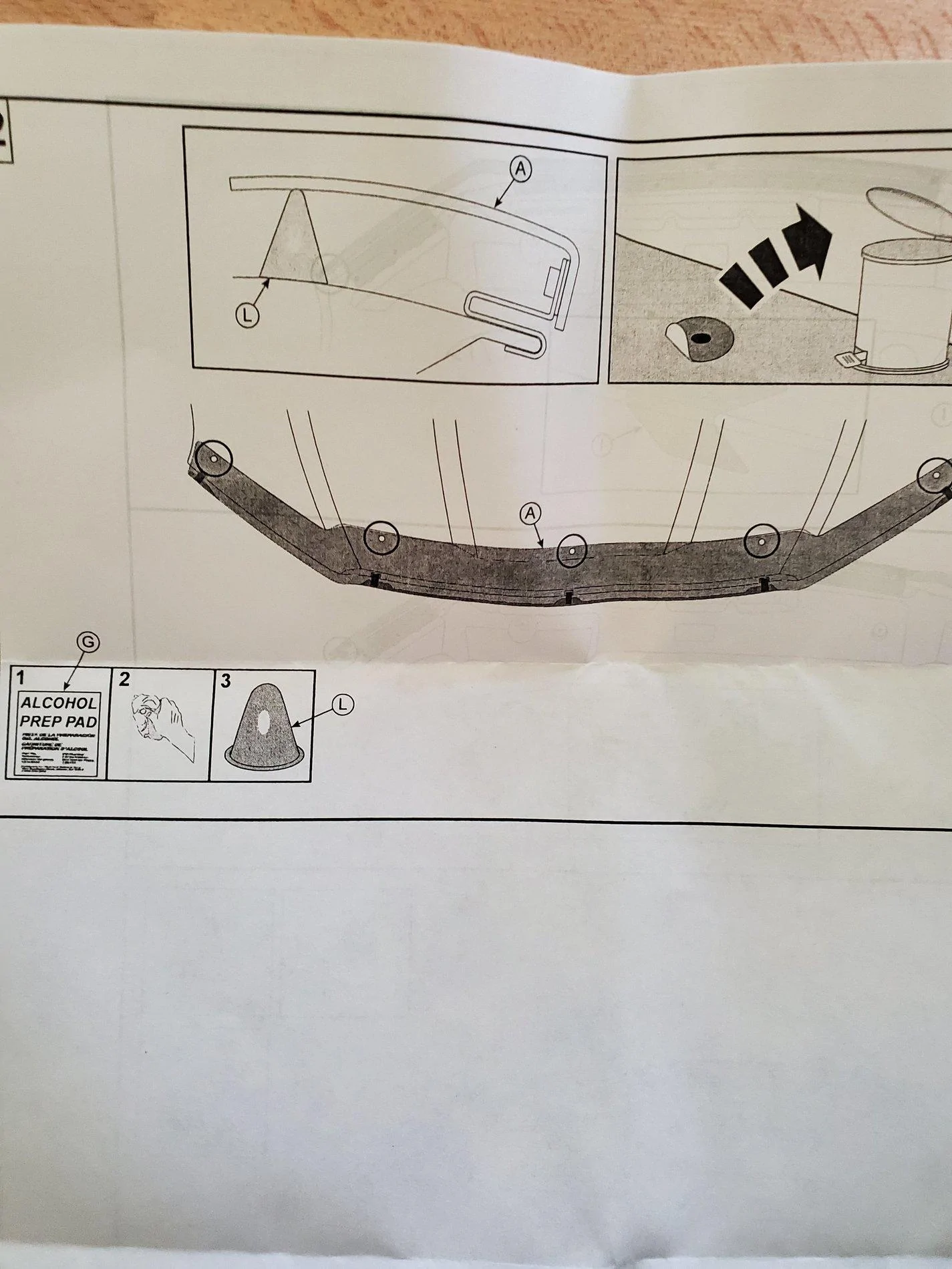

Still disagree with them on their install procedure. With the cones backwards and not touching that could definitely cause your whistle.....Ford disagrees as well. Not that it does you any good now but here is a pic I just took from the instructions for future owners.

Putting the cone on the deflector means it'll rub a spot in the paint on your truck. That's the reason the instruction show the cone stuck on the truck.
