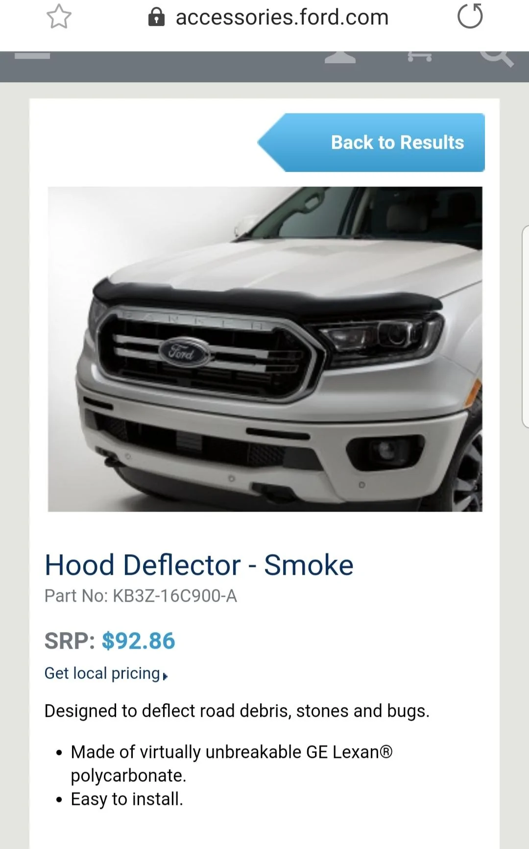

I am not near my truck to take a photo of my exact setup but I attached a photo of the bug deflector I'm having trouble with. Bending the clips in did not work. Still a high pitch sound but now even at lower speeds. I will have to try the rag idea.

Why does the edges of the deflector look like it overlaps the fender and not stuck onto he hood. Is it really like that?

The OEM deflector is the style that uses stand off clips vs a 3M application, so it does not sit flush on the hood.
To the OP, I have this same one and have had it on since August. I wonder what is up with yours, did you install the rubber support cones? Mine has been rock solid and no vibrations or whistles. I am mainly doing 'burb runs but I have taken her on a couple 6hr round trips and no issues.

Ford used clips to install it and there are black, rubber cones on the back of the deflector that are barely touching my hood. They are hopefully going to replace it this week so fingers crossed on the new one. Glad to hear none of you are having problems!!

I wonder if that's your issue. The cones are attached to the hood with the pointed end facing the deflector. Those act as "supports" (in addition to the clips) and keeps it from vibrating. They go in specific places on the hood. The deflector itself has these marked via stickers when you install so you see exactly where to place them. The rubber pointed side should be touching the deflector.
Sounds like the tech installed it incorrectly.
