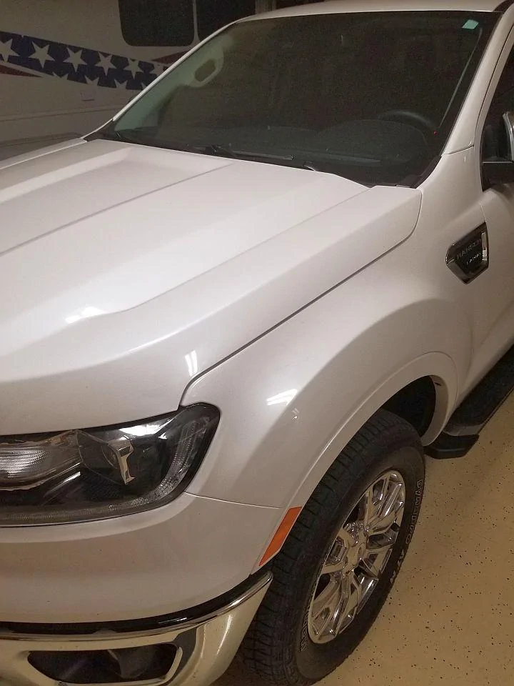

I just noticed driver side of my hood has a slight overlap that wasn't there earlier or at least I didn't see it. Could be from opening and slamming the door shut. So along with the tailgate with a bigger gap on the passenger side, the hood is a problem.
I'll have the dealer serviceddepartment look at my next service.
It is fixable.

It is fixable.
My issue isn't quite as bad but it's there and I guess they'll send it to a body shop to do the repair if they can't . Yours came out great which is nice to know.

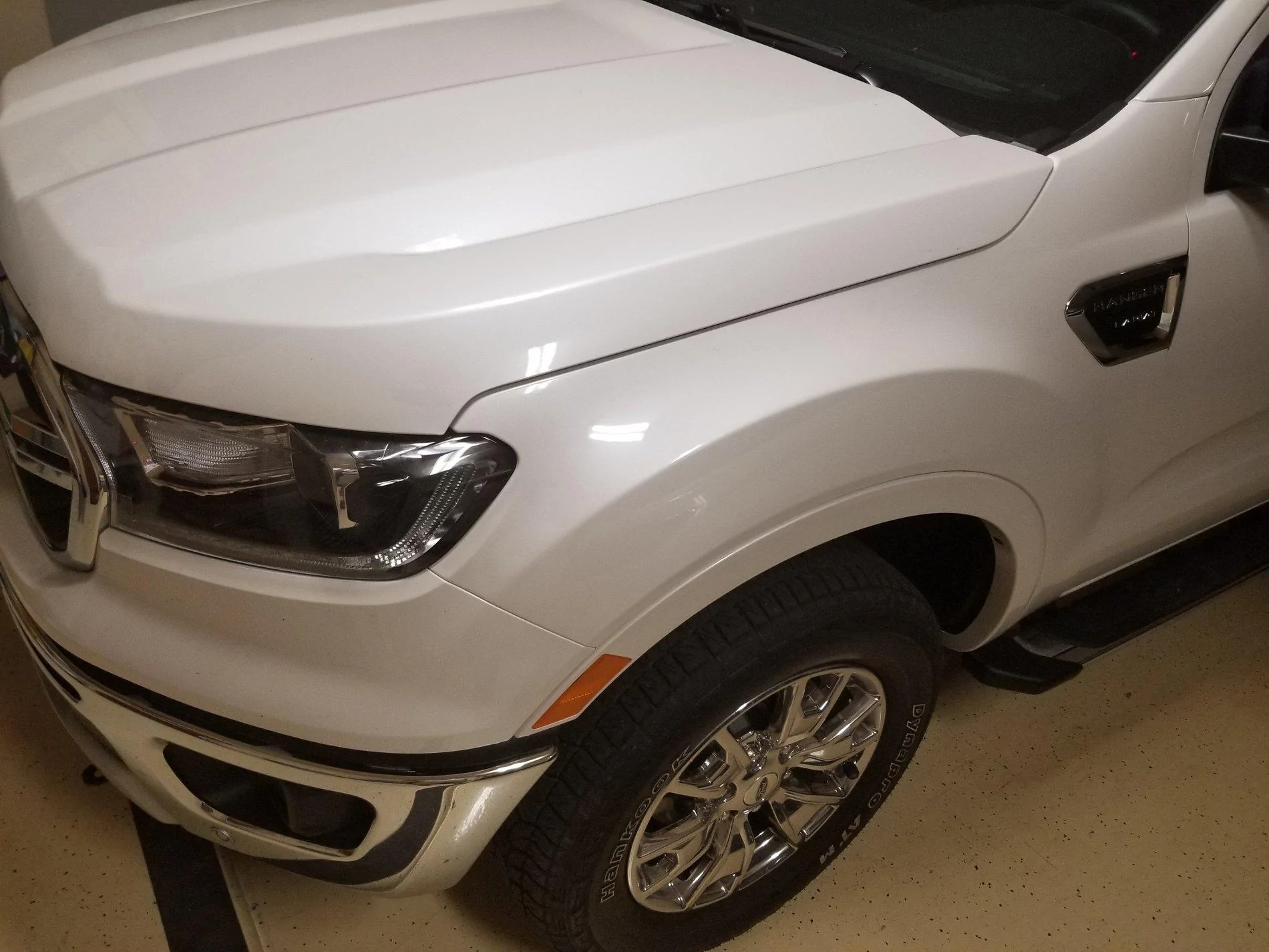

Hi Folks,
After seeing results of these tweaks to the front fenders, I decided to see if I could improve the fit of the hood. Much to my amazement the tweak of about 1/8" on the left and a 1/16" produced a flush to fender for the edge of the hood... My concern about fitment around the headlight was a non issue. Happy camper... photograph might not show the improvement but I am pleased with the fine tuning for hood fitment.
Michigan Truck Plant needs to raise the chinning bar a bit...They need to adjust their fixtures under the No Adjust Build process..can't believe their audit process has not led to refinement of the hood fit.

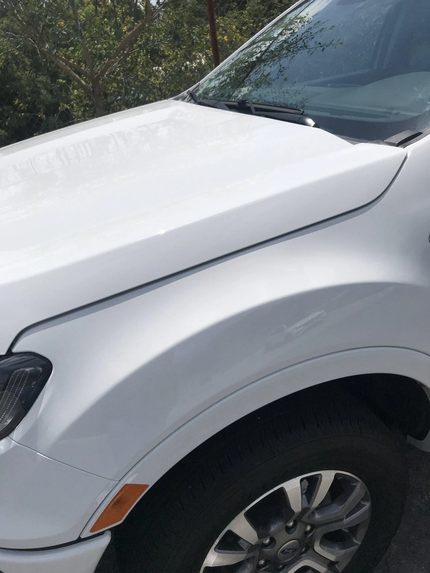

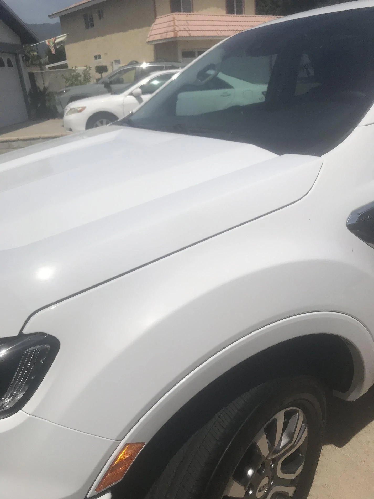

My buddy who can fix anything could not live with my hood being off. He popped the hood and repositioned the fenders. They had to be pulled out 1/4 on the driver’s side and an 1/8 of an inch on the passenger’s side. The first picture is before and the second is after the fix. The third picture shows the fender bolt after the1/8 inch adjustment.
Mine was the same, 10 min and a 10mm ratchet fixed it
