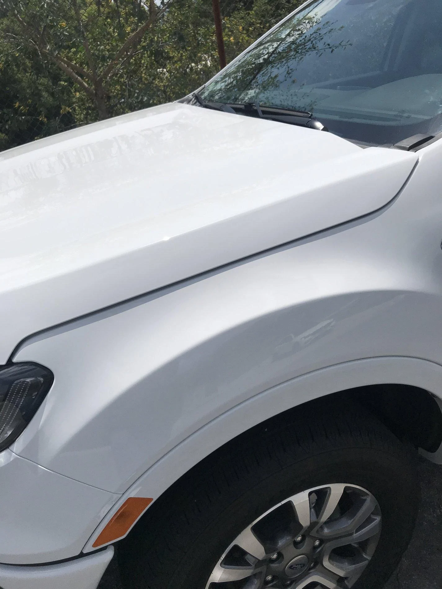

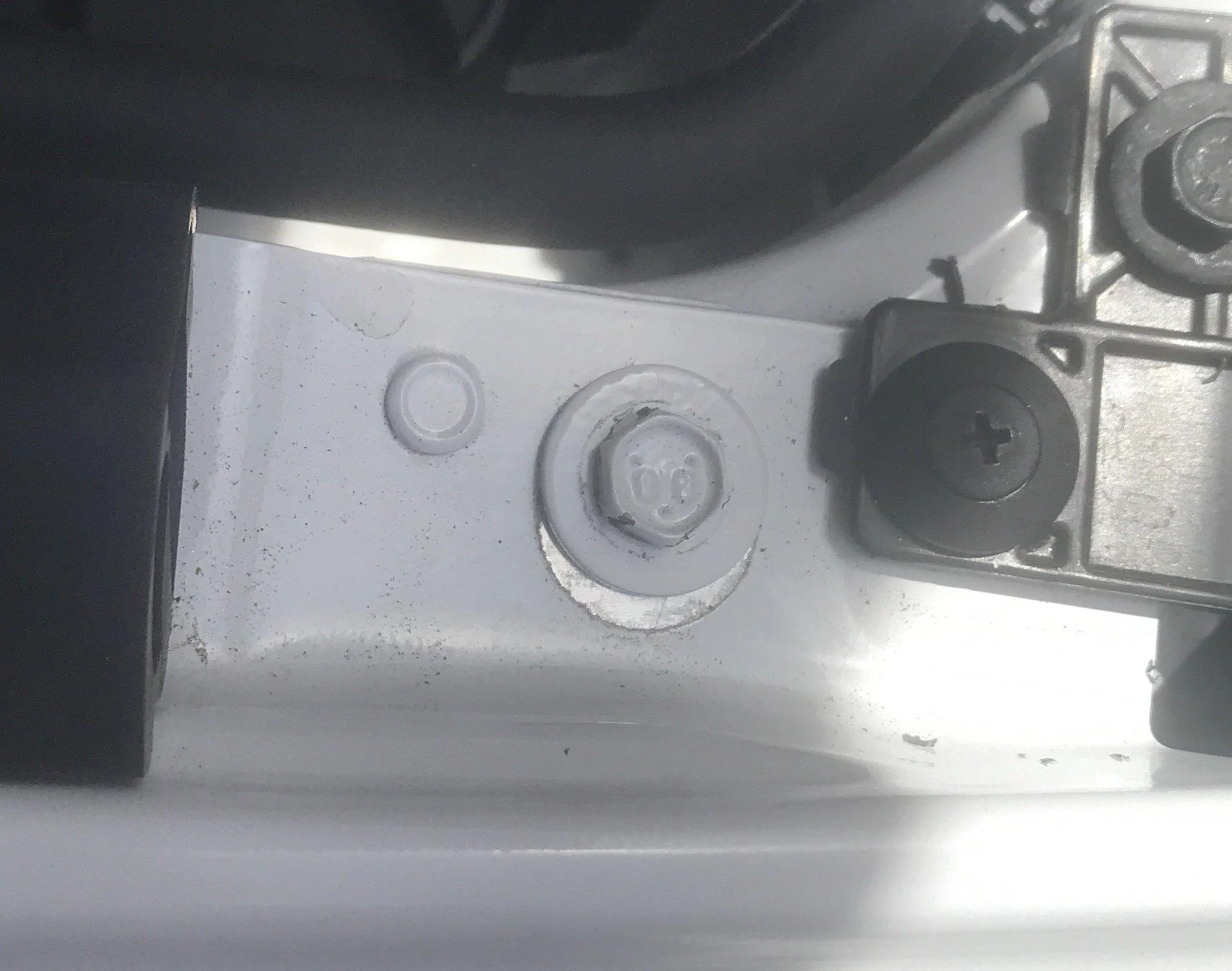

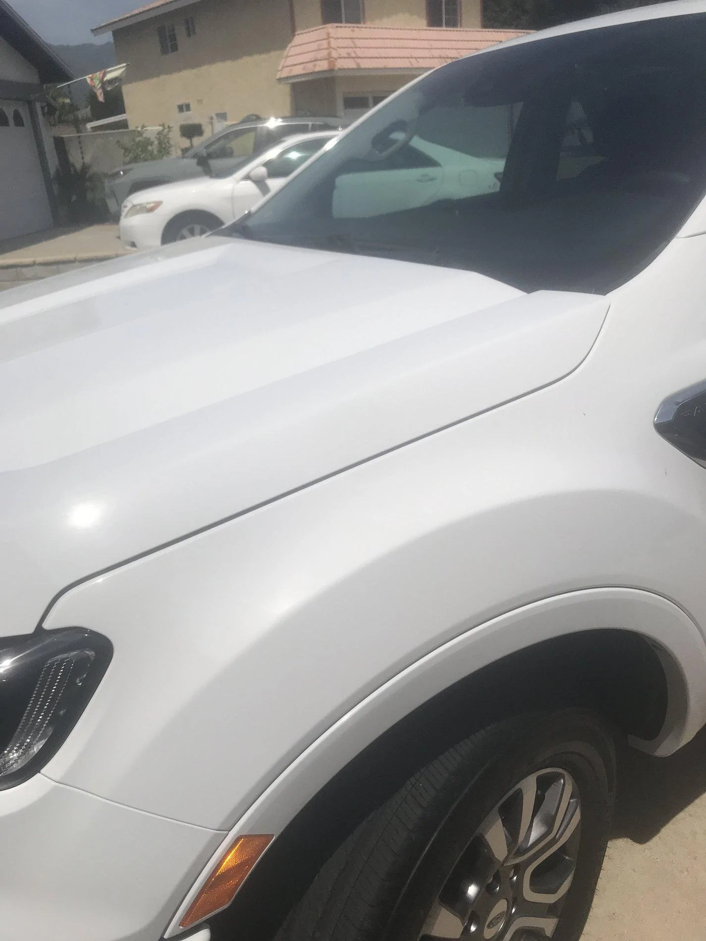

My buddy who can fix anything could not live with my hood being off. He popped the hood and repositioned the fenders. They had to be pulled out 1/4 on the driver’s side and an 1/8 of an inch on the passenger’s side. The first picture is before and the second is after the fix. The third picture shows the fender bolt after the1/8 inch adjustment.
Nice!
Hey Subvet!
Your issue can be fixed.

Dang, Ric. I don't see how that hood line passed a quality inspection at the assembly plant. Or even at the dealer when they did a PDI once over to check it in. I realize they may have been scrambling to put out trucks to keep up with demand but that is not right. :crazy:
Thing is, I had a long check list when I took delivery of my Ranger. The two items I did not pick up on were the bad injector, (I thought the hesitation was normal), and the bad hood fit. Luckily, both were fixed at no cost to me.
