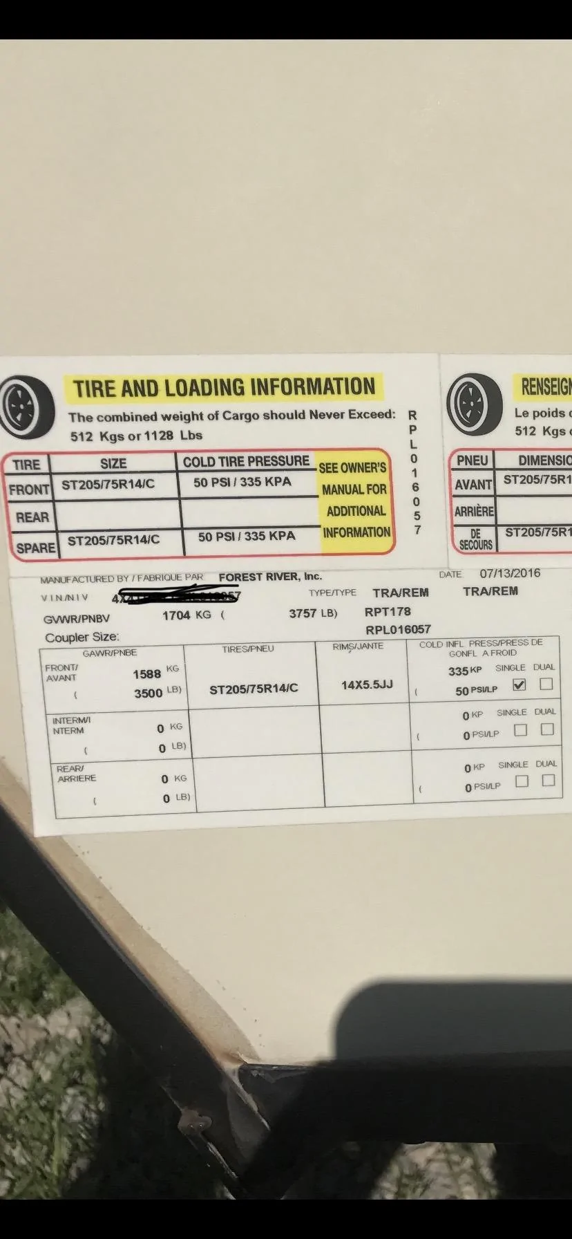

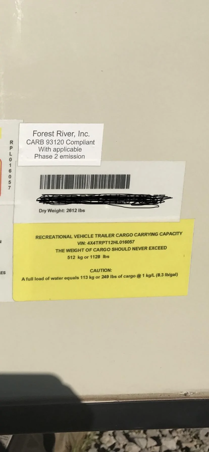

Like everyone said, you don’t want to be at max tow , you want to leave yourself a comfort zone . He is my trailer #s
