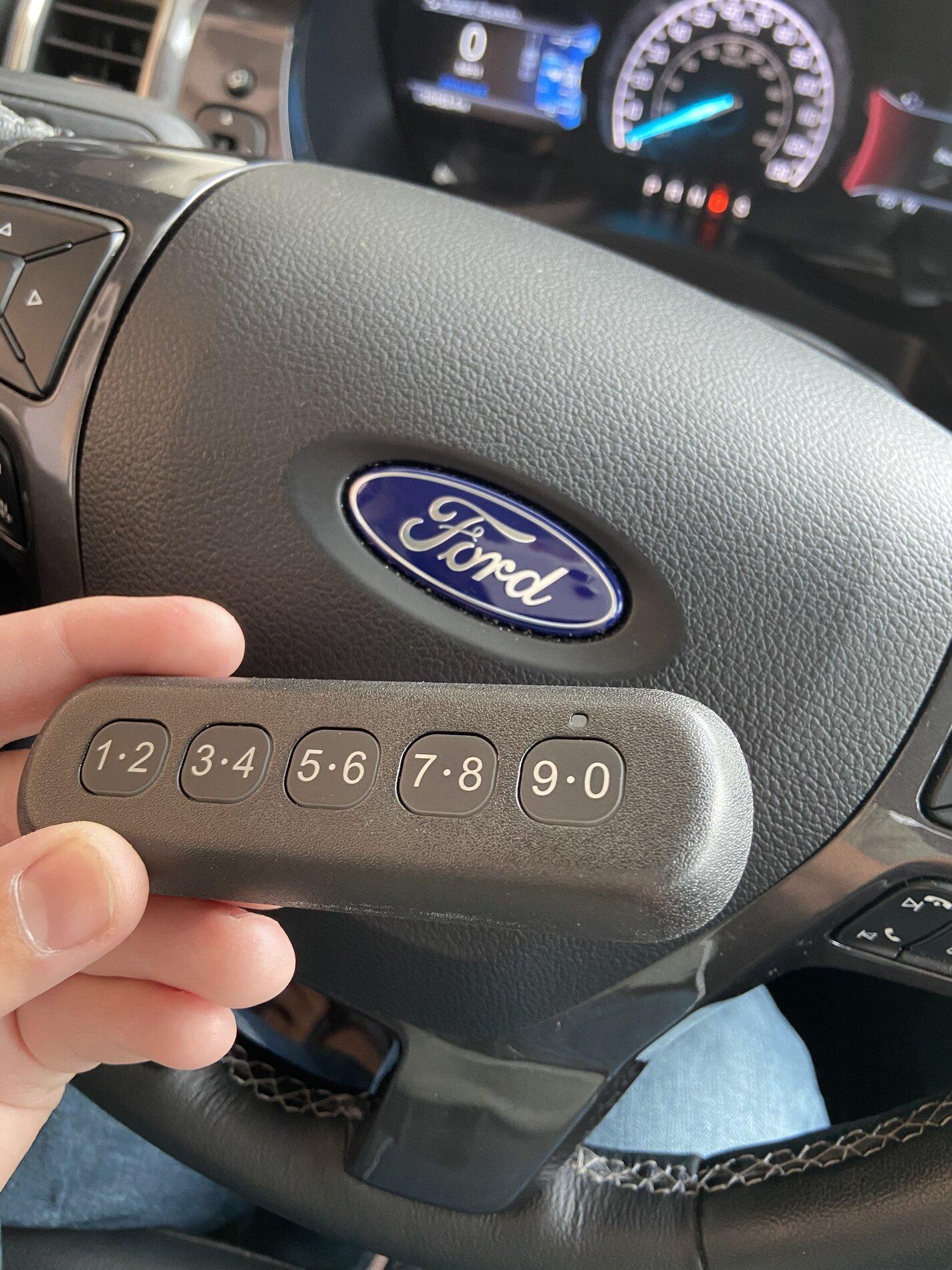

I'm in the same boat! I bought it certified pre-owned but both the original factory papers and the dealer's window sticker had the keypad listed. My local dealership has ordered a new one for me and now I'm just waiting for it to come in. I did have them remove it, so it's just sitting in the cupholder until the new one arrives. It is in fact battery operated as some have questioned on this topic. Very clean removal when it comes off and no damage to the paint or finish.

  • Have them look up Special Service Msg # 48026. That outlines the issue.
  • The part number etched on the keypad itself is not listed in Ford's warranty parts system. There's a different part number (Don't know what it is myself) they have to look up to get the part ordered under warranty.
