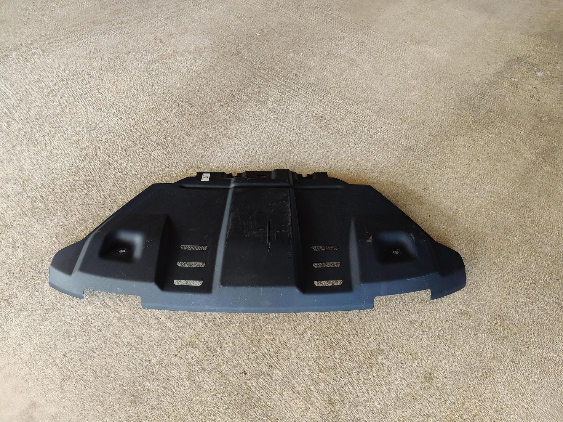

Do they sell the lower plastic as well to match the skid plate ? and if you have a part number can you please post it.
There's a thread with the part numbers, They do sell the plastic, but it's pricey. For the cost you could easily get a set of skid plates from 589Fab before you're done with shipping nonsense and 40$ bolts from Ford.

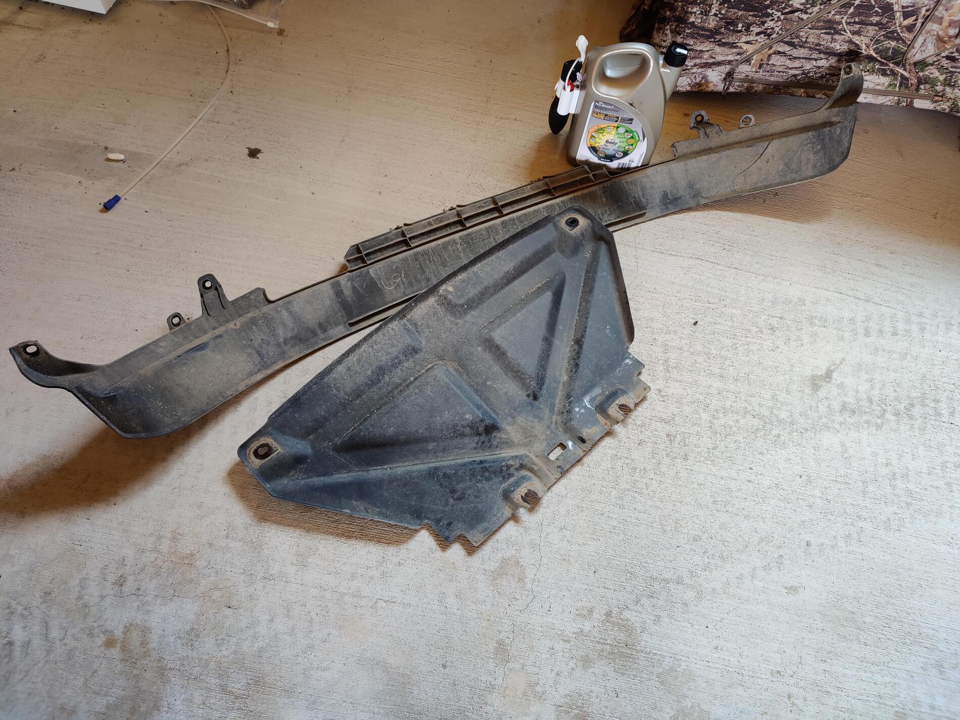

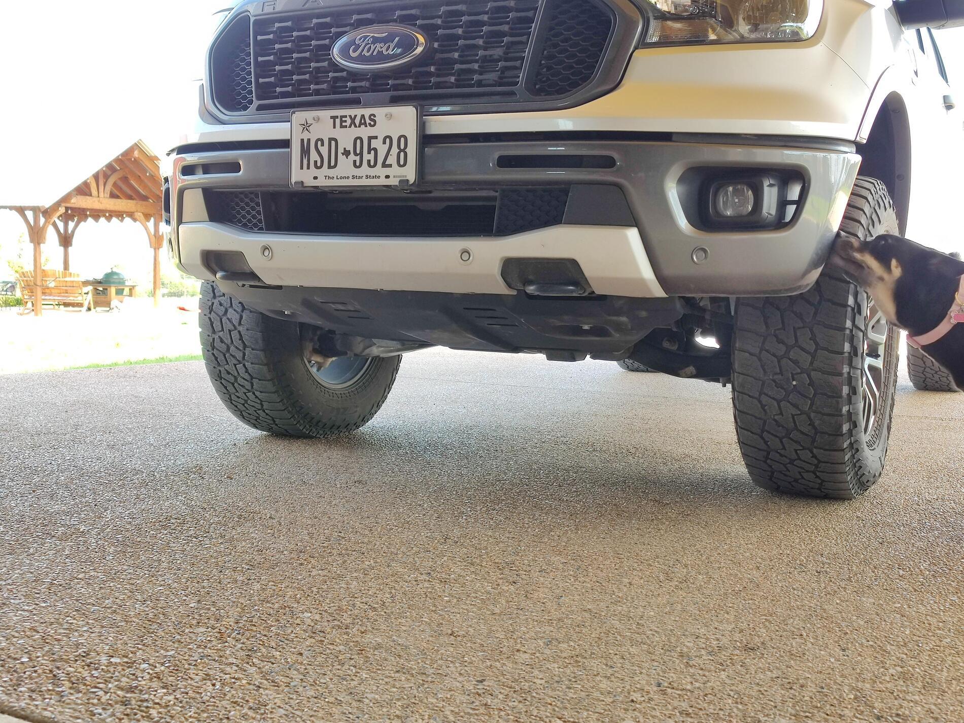

Finally got around to doing this today! I was always a bit concerned doing off-road things with the tiny non-fx4 skid. Swap took about 20 minutes after locating all the bolts to remove the air dam. I ended up with a factory black skid plate that I'm liking more than I figured I would.

Looks good.
Would be even better with a black valence.

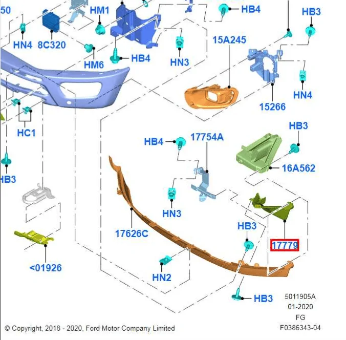

Yes here are the part numbers.
KB3Z-17779-A
KB3Z-17778-A
KB3Z-17C887-A
KB3Z-17C886-A
W705958-S439 x2
W717403-S442 x2
W505142-S442 x6
You can see here how the bracket 17754A is required to support this
