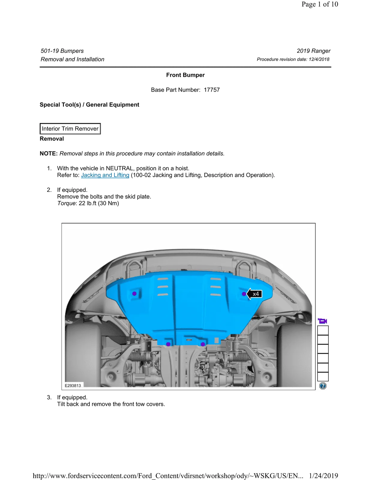

that should give an idea of coverage. i would not call it thick but its satisfactory for most average users. i have a ding or three in mine from a nose bounce i wasnt expecting but no damage any place so the plate did its job just fine.
