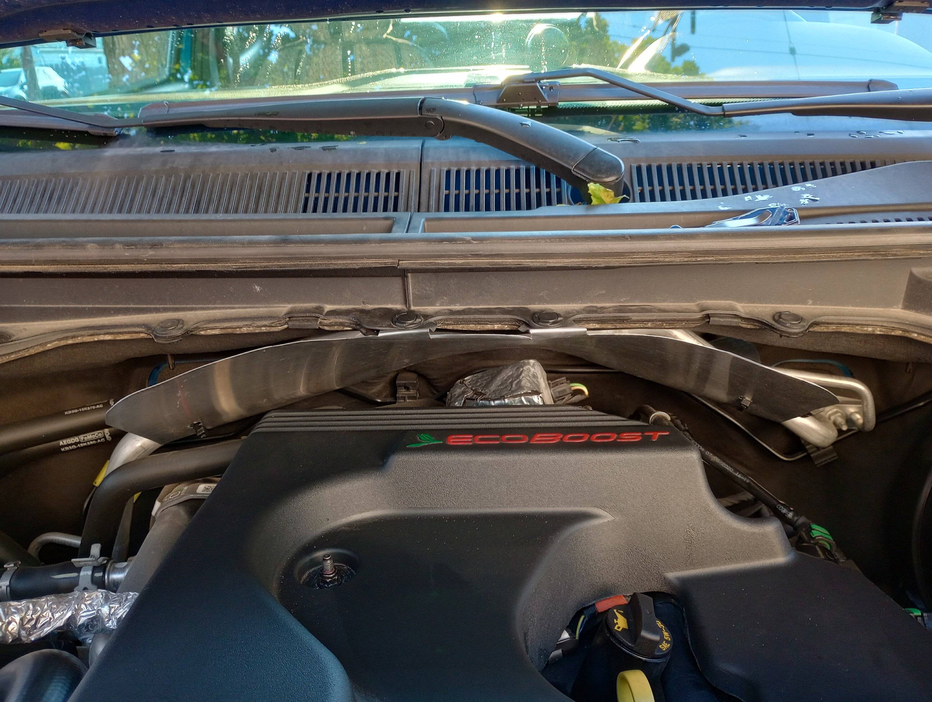

Yesterday after I washed my truck I looked under the hood to see if the engine cover was wet. There was a few drops on the back side of it but most of the water dripped down the back onto the #4 coil. I took the cover off and there was enough water around the coil to saturate the paper towel I stuffed around it. I rigged up a splash guard from aluminum flashing that deflects the water behind the engine. The next time it's nice out I'm going to pull the #4 coil and see what's down there.

People that park outside are going to have the biggest issues down the road , drip drip drip on a cold engine , then short trips that don't get it hot enough to evaporate, then wash it , drip drip drip, snow... lots of seized plug issues down the road methinks...

Thanks for posting about this water "leak". A paper towel's worth is a decent amount.

Hmm, something to think about and especially in New England when it'll stay cold enough to thaw the water but not always evaporate it (2 minute trip to the store and 6 minute trip to the dump).
