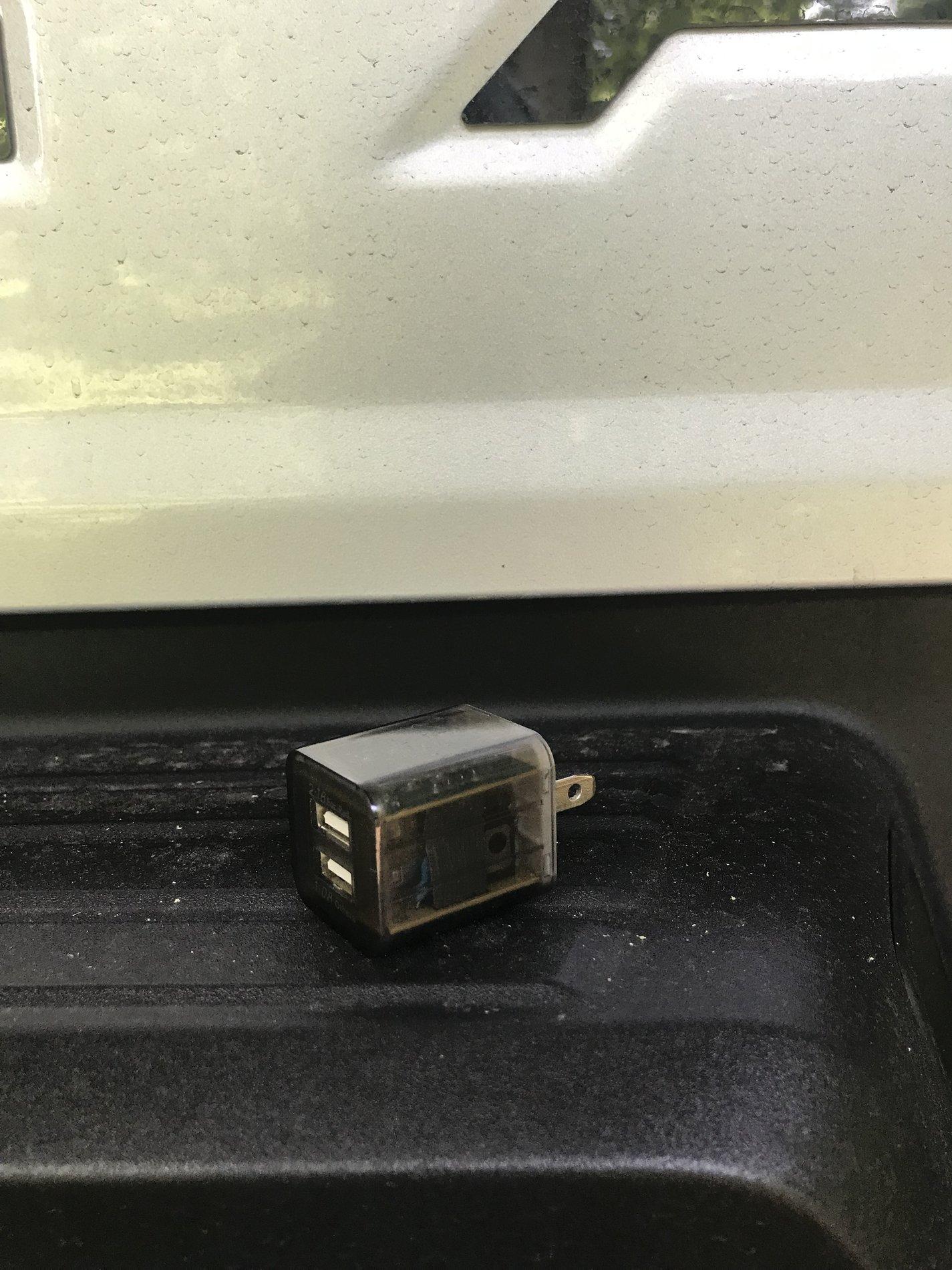

I had this simple usb charger that lights up when plugged in.
Fixed the auto-start function. :clap:
Any USB 110v charger will work if you don’t care for the lights.

No idea where I picked that one up at. I thought the lights were the key too but a regular usb charger will work.
Or a night light.

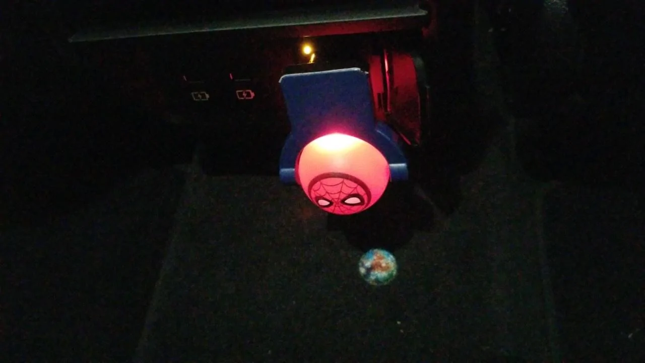

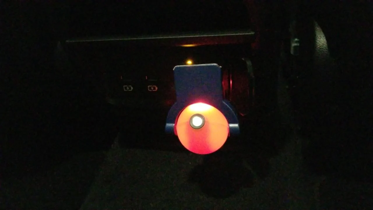

I just plugged a small night light in and it did the trick. can put different colored bulbs in , can turn the bulb cover over bulbs and never know its back there.

So, from my experience, the LED USB charger and LED nightlight did not work. I got mine to work with an incandescent night light, BUT I will need to grind down the larger of the 2 plug blades so it can be fully plugged in and not resting on the plastic above the outlet. The LED options looked good, but never worked, once I drove the truck.

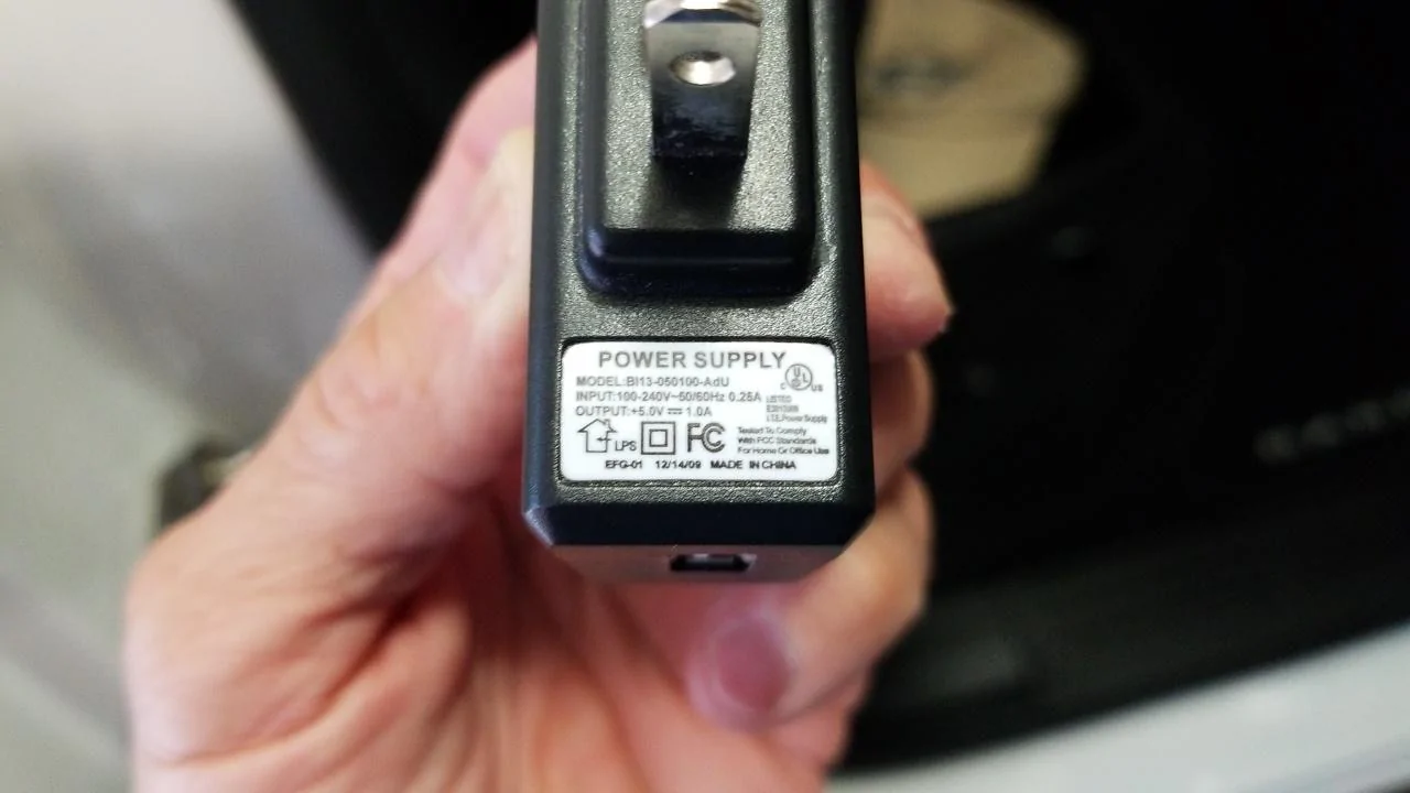

I actually found a USB wall unit with a small led and that worked so even better, helps to poke around in the drawer o stuff lol
