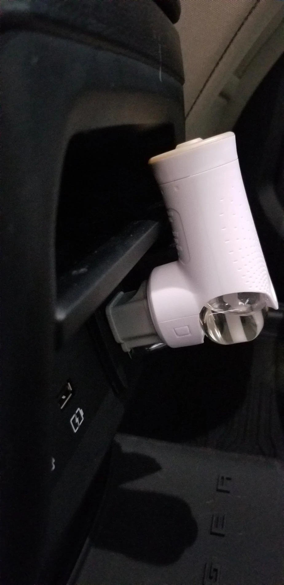

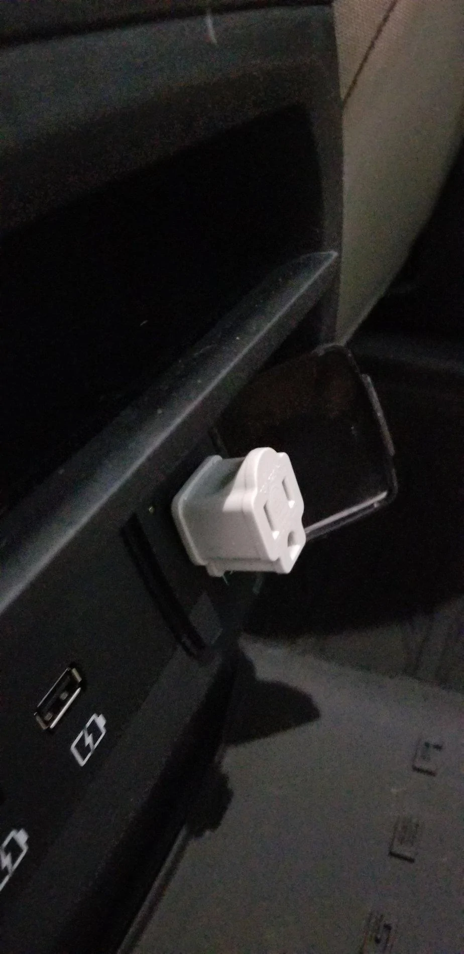

In a very short test trip (AC off & only 4 stops) it appears to work with a glade plugin. Needed a plug extension to clear console lip. Can ditch the tree hanging from rearview mirror:giggle:
2 weeks and ~800 miles and no autostop. I vote for this solution as CONFIRMED!

Ooh, I like the Glade air freshener fix. A good fix for when the new truck smell fades away.
Personally I don’t mind the stop start tech, it operates smoother that my sons BMW. Weather it saves gas? I guess it does, I’m doing a comparison now to see for myself.
I’ve got to believe it contributes to more wear and tear.

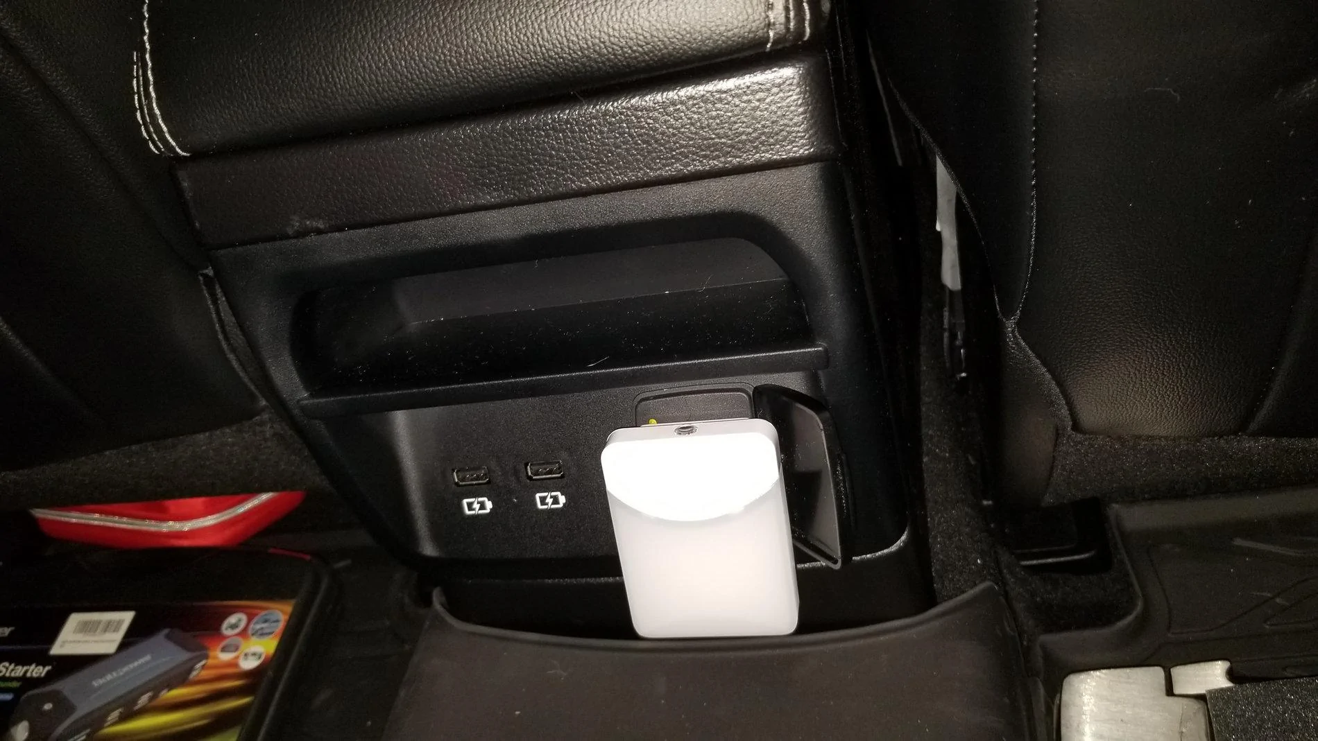

Are you sure? I thought it went off after about 20 mins after the truck was shut off? Mine stays on for a while after I shut the truck off - somewhere I thought I read it was 20 minutes.
I put it in and drove a couple of miles and when I stopped, the engine did not stop. my LED did not stay on when I turn the truck off. However, the 12-volt adapter I have in the front with an LED will stay on but it's an LED So not worried about it using much battery power.

So, from my experience, the LED USB charger and LED nightlight did not work. I got mine to work with an incandescent night light, BUT I will need to grind down the larger of the 2 plug blades so it can be fully plugged in and not resting on the plastic above the outlet. The LED options looked good, but never worked, once I drove the truck.
Interesting. LED works in my truck. It's light sensing as well so not always on.

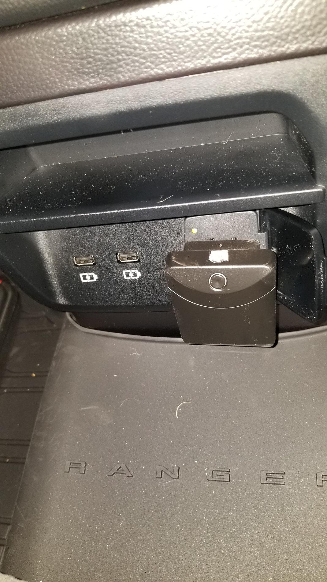

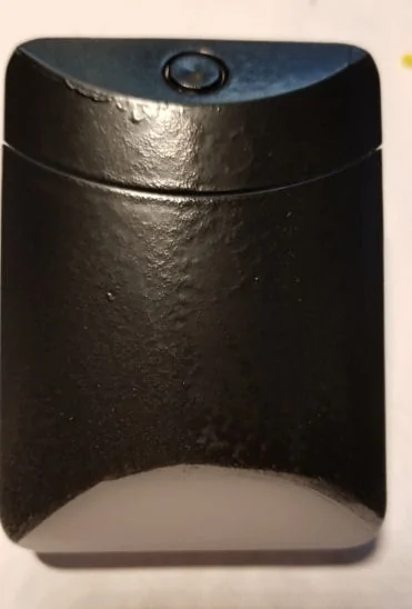

It will turn off itself in daylight. It's not very bright. Will create a nice ambient light for the back seats.
Plugs right in. It just works. If you are concerned about the light, just paint it black. I painted with some plasti dip with a small strip open for color. The white on top is actually a photocell that turns it off with light.
