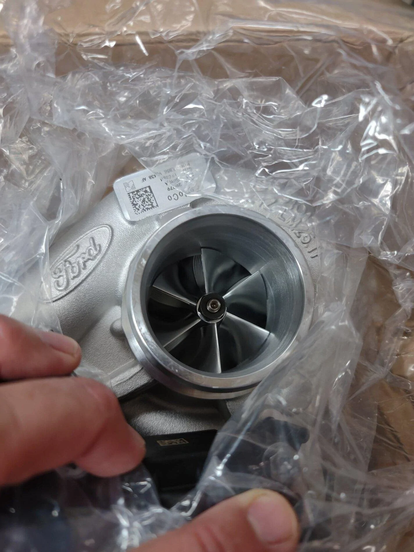

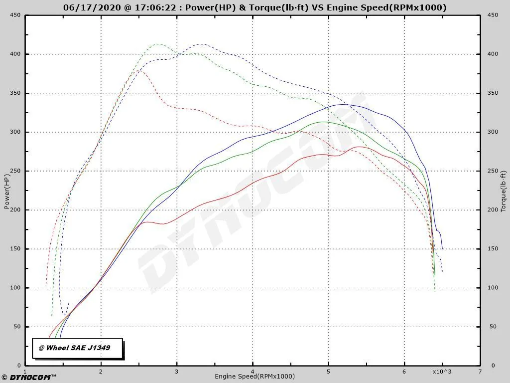

Here's a dyno session of a stock truck with catback exhaust, then tuned, then tuned with the Gearhead prototype turbo upgrade. All runs were on 93 octane. With the stock turbo, optimum shift point for maximum acceleration is 5600 rpms, after turbo upgrade, wot shift points are 6100-6200 rpms depending on gear change. Tuning available on SCT or HPT.

I've been running Matt at Gearheads tune for about a month now and I absolutely love it! The truck drives and shifts better than stock (very smooth) but when you step on it or put it in sport mode.....what a difference! Oh and my MPG went up too!

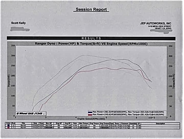

Before and after installation of the FP Tune. Only other engine modification is a Flowmaster 40 Series muffler.

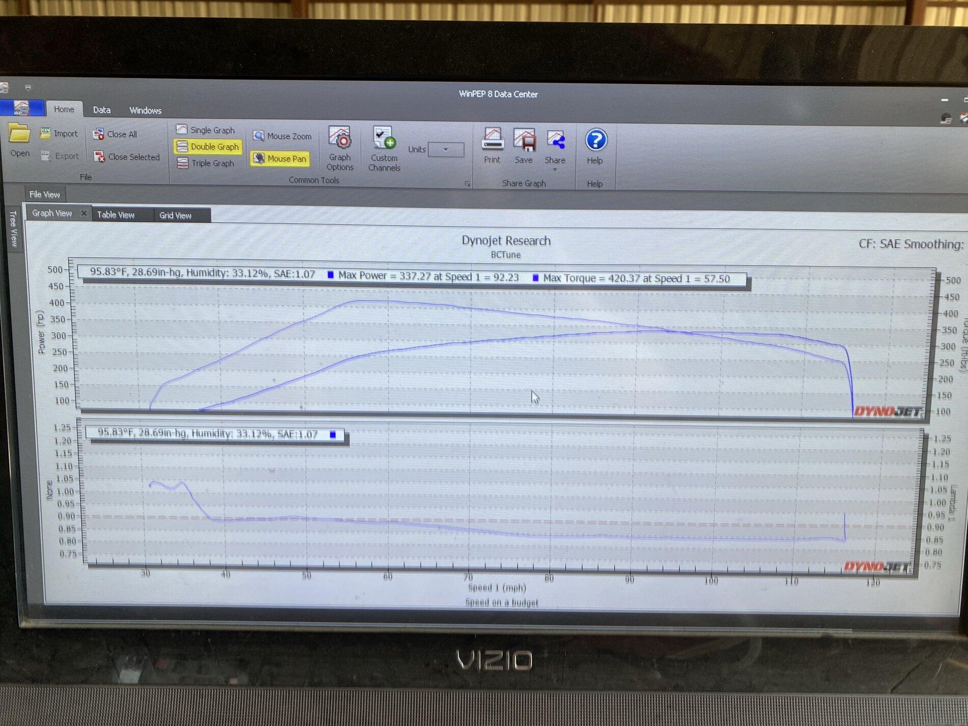

Got the Ranger dynoed today. Mods are Tuning by OZ Tuning, aFe catless downpipe, and e30. Truck drives amazing and I know I can trust the reliability of Kens tune. Before adding the downpipe it put down 313hp/379tq. Now I’m setting right where I want to be at 337hp/420tq.
