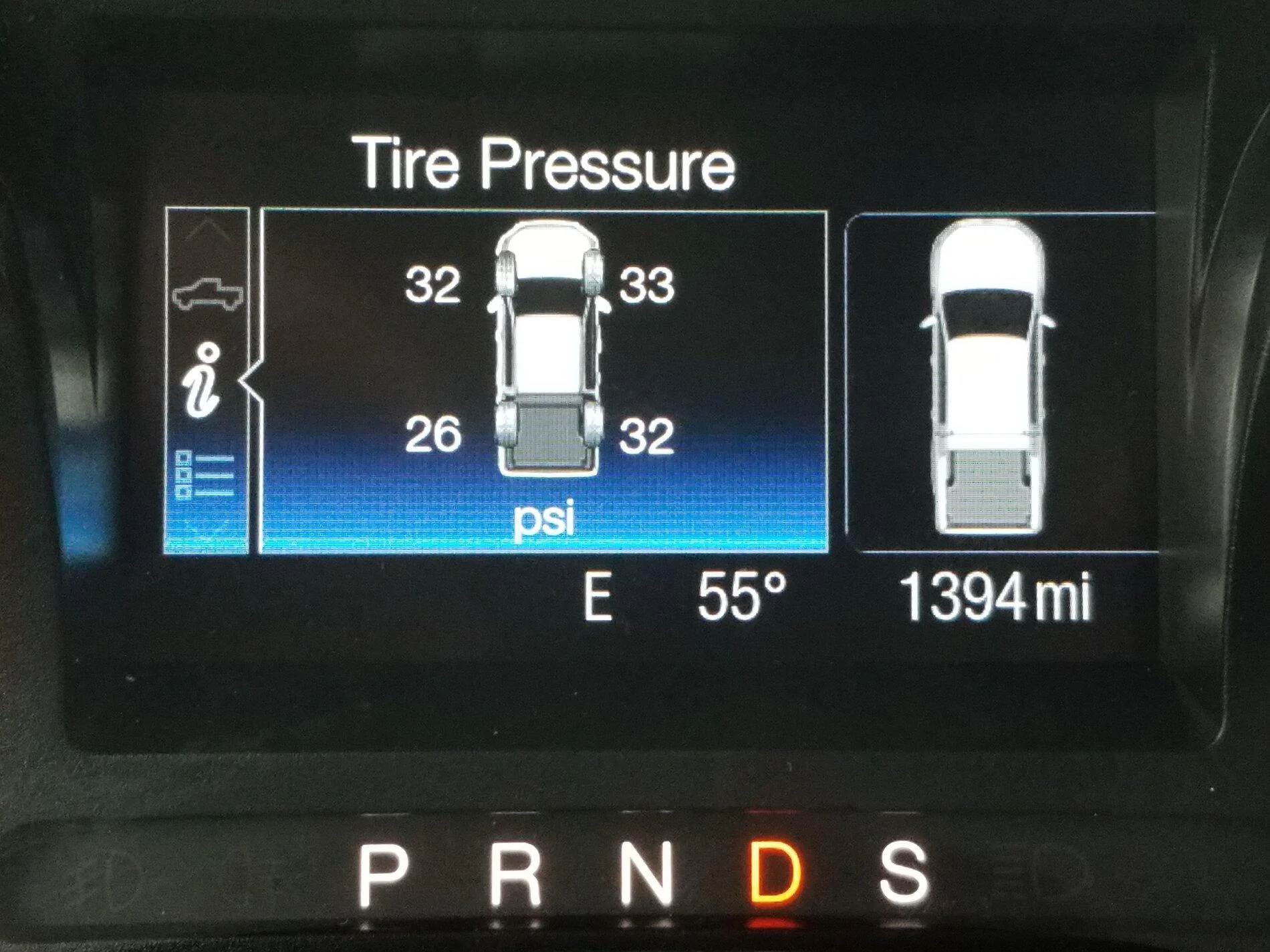

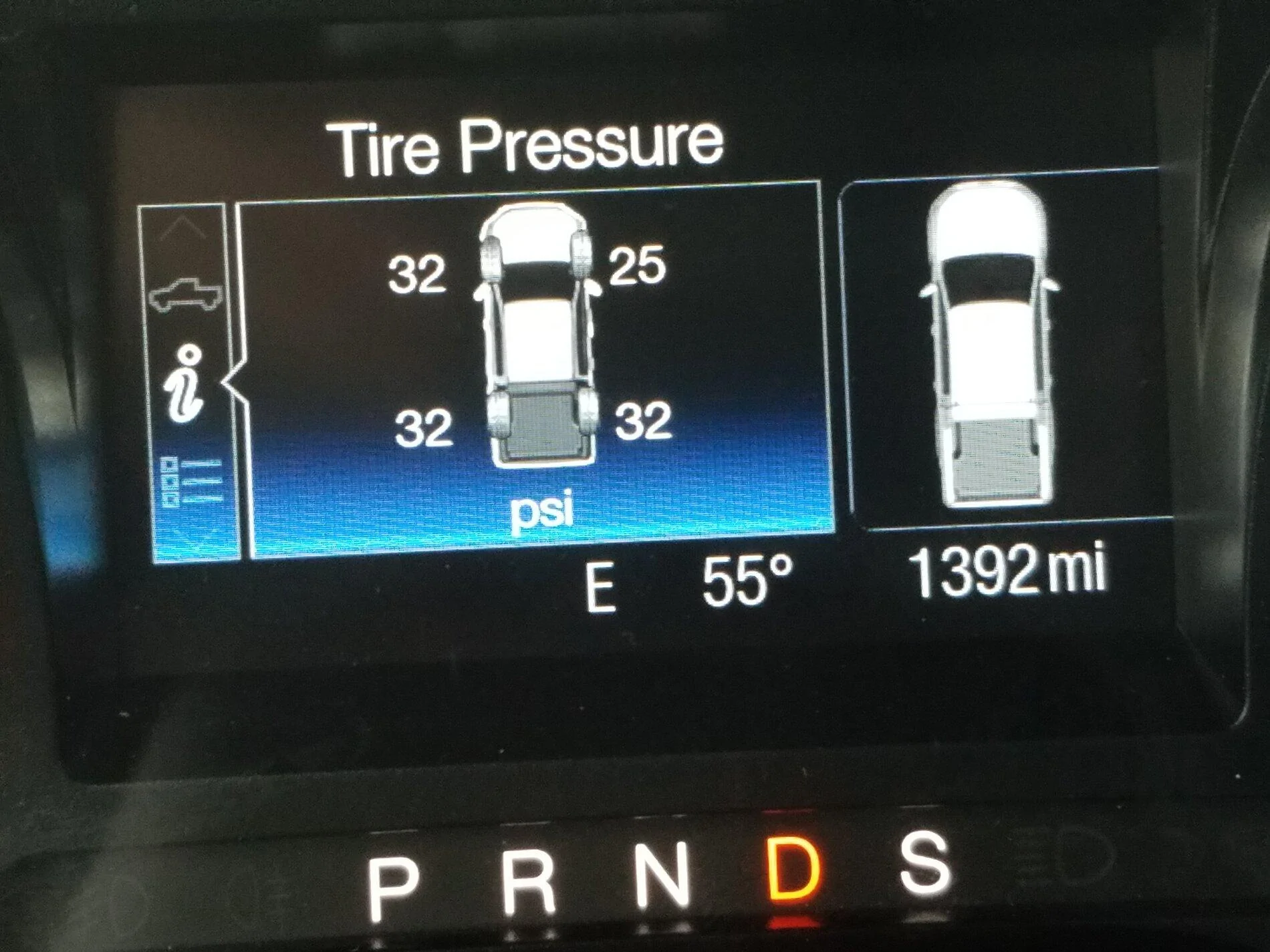

Ok, so you got me questioning myself and I just went out and did my own testing.
This is front right tire air'd down some, I then swapped that tire with the rear left tire.
Then after the classic drive for XX time over XX mph, it switched to this.
Not gonna lie I was watching the dash like a hawk and when it switched I damn near crashed the truck. It surprised me that much.
I can't say about putting in a new sensor but as far as rotating the tires its confirmed, it auto updates. Win some and lose some, lately its been the latter for me. :oops:

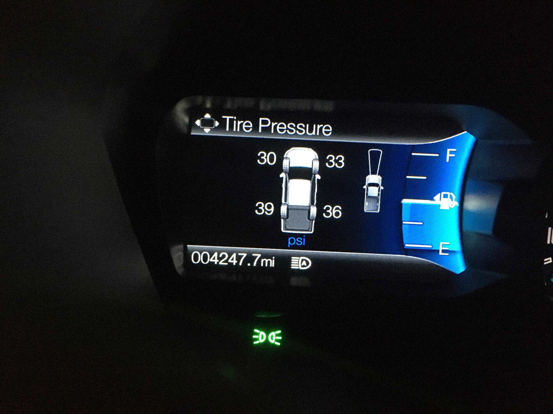

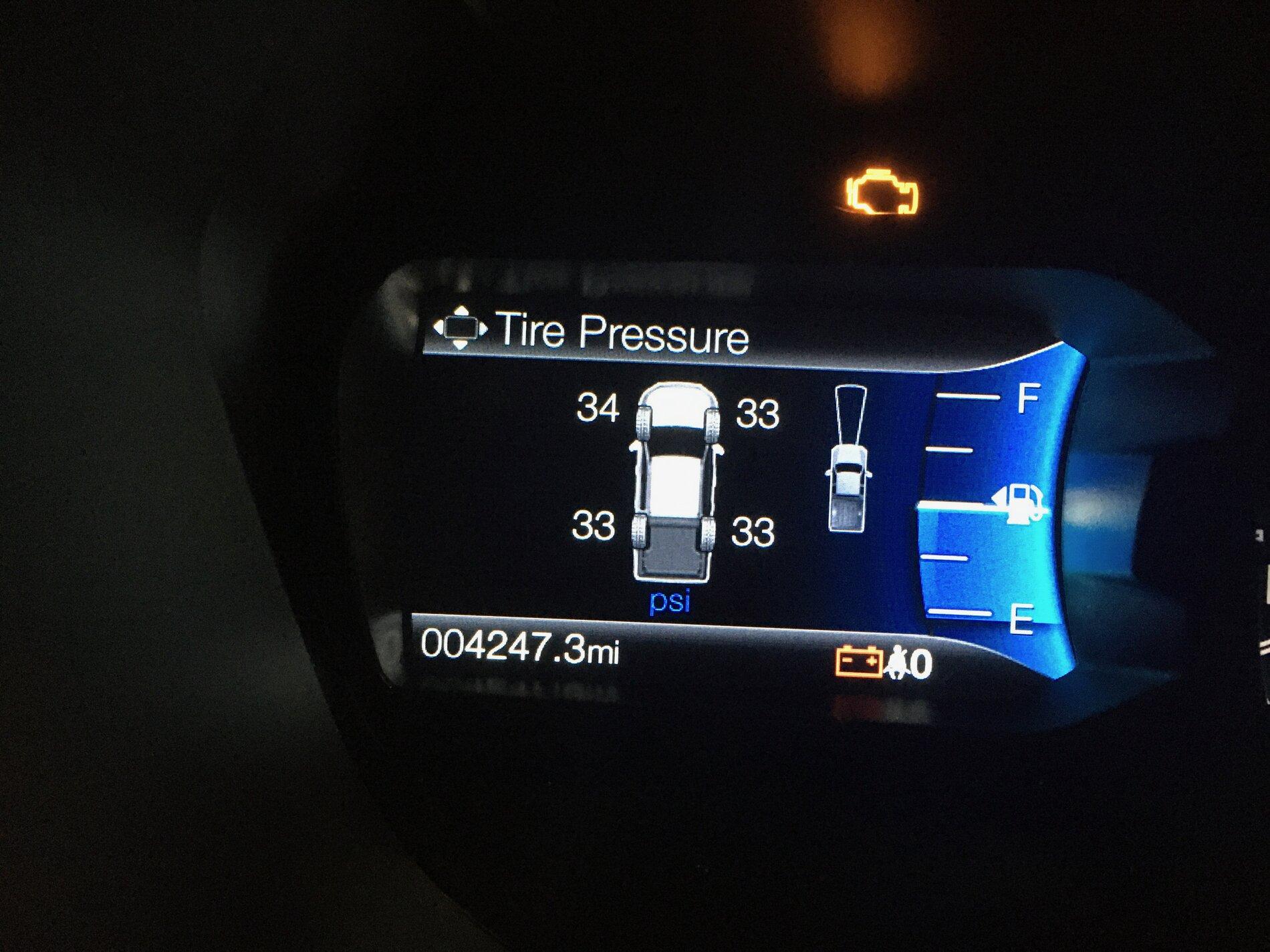

Questioning my own methodology, I did another test. The sensors in these wheels did not come installed on the truck from the Ford dealer, they were purchased on eBay.
Parked in the garage after a day of driving.
Inflation adjusted in 3 PSI increments for clarity.
The truck is sensing this on its own. No tools or reset procedure required.
