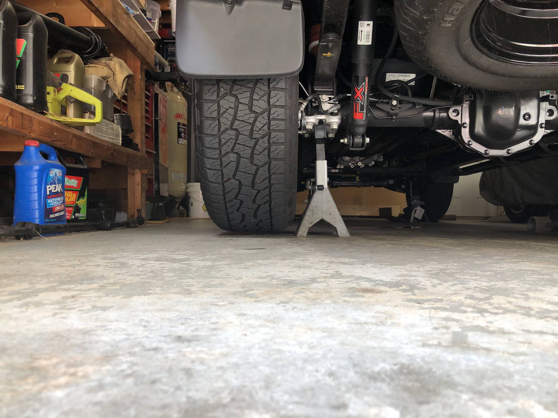

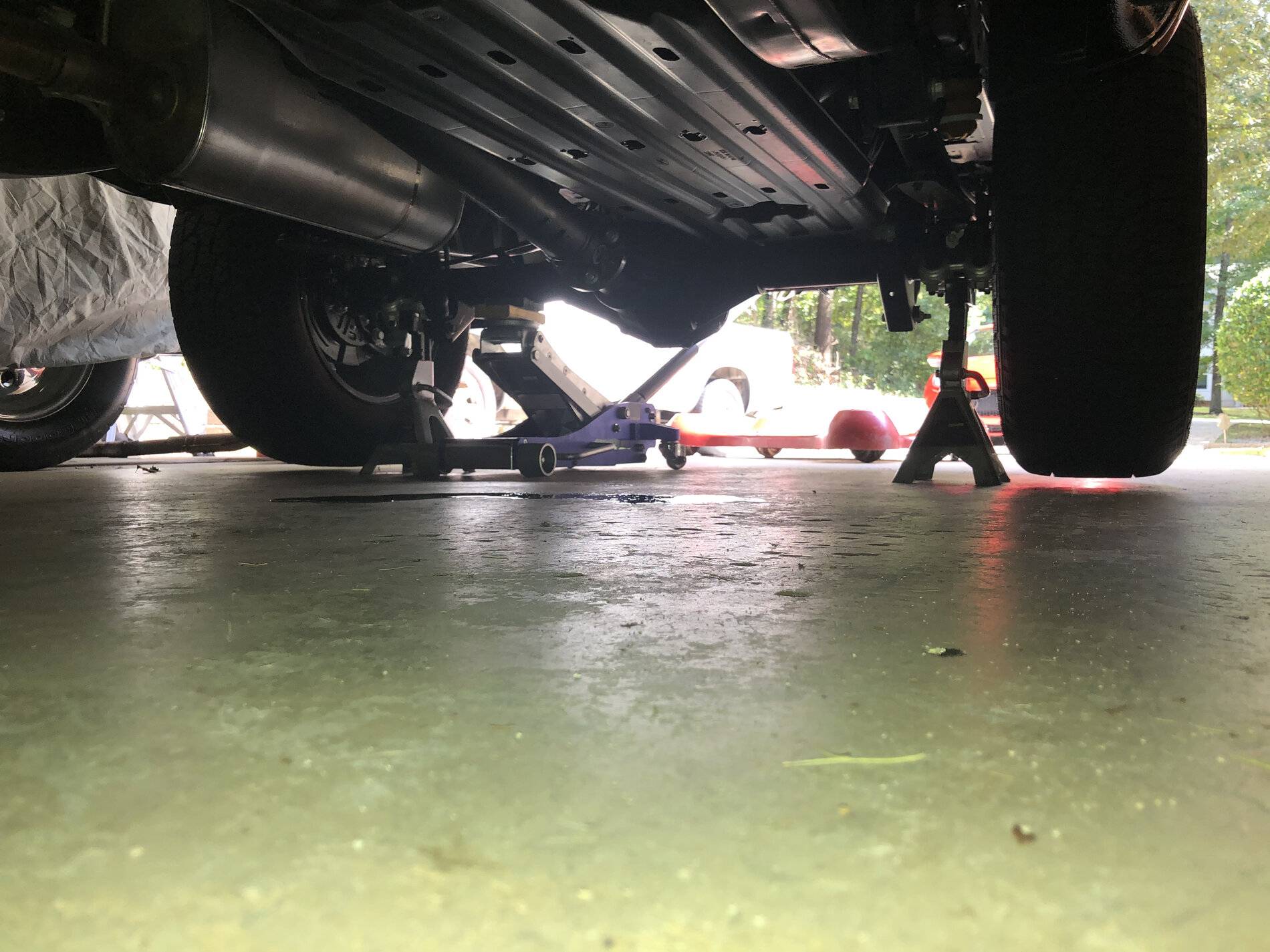

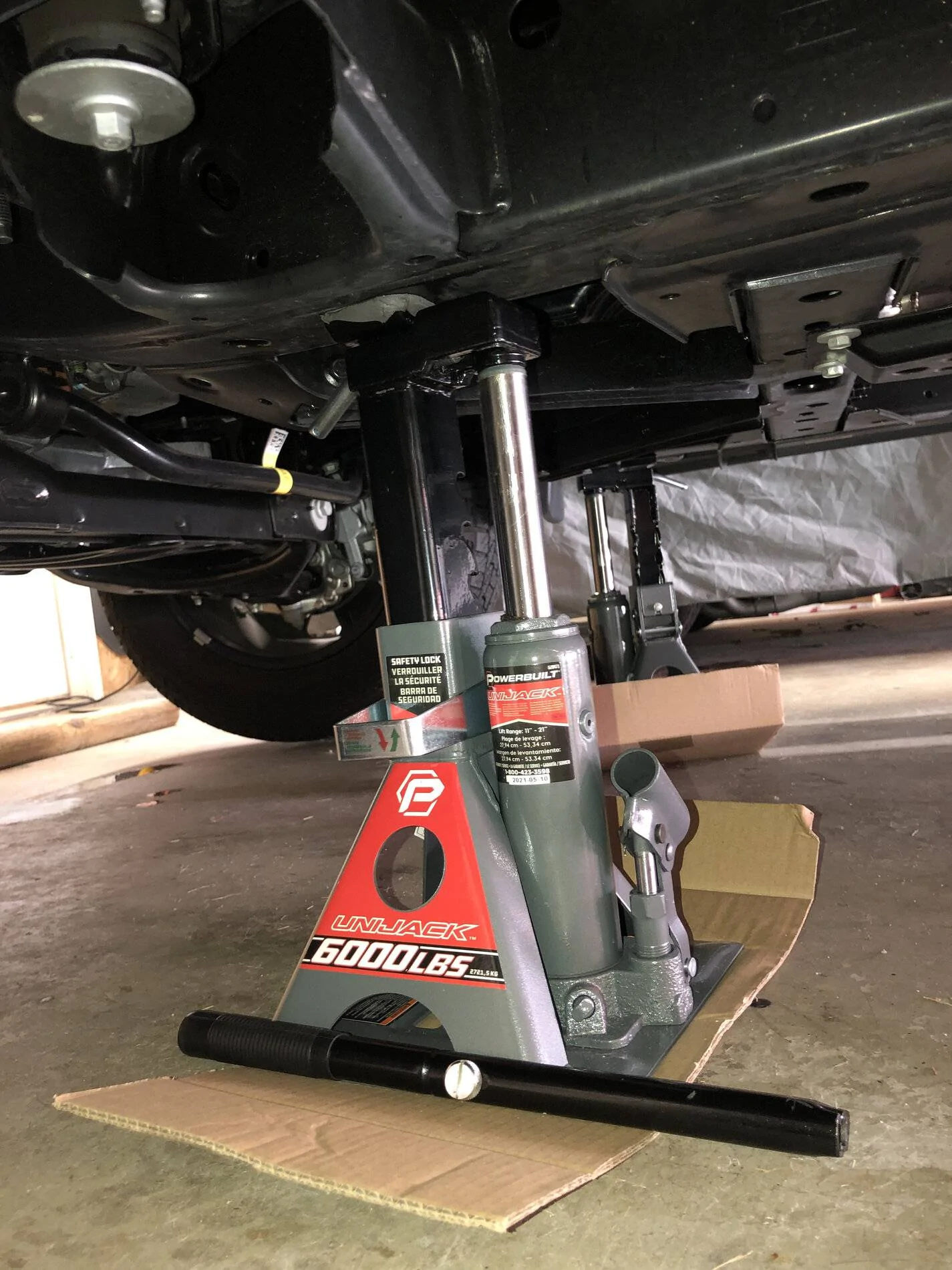

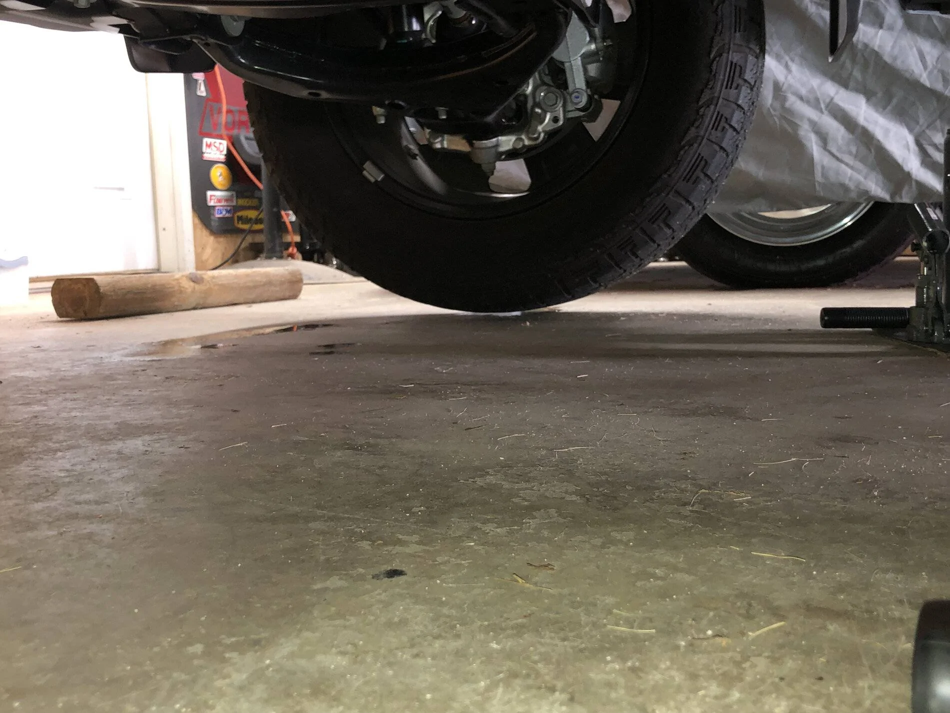

After doing some research I decided to score a pair of PowerBuilt jacks to put the front of my 2020 FX4 in the air for an oil change and tire rotation, used the standard floor jack and jack stands for the rear. The PowerBuilt 6000 pounders fit perfect under the front jack points in the collapsed position with about an inch to spare and as you can see I put it in the air just enough (Yes I could've gone higher)to get the tires off and it also left me plenty of room to get the skid plate off and change the oil. Got mine off Amazon for $81.95 a piece with free shipping. There were a few reviews stating they were poorly made/ engineered but I didn't find that to be true, they worked perfect, glad I got them. Lift range is between 11 and 21 inches.
