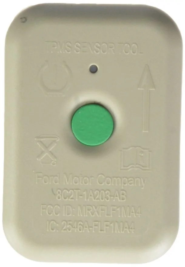

they do. they have the little remote to retrain them . i bought one on amazon for $24.... took a minute ta do. the thing is , ya have to put it in the right mode. on/off is for new tps. emergency flasher mode is to reposition known tps.

People, all these pages filled for nothing. The real question is:
Can the newer, auto-learn while driving, Ranger also be trained on a set of TPMS sensors the old way ( stationary + LF exciter / activator / scanner tool) ?
Post #63 suggests it can.
Post #66 suggests it can not.
it would be totally awesome if any of you who has the LF exciter tool and who has also done the auto-learn before attempt the stationary relearn on your vehicle. That would be the "never seen before senor learn" procedure and not the "known sensor reset" procedure. i.e. described at https://www.tpmsrelearn.com/2016/12/08/ford-1/
