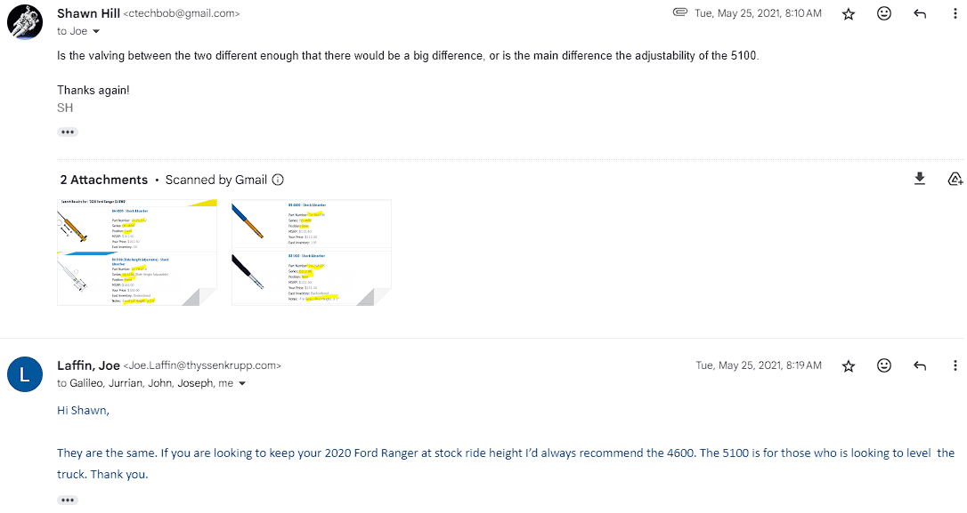

.... Bilstein 4600's are a proven and can be had for under $200 the set. Don't get talked into 5100's, they are valved the same as the 4600's according to Bilstein.....
Double check me, but its my understanding that the 4600 series is meant as a more direct OEM replacement. The 5100's provide greater travel than OEM. Having been on a recent suspension journey myself, I actually landed on 6112's and 5160's. (Coming off of Fox 2.0's) Best decision I've made. Going forward, I just can't see myself back on 2" shock bodies.
ctechbob
Shawn
Feb 2, 2021
1,654
4,342
30666
2020 Ranger XL/FX2/STX
Adult Daycare
I would have to dig up the email, but the info came straight from a Bilstein tech.
Now the front 5100's do have the additional circlip notches to allow raising the truck up that the 4600's don't have, but the rears are essentially the same.
Found it:
