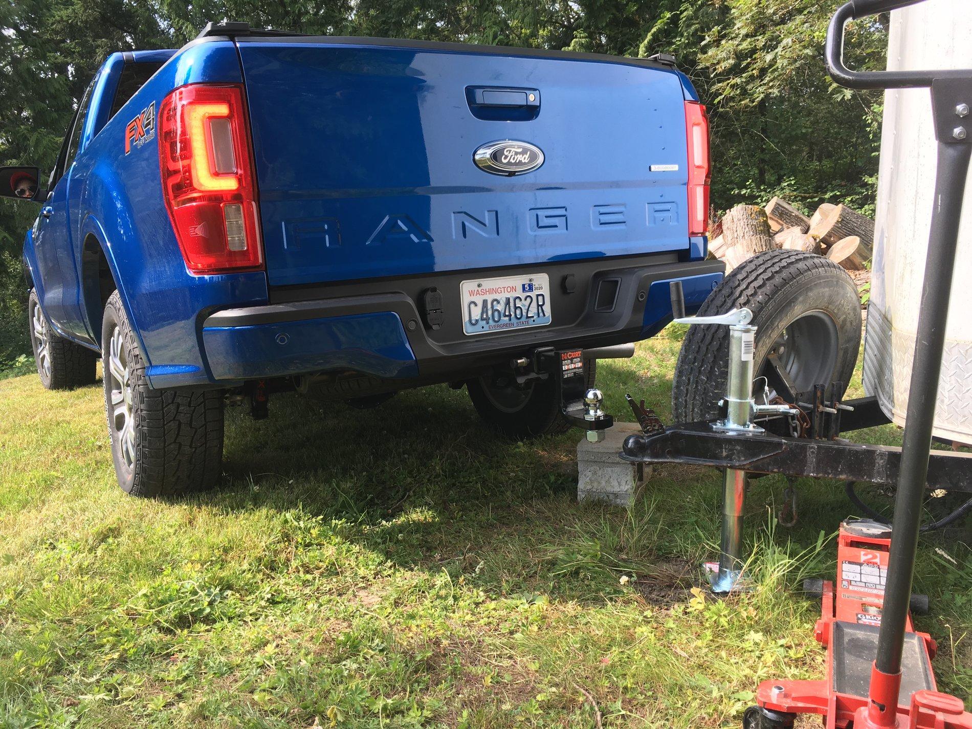

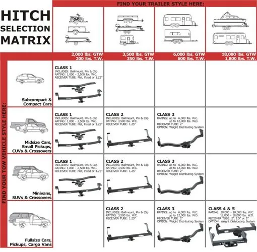

You have a class 3 hitch. It would be good to spend some time researching what you need beyond a "what do I need" general post.
Below is an image which will help you understand the classes.
And yes, the info above is correct, for a smallish size trailer or something which you don't want to have at an extreme angle, you will need a 6" drop hitch (hint: research how a "drop" is measured). You will be vastly better off for having done a few hours research into the subject than just being told what to do..... Had you bothered to give us enough information to actually answer your question in the first place, which you did not.

Ranger is class IV, not class III. But mostly that's not a useful piece of information because the vendors seem to be all over the map in defining what class III is, and many for some reason disagree with the SAE standard. (That chart is wrong, for example.) It's more reliable to check the weight rating (in pounds) of everything (the truck, the receiver, the draw bar, the ball, the pin, the safety chain--everything) and just ignore the marketing class.

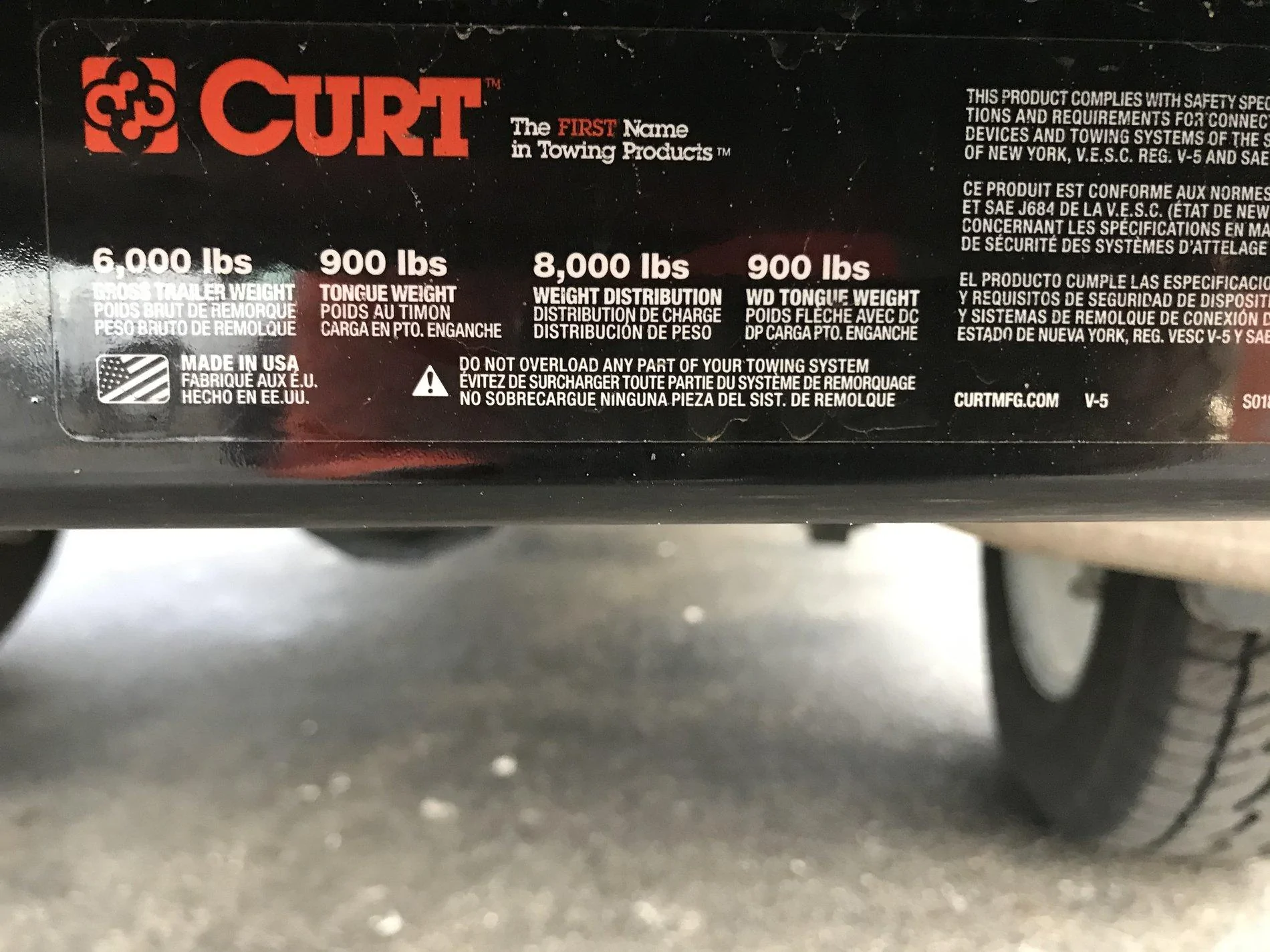

The tow rating is a bit lower than the OEM or other third party hitches, but if you don't plan on towing more than 6k pounds it's the cheapest way to add bike racks, etc.
That is not quite accurate. The Curt hitch does have a 6,000 lb tow capacity (lower than the OEM) and a 900 lb tongue weight rating (greater than the OEM). However, the rating when using a weight distribution hitch climbs to 8,000 lbs for towing and a 900 lb tongue weight.
Anything that's above OEM is a meaningless number. Manufacturer's note says "Trailer hitch weight ratings are limited to vehicle manufacturers stated capabilities." So the 900 and 8000 pound numbers are ratings for a hitch not attached to a ranger. I don't really understand what goes into Curt's web information, but it's a mess. They also call it class 3, but class 3 has a max of 5000lbs. I think someone contacted them and was told the web site was wrong but clearly that's not a priority. I'm also skeptical of the ratings if the OEM hitch is 7500 regardless of wc or wd, but the Curt part gains 1500 (nominally 2000) pounds with wd--it makes me think they're slapping a generic label on without actually testing the application.
Mike,
I was in no way insinuating to tow beyond the stated capacities of 7,500 lbs and 750 lbs tongue weight. My point is that with a weight-distribution hitch the Curt hitch is capable of towing an equal amount as the OEM hitch at a lower cost. I would always use a weight-distribution hitch beyond 3500 lbs. to ensure good stability so the curt hitch works for my applications. I think the trailer hitch classification is screwed up all over. Also, Draw-Tite has similar information on the class III ratings as the Curt website - 6,000 lbs and 10,000 lbs weight distribution hitch.
