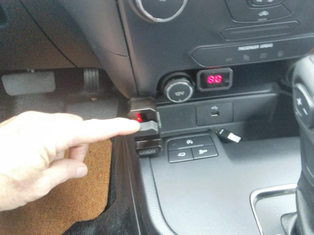

Floyd
Jan 6, 2019
2,064
3,114
illinois
Install a real brake controller!
It is easier and more reliable.
I like the Prodigy series, but they don't fit as well in the Ranger as some others.
My "Insight" works at least as well and can be installed in much more convenient locations with a built-in look.
below is a picture of my install, it just an example with many other choices.
https://www.amazon.com/Hopkins-47297-INSIGHT-Simple-Control/dp/B00C5THYIK
