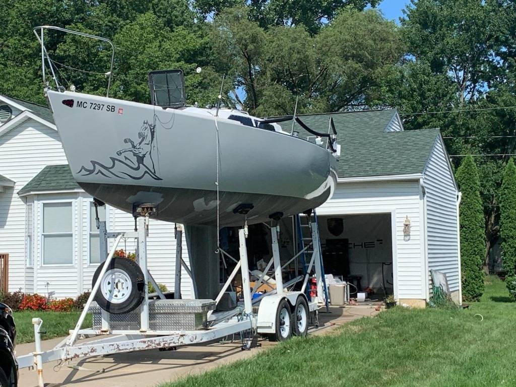

What ever do you mean our race boat has electric brakes on the trailer

Peragrin
Sep 16, 2021
379
982
Fitzwilliam NH
2021 Ford Ranger
Purchasing
I'll put money on it that they're surge brakes, not powered.
I would go 50/50 odds on that. Those boats are usually picked with a crane off the trailer.
Yes you can back in but you need a really steep ramp. to get enough water depth to float her.
Much safer to pick her up with a 30' 15,000 lb rotating crane. at least six yacht clubs I know of use that method to store and launch their J fleets multiple times a week. You can luanch a boat every 5 minutes by hand no problem.
if the trailer doesn't get wet who cares what brakes it has?
