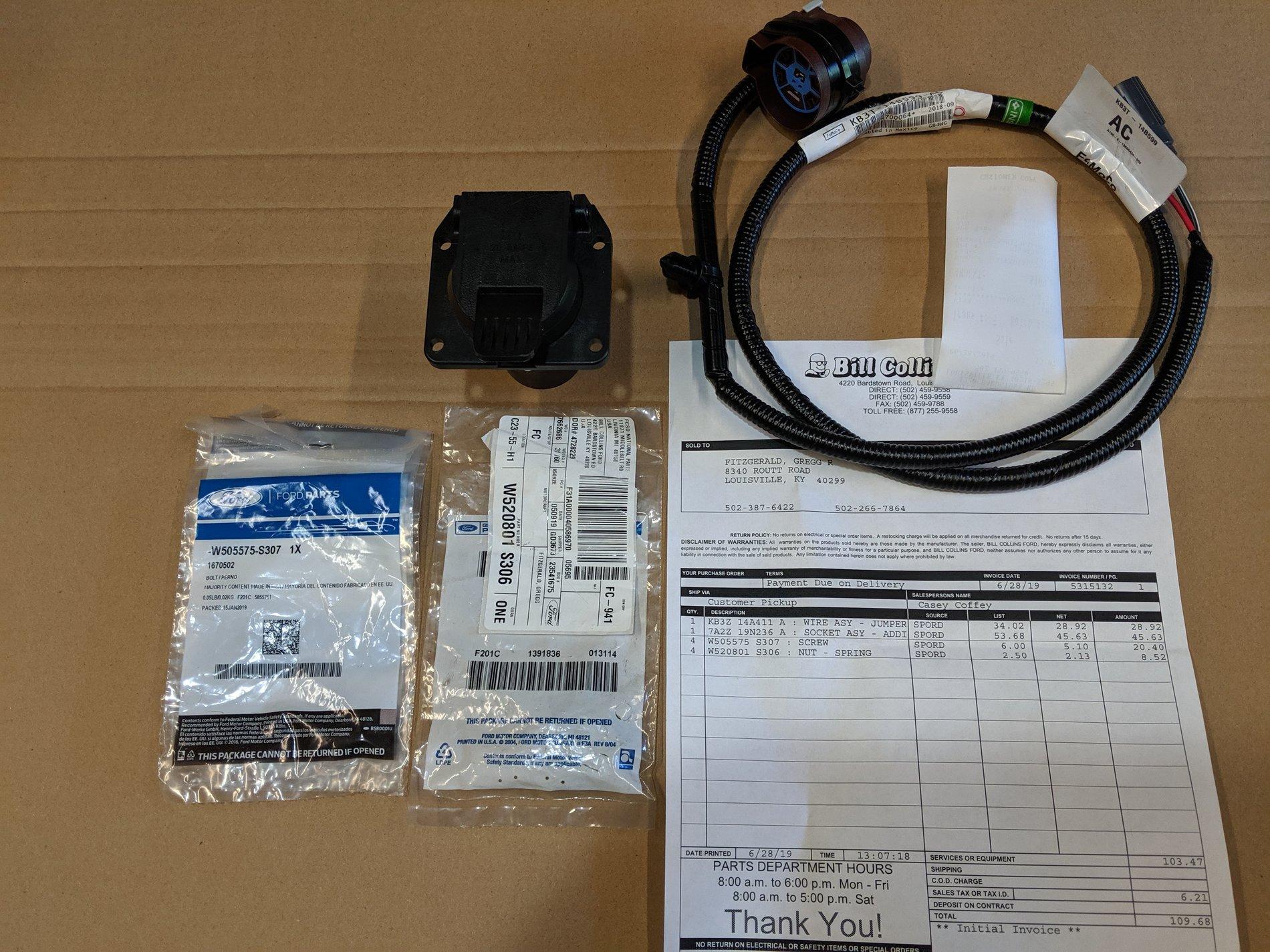

As I posted in another thread. I have ordered (what I and a dealer parts guy) think is needed to add the outlet. Including hardware and the sub-harness. I will post pics of the install and part numbers to those interested. Waiting on parts from Detroit. Just a FYI drilling is required.
NOTE: 19N236B in the diagram below is not the correct part number. Should be 19N236A. See post #3 below for correct part numbers and quantities.
Just ordered these parts from a local dealership... $130 with tax.

All the right parts.

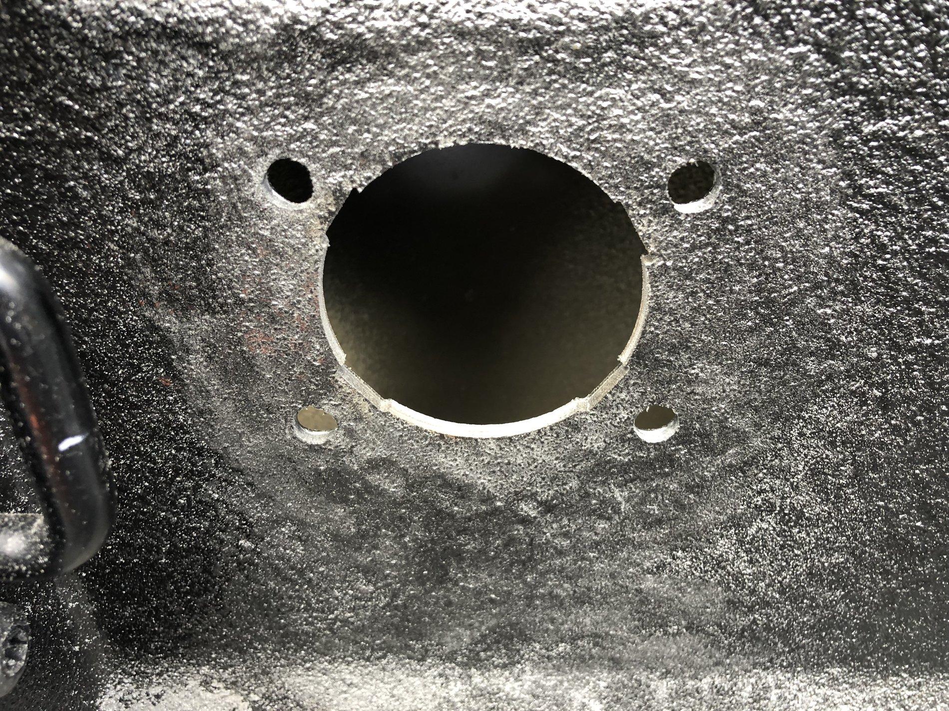

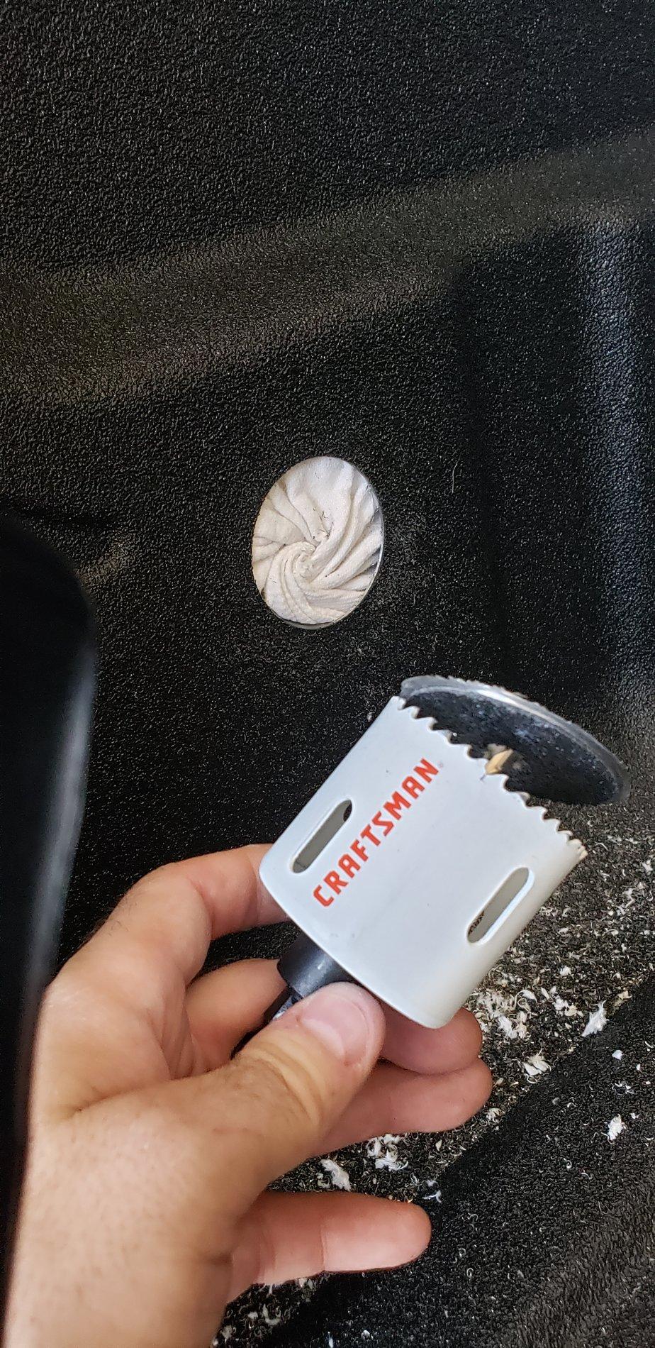

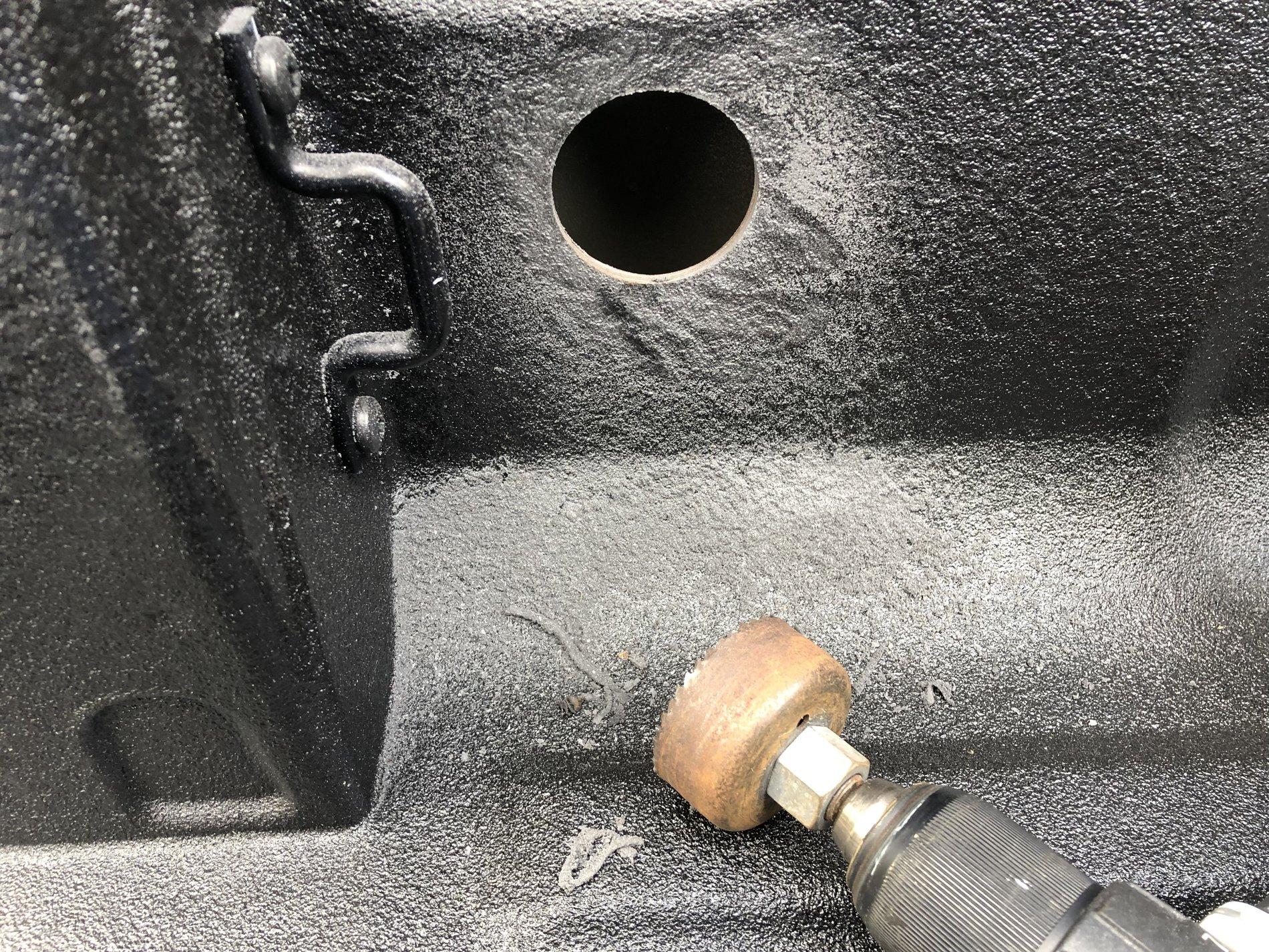

Ok for the install you will need a 2-1/8” hole saw, 5/16” drill bit, flat and round file, Rust preventative paint of your choice.

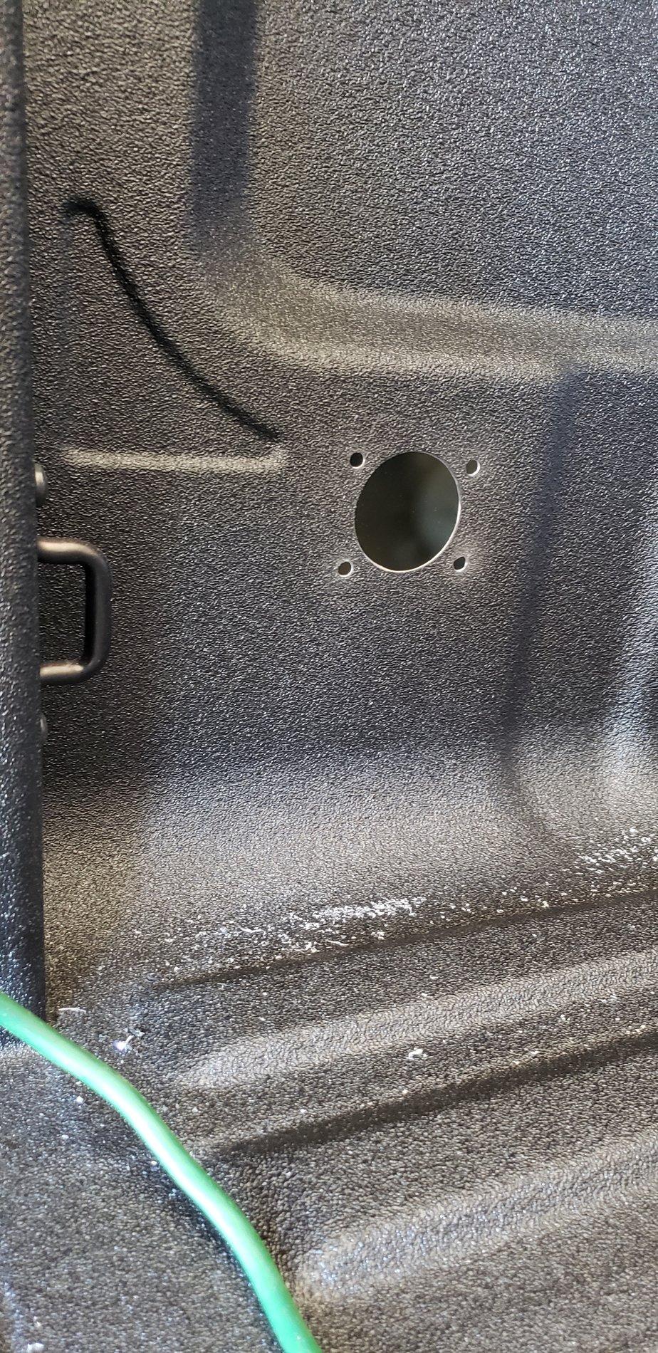

Drill a 2-1/8” hole in the side bed wall near the left rear cleat. (See photos below) Use caution when drilling or you will end up with dings protruding from your outer fender. You can position a block of wood or stuff a bunch of rags up into the cavity from below to orevent damage.

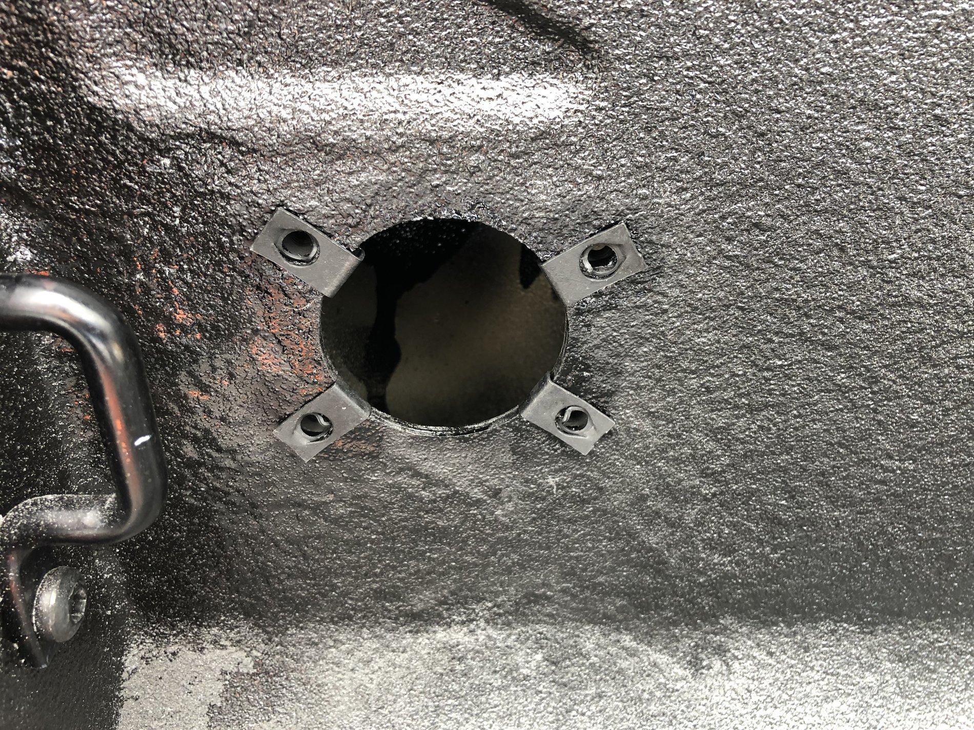

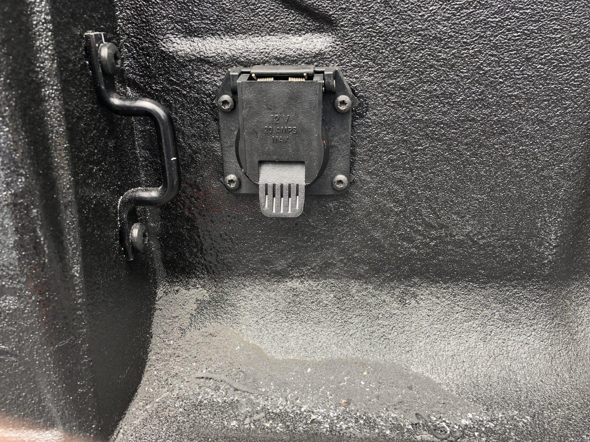

Insert the power port body into the opening and mark the location of the 4 screw holes. Drill 4- 5/16” holes. Debur all holes using a round file.
Using a flat file, in the large opening, create 4 flat areas adjacent to the 5/16” holes. Insert the 4 captive nuts into the body with the threads inboard the fender. Paint all exposed metal with rust preventative paint.

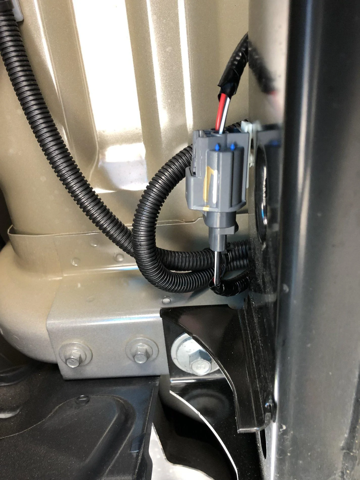

Install the sub-harness onto the socket and feed the wire down the inner fender well. Install 4 retaining screws.

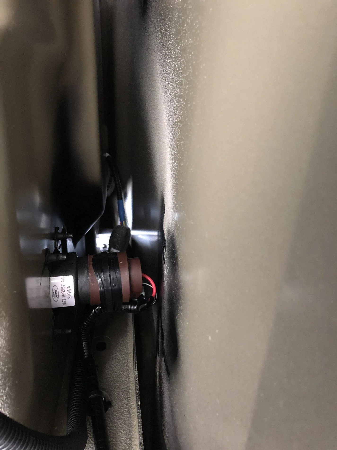

Under the truck, remove the dummy plug from the body harness and insert the power port sub-harness. There is one large hole on the sheet metal pillar opposite the tail light cavity for the “christmas tree style” zip tie retainer that is included on the sub-harness.
I ended up adding a few extra zip ties to secure the wiring.

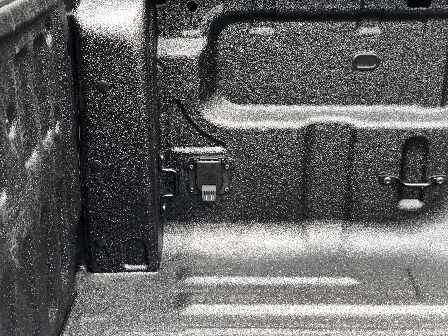

Thats about it. Time-about 30 minutes.
Pics below...

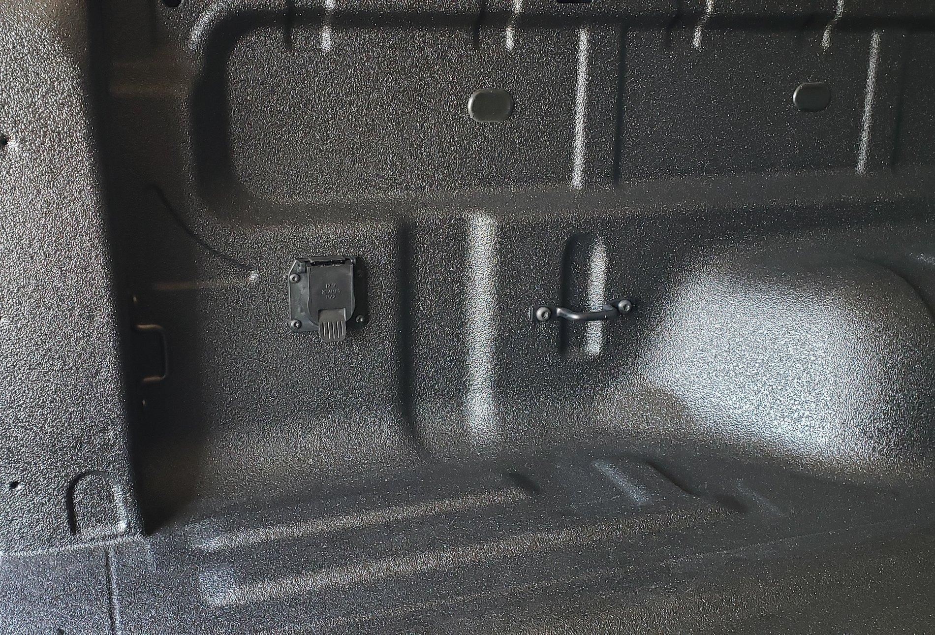

Installed mine today. Moved it a bit away from the cargo hook.
This has been pretty much the only complaint I've had other then the lack of mud flaps on this pickup. I made it harder on myself with the drop in liner but it irks me when I'm trying to use that driver rear cargo hook and have to fight with the 12v receptacle.
