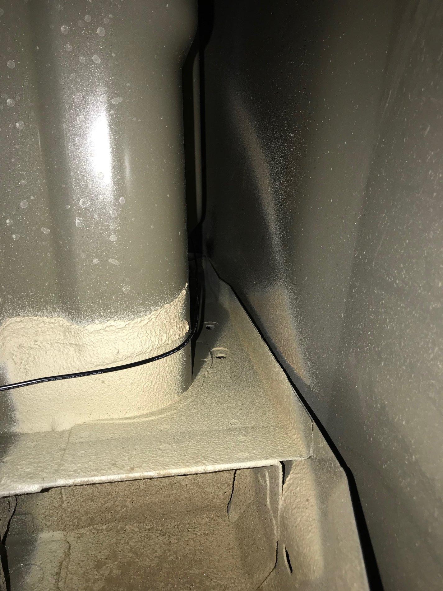

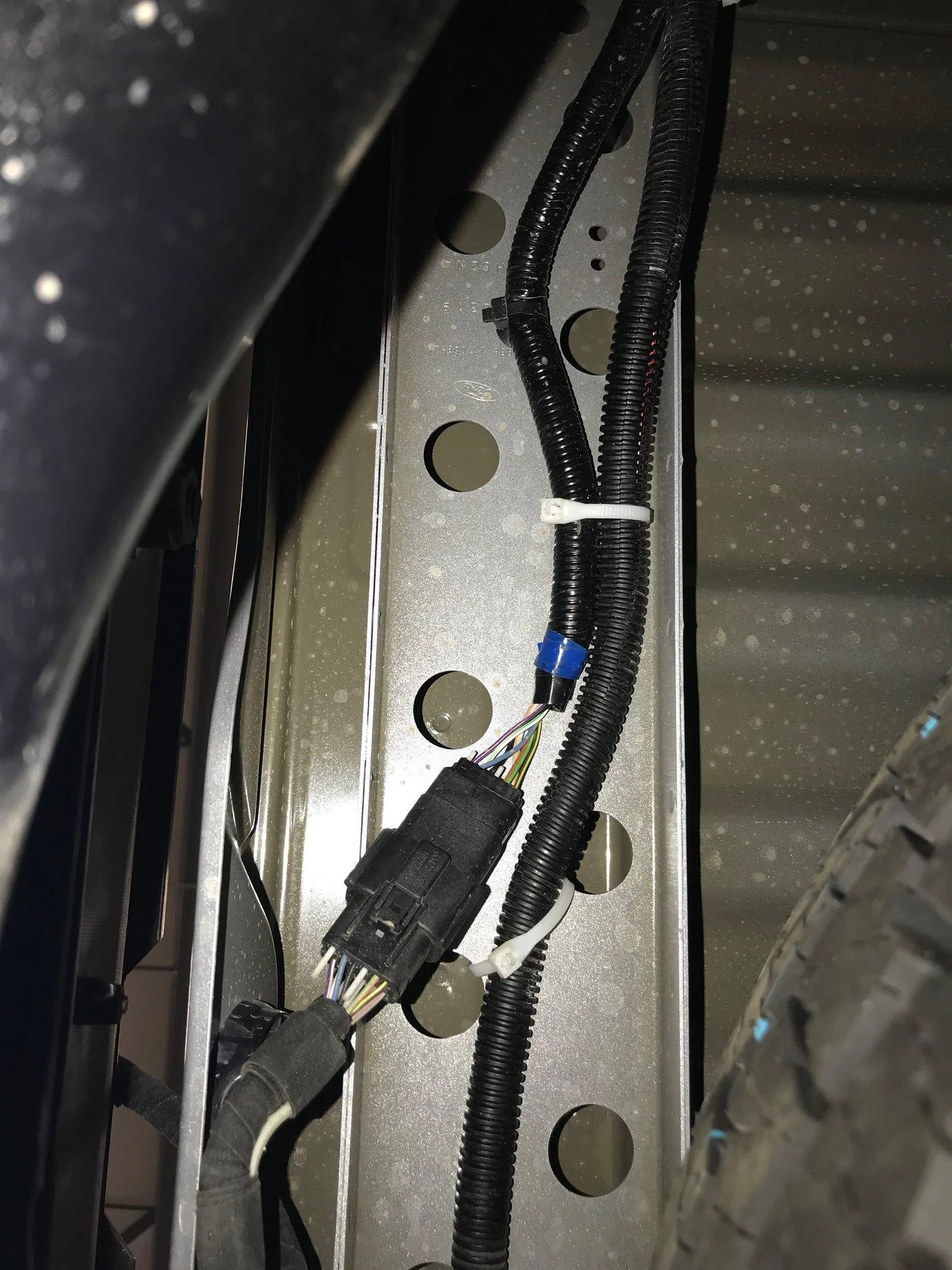

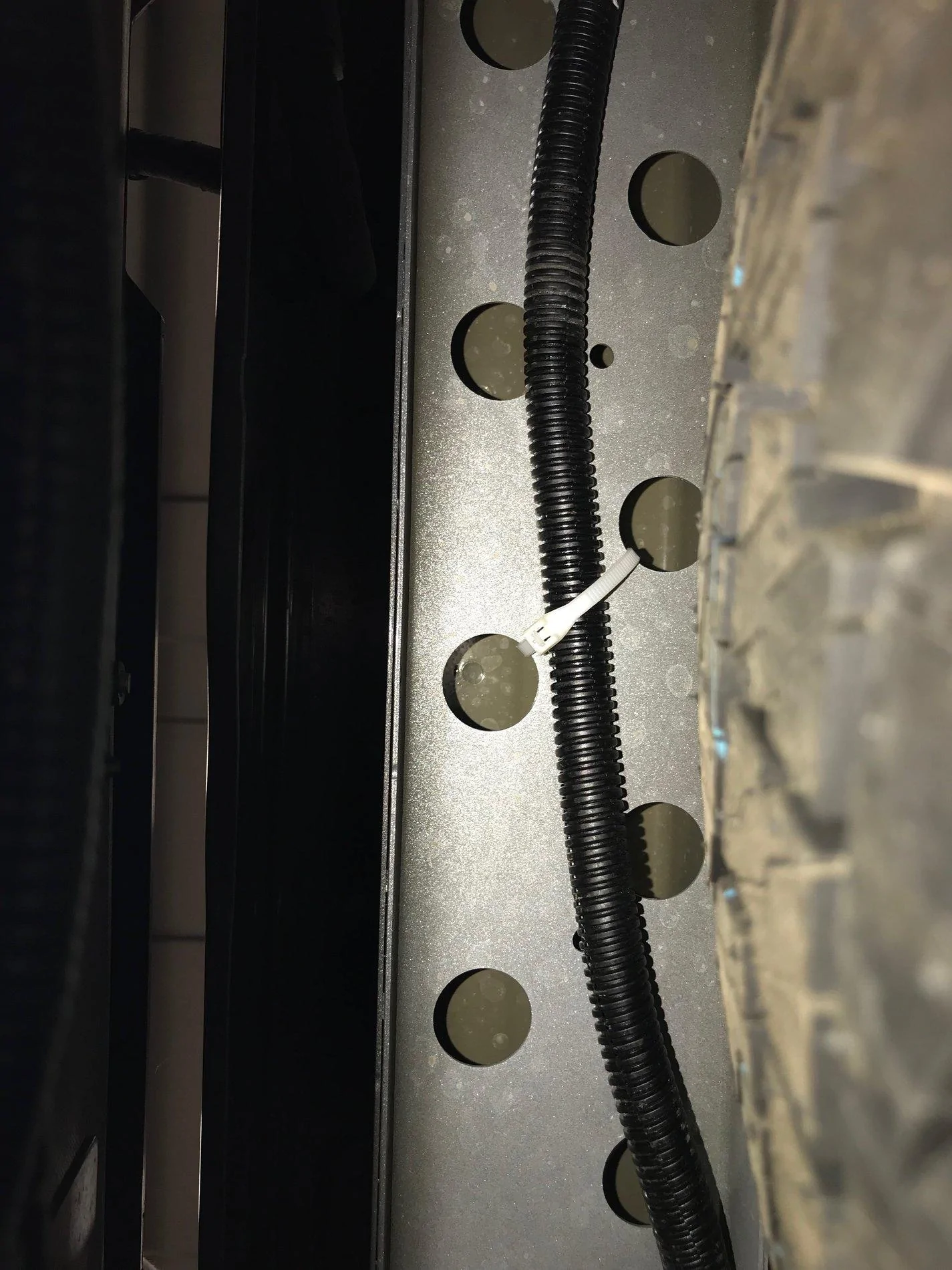

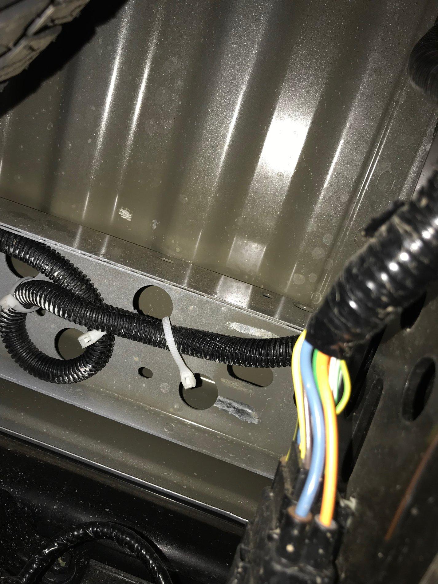

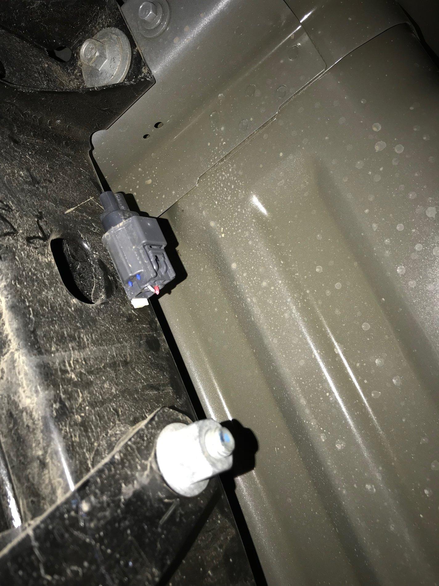

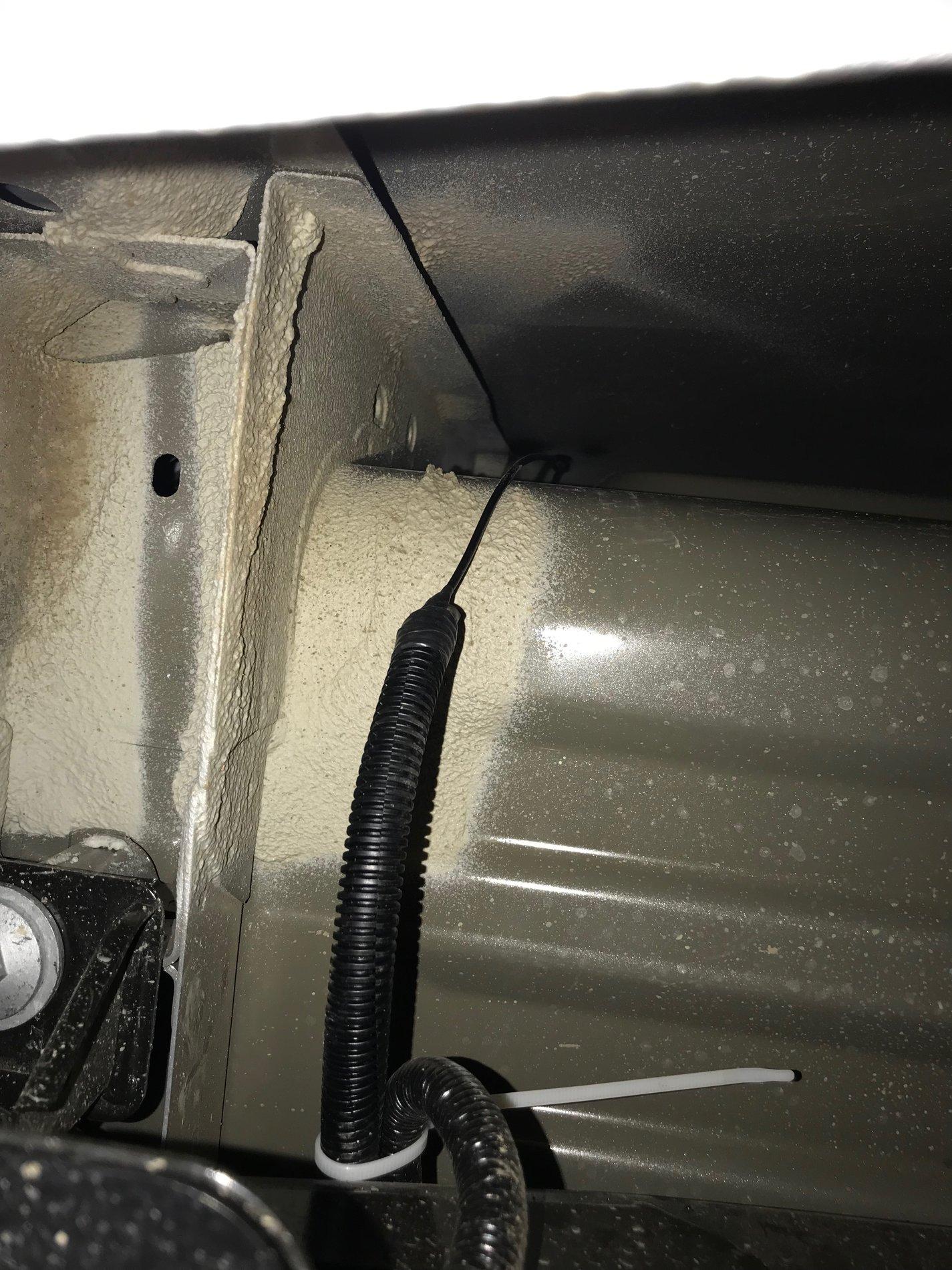

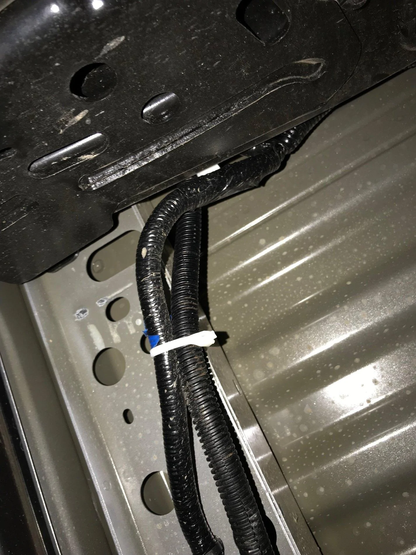

No dumb questions. Single LED strip per price as some applications only need one strip of LEDs. I'm actually going to order a 12" one for under my hood for when looking at the engine compartment at night and I'll wire that into the engine bay fuse box. About 18" of the tail after the switch, look at their website and you can see the switch and LED section under the Features section showing the pictures. The end reached from the spot where I/we mounted them to the bottom of the fender. My buddy just connected a section of wire to the passenger side one and then ran it over to the driver side where he tied into the 12v bed port wires. Here are some pics from underneath, filename as descriptors to help.
CUT 12V bed outlet wires and used as power source on inside of frame rail now.JPG
Driver side inside frame rail connecting into 12V supply and passenger LED and driver LED wires.JPG

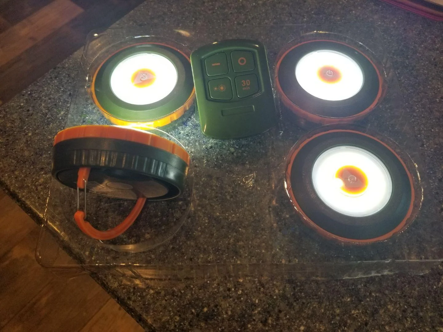

How do you get all of them all to come on and turn off by the remote? I can get one or two to respond but never all 4 of them:>( Of course it doesn't come with instructions.....
You have to point the remote at the lights you want on.....That's so you don't use batteries on all of them if you only need one side. It's pretty bright in the bed.
Do you manually turn them on the first time and then use the Remote to turn off and then back on when you need them? They each have a manual on/off capability and none of them responded until I turned them on....
Plus, they are ugly as shi*.....! Think I'll get some Derp and spray these so they look a bit better in my Lightning Blue Bed!
That's right. Turn them on manually then use the remote. I am a form over function guy..Plus who is really going to see them under the cover. People spend a ton of money on Aesthetics. I am less concerned about that then an actually needed function. Plus the cost was super low. I transferred one of the lights to my hood when I needed extra light. I like that they can be removed and moved.
