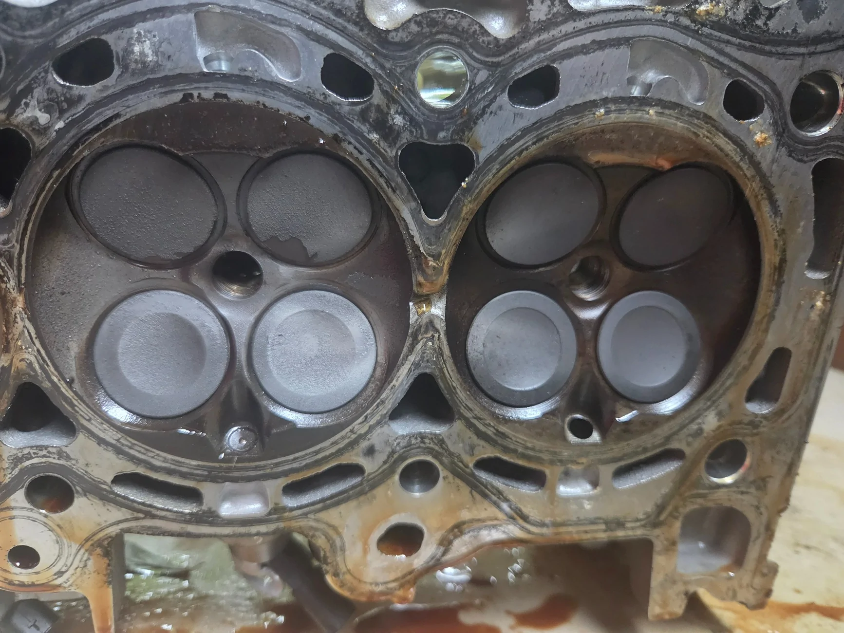

2021 With 177k miles. Noticed the classic sound of marbles in a can signaling detonation. Replaced the spark plugs and inspected the cylinders and could not see anything.
On the test drive the detonation cut a notch in the cylinder head and block between combustion chambers. My first thoughts were a timing issue, or bad gas. But since it it localized to one cylinder I'm thinking clogged injector.
It is concerning that there is no accessible filter. (And from my understanding it is only a screen).
Fortunatley the new (used) motor came with the original injectors and 100k fewer miles.

Wow, that's a new one. How do you know it was isolated to one cylinder when it took out 2?
If you zoom in on the picture you can see the white chalky dots all over the valves. The other cylinder is brown and oily like normal

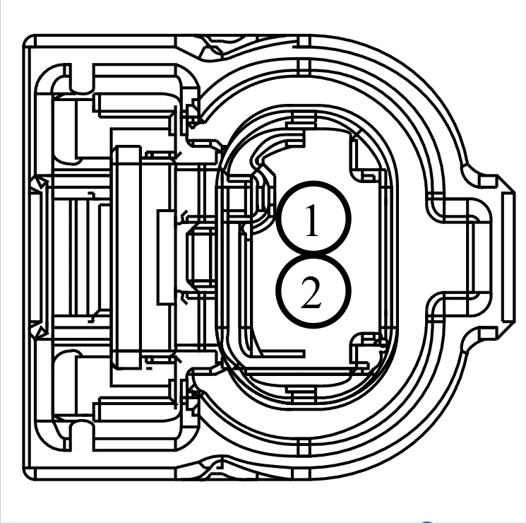

Injector (Component Test) - The Injector (itself) Pin 1 to Pin 2
Ensure all injectors are at the same (Room Temp)
Injector (Component Resistance) Check
Ohms Scale - Probe Both (Pins)
Specs = 1.0 to 3.0 Ohms
They should all match (Results) - Very Closely

Injector #3 - For Ref
C183 - All 4 are the same pinouts
Pay close attention to #3 connector - ensure contacts are secure and tight
