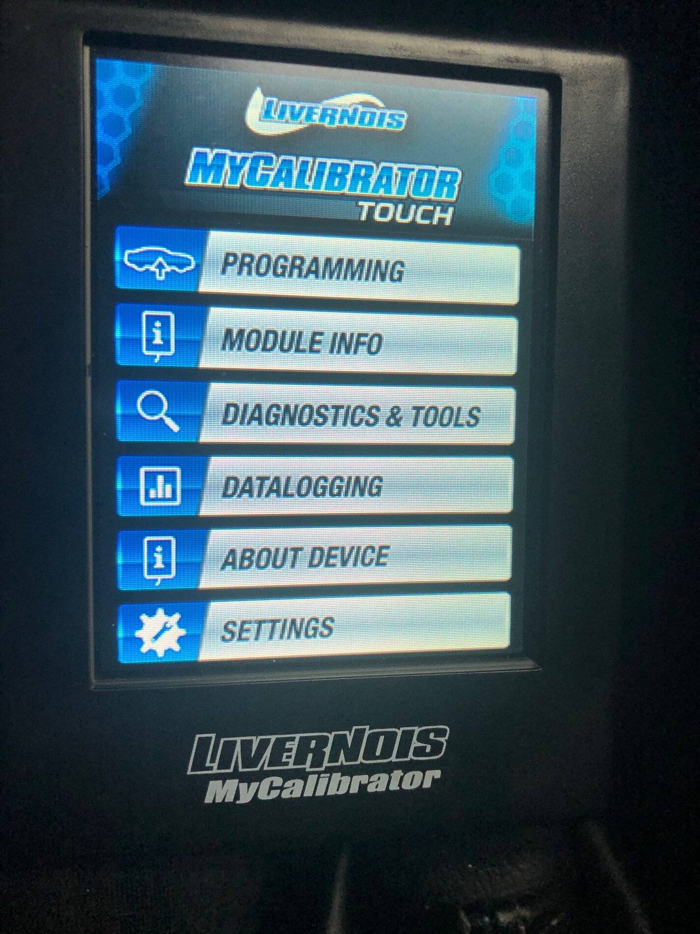

How does one flash their truck back after disconnecting and updating on the laptop. Do I just go to the truck and plug it back in and follow this?
Installing Performance Calibration into the vehicle ***NOTE*** ONCE CALIBRATION PROCESS HAS BEGUN, DO NOT PRESS ANY BUTTONS OR DISCONNECT TOOL UNTIL PROMPTED TO DO SO. ENSURE ALL ELECTRONIC ITEMS (RADIO, WINDOWS, DOORS, LIGHTS) ARE OFF AND ARE NOT OPERATED UNTIL CALIBRATION PROCESS IS COMPLETE
1. Connect ProCal 4 tool to vehicle OBDII port
2. Ensure vehicle is in “RUN” position (Key on, Engine Off) ***NOTE*** ENGINE MUST NOT BE STARTED/RUNNING UNTIL PROMPTED BY TOOL, OR CALIBRATION PROCESS IS COMPLETE
3. Select “PROGRAMMING” option from main menu
4. Select “Performance Calibration” Option on ProCal 4, and Drag/Click to select the desired calibration. ***NOTE*** DURING CALIBRATION PROCESS, THERE WILL BE VARIOUS WARNING CHIMES/ALARMS (Check Engine light, TPMS light, etc). THIS IS EXPECTED, AND PART OF THE PROCESS.
5. Follow ALL on-screen prompts, until “Clearing Codes, Finished, Key off for 3 seconds” is displayed, signaling the end of the procedure
137,222
Just plug the tuner back into the ODB port. Go to the main screen and touch programing. One the next screen you should see the FPT and your stock tune. Here's what mine (Livernois) looks like but they're the same tuner box and should look similar.
Thank you very much Dave. Turns out I am part of the group without the new torque converter change. So I guess I updated just the procal software and not the tune, files stayed the same name. So I think I am good to just start the truck I think...
137,222
If there were updates it should update the whole file and you should be gtg after re-flashing. It does take a couple tank fulls to let the tune "settle" in after re-flashing. You should be back to rocket status in no time. ? ?
