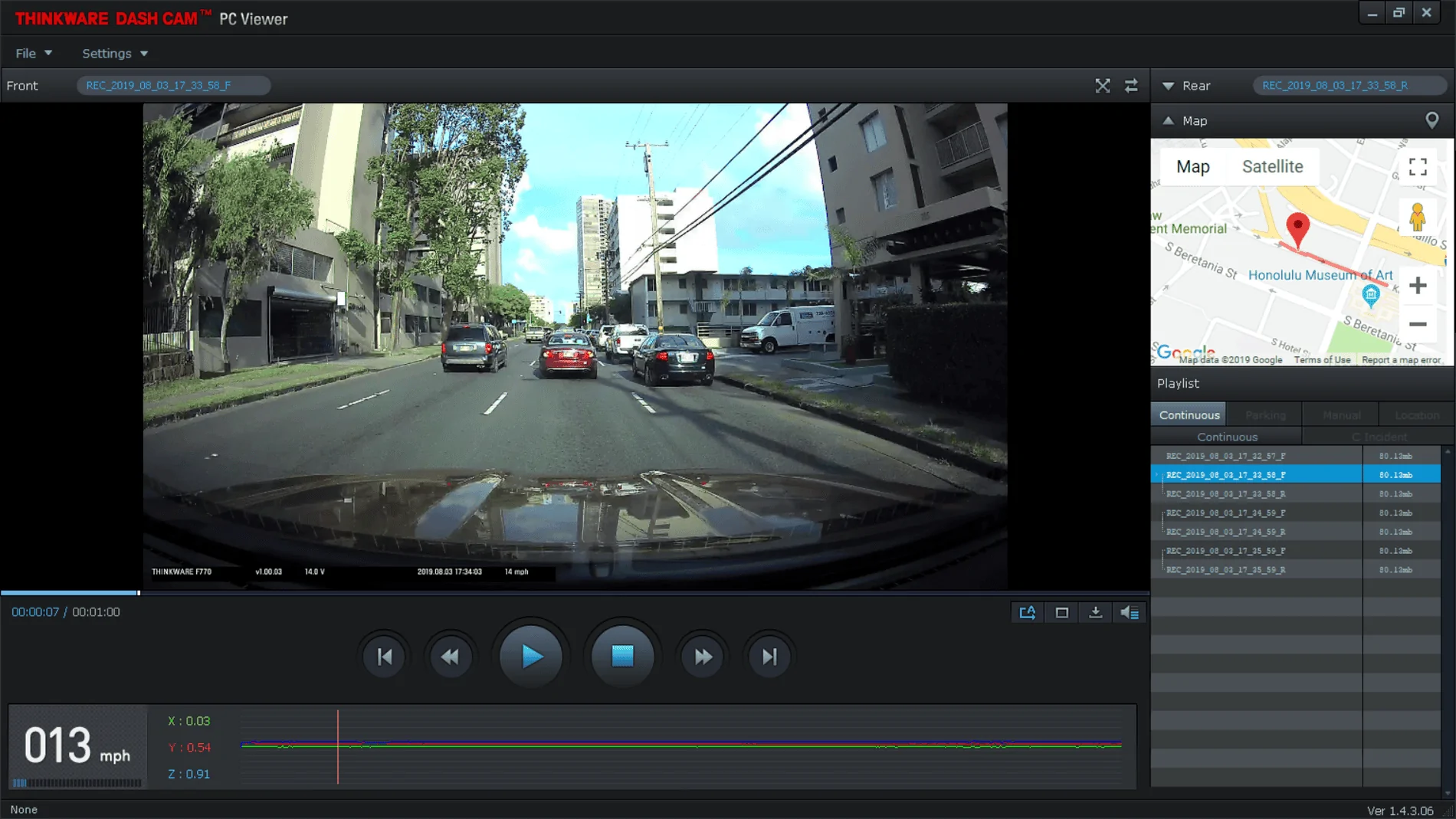

@Lunchbox88 - I finally got around putting a video together :)
I made the video picture-in-picture, this is not how they normally are saved though, I just edited it together (which is easy enough as the camera records and saves the video files for front and back in 1 minute sections). When watching them on a phone or computer they will show either front or rear camera (depending on what you select). There's also a dashcam viewer for both phone and computers, the computer version allows you to see where you've driven as well as the files contain GPS data (I'll post a picture of the viewer with map below to give you an idea).
The first part of the video is just regular driving, after a minute I switch the front and rear cameras. Then there's a bit of night driving, again switching between front and back after a minute. Then a minute or so of driving in the rain to give you an idea how that looks, and finally two parts (these are only 20 seconds each) with the camera in parking mode (motion sensing).
Also, there's audio in the first bit of the video, but there was talking between me and others in the rest of the video so I took the audio out of that since I don't know if they would consent to me uploading the conversation lol, just so you know why the rest is silent :)
Here's that picture of the PC viewer:
Hope this helps :like:
