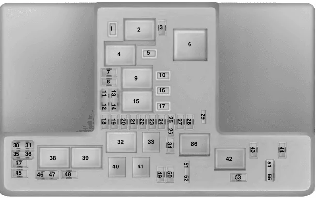

Thanks for the fast response!!! I believe you are exactly correct. The battery pack is receiving continuous power and therefore not telling the camera to go into parking mode. I used the micro tap and it looks exactly like yours, with the wires going off to the left into the a-pillar. I have my fuses placed in the same spots on the tap. I am currently tapped into #36 just like yours. There are a few fuses that are "not in use" according to the manual, but have a fuse in them. Would it be a good idea to try one of these fuses instead of #36?
Not a problem :)
You could try them, but if they're not in use, it is possible they don't receive any power at all (they may not be connected). Also, your #36 may have a different function than mine, but I think you can see this in the manual as well. If it does have a different function, it could definitely be the case.
What you could try is to use a multimeter (volt meter) to see what fuses turn off after the acc turns off, and pick one from that :)

I will try the multimeter on different fuses. My #36 is Auto-dimming interior mirror. Thank you very much for your help and your original post! It really helped me install the camera and battery pack. I just have this small hurdle to get over.

Gotcha. So, I tapped the #37 fuse as it does not provide power when the truck is off and I get the same result. No parking mode. So to test, I unplugged the power input to the battery pack and waited and the camera still will not go into parking mode. The setting within the camera seem to be correct, but I am not sure because the manual is not very informative. Any ideas?

Hmm, in that case, there must be something else going on, and I think you should even be able to use #36 again in that case (but #37 is fine too, though).
Just in case, is the battery pack fully charged? It is possible there's not enough charge in the battery, and that it shuts off the dashcam instead (then again, you should be able to see that not all lights of the cam are on anymore).
Another thing could be that the yellow and red cable that goes to the battery have been switched around, if so, it would not register that the ACC is turned off but always receive power instead.

Yes, the battery is fully charged. It seems that the battery is okay. I opened the battery app and watched as I turned off the truck, the charging stopped and the battery beeped. One more thing I noticed was that when I press the manual record button, nothing happens. Not sure about the yellow and red wires tho. The connector is in the input on the battery and can only go in one way. I am at a loss here, maybe I got a dud or my setting within the camera are wrong. Thanks again for your help, i really appreciate it!
