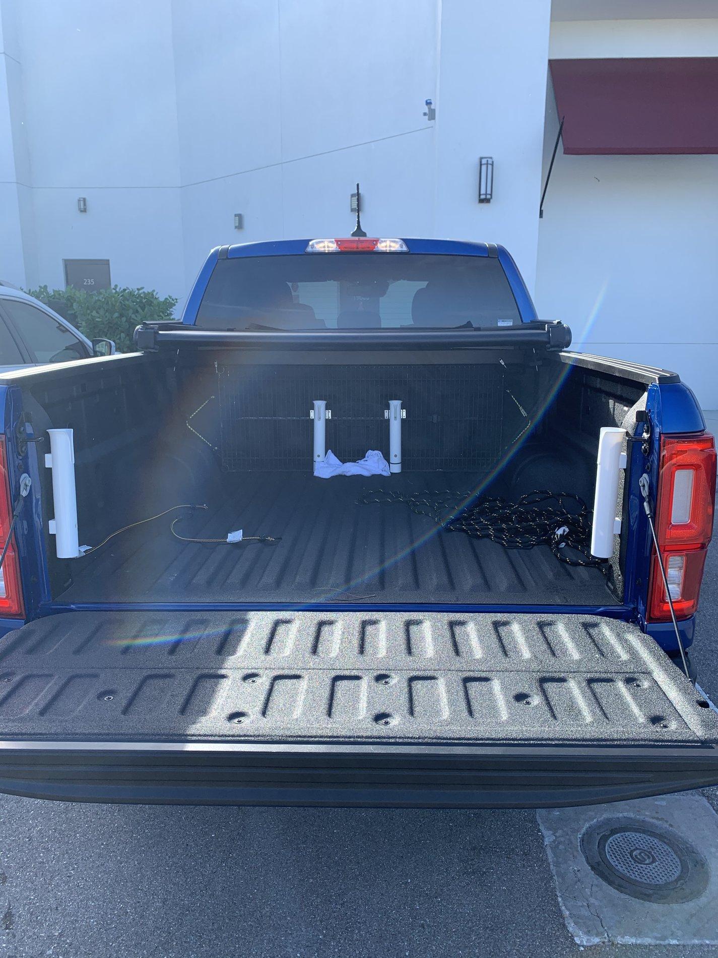

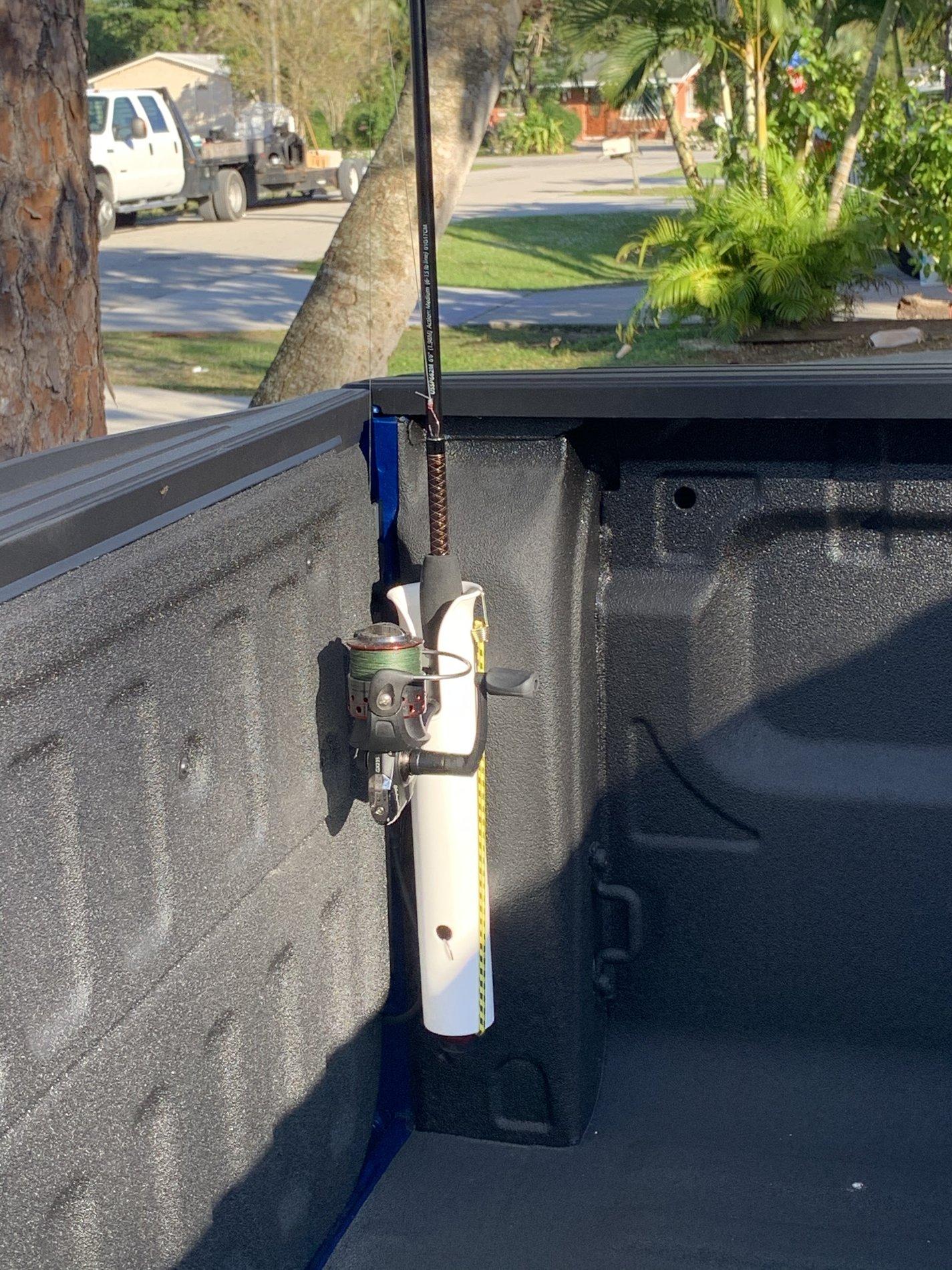

I have the 5 ft bed and I hate bending my rods into the truck bed. Anyone have any DIY rod holders for a truck bed they've built and can share?
#10 screw gets a rod holder snug into the available threaded holes on each side near the tailgate..
I can only get one bolt in where the holder wants two but itā€™s pretty snug with one , and i keep a 6ā€ bungee near the rear tie down just in case
Gets me 2 rod holders for $5 a piece
Maybe Iā€™ll paint them, maybe i wonā€™t
It works for now, enough for me to move on to another project LOL
Iā€™m hoping i can keep this set up when i install the pivot cases (NEXT!) which will be a tackle box on one side and a roadside kit in the other
