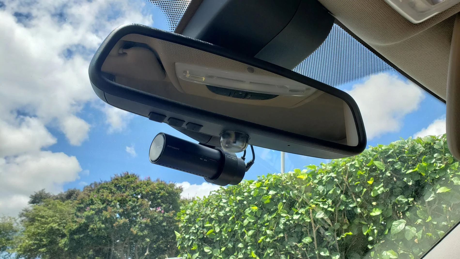

    Also, you may experience more reflection from inside the cabine if that location causes the camera to be further away from the window.
    Before you actually stick the tape up though, make sure to first just use the cigarette lighter power supply (or dry run the power from the fuse box) while having the camera run and watching the live view on the mobile app :)

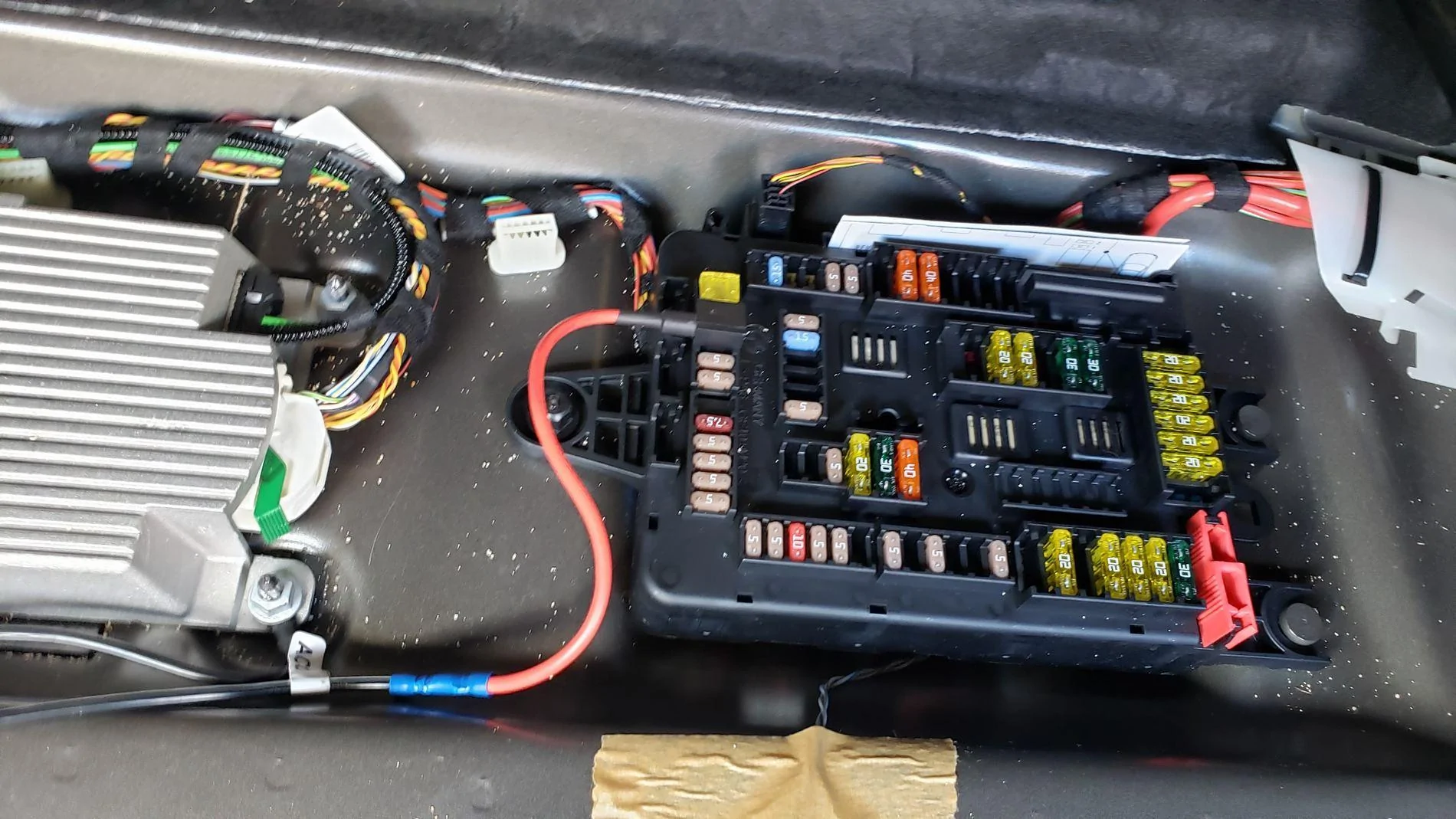

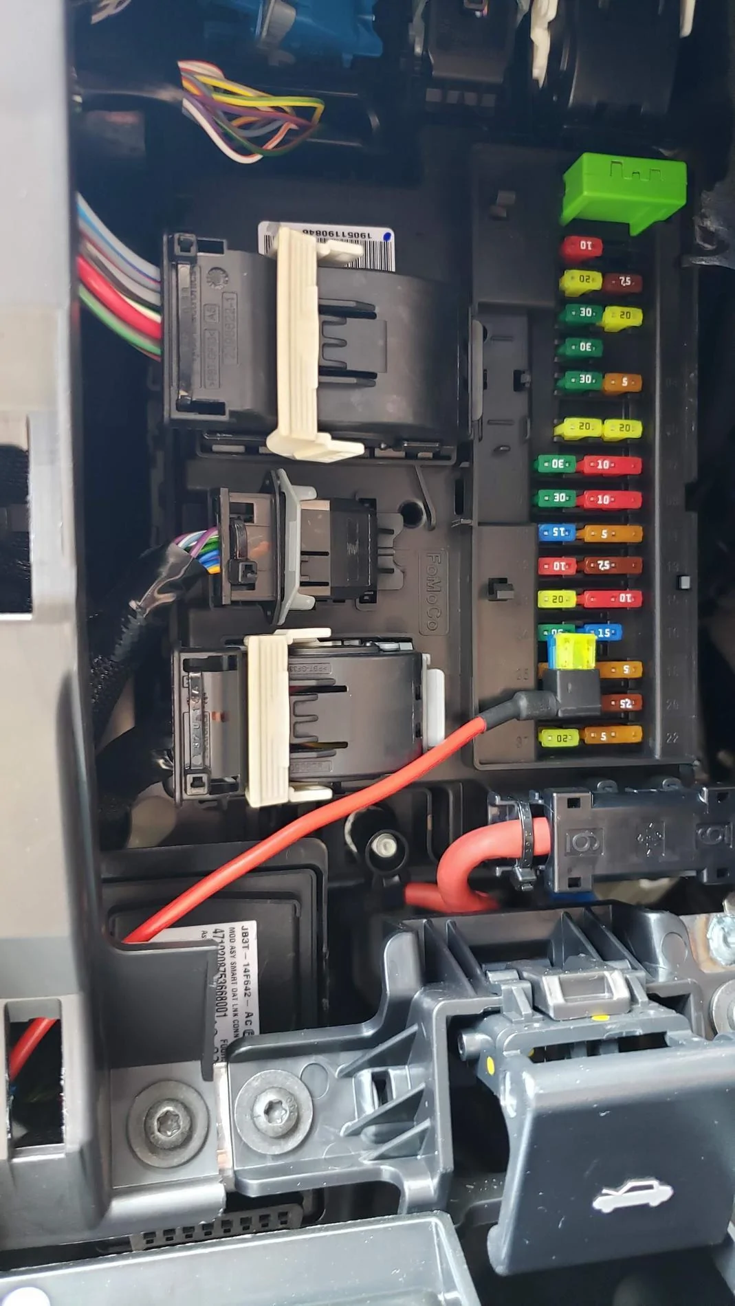

    The one I used was the Micro 2 fuse :)

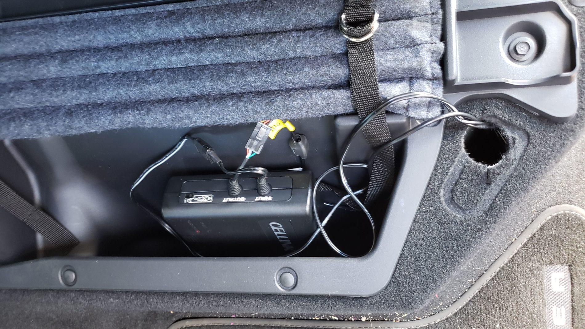

    I'm not 100% sure, my Cellink batteries only use the ACC and a ground connection. The one that's hooked up to our Blackvue is spliced from two to three cables, avoiding the BATT to be hooked up to a continuous power source.

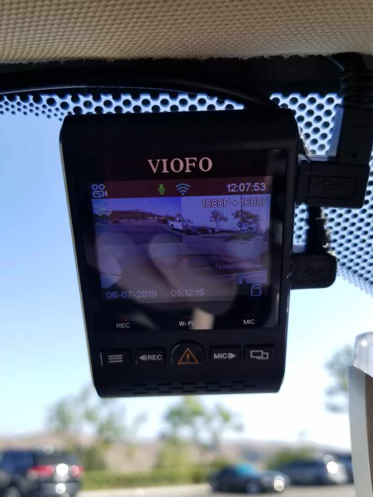

    I did the Viofo 129A Duo...hardwired:
    Tracy Bowman and svache like this.

    Nice! I like how you can view live on the camera what it's recording instead of having to use a phone.

    Thanks...Yes, me too, that’s why I picked this one. You can turn the screen off, plus view live or clips on my phone thru their app.

    Ok, why do you need a battery pack if you are coming of fuse box?
  11. Ranger #6
    Ranger #6 Well-Known Member
    First Name:
    Vehicle(s):
    2019 Ranger Lariat 4x2, 2012 MINI Cooper S, 2012 Toyota RAV4
    Joined:
    Apr 17, 2019
    Location:
    Marietta, GA
    Posts:
    93
    Likes Received:
    147
    Occupation:
    Aircraft Stress Engineer
    Garage Profiles:
    To extend the parking mode.
    Hounddog409 likes this.
  12. svache
    svache Well-Known Member
    First Name:
    JJ
    Vehicle(s):
    2019 Ford Ranger Lariat SuperCrew Saber, 2012 BMW 328i
    Joined:
    Jun 28, 2019
    Location:
    Oahu
    Posts:
    96
    Likes Received:
    81
    Garage Profiles:
    @Hounddog409 - like @Ranger #6 says, it indeed extends the parking mode. Another reason is not to drain the battery of the car itself.
    In my previous car, a '16 Explorer, I actually drained the battery at some point by using the parking mode without the extra battery pack. I had the camera set to automatically shut off when the power source would drop below a certain value (I think it was 11.8 or 11.9 volt), so it wouldn't completely drain it. However, after several months my battery was unfortunately completely drained after all and Sync started to give me all kinds of weird issues (which I didn't know at the time had to do with the additional power drain when the car wasn't running). I ended up having to jump start the car (and even replacing the battery at one point, but I think that was unrelated), and at that moment I realized it the dashcam may have been the cause of the extra drain and maybe the issues with Sync as well. I ended up ordered another battery pack (our other car was already using one), I installed it, and everything started working like normal. Sync behaved normal again and the car battery remained fully charged :)
    It's definitely possible to use it without battery pack. But knowing the issues I had with Sync after a while, I think it would be best to not use any parking mode if you don't have a battery pack. Cars nowadays with all their computers and electronics (gawd I feel old writing it like that haha) are apparently very sensitive to the amount of power available apparently. The reason our other car (a BMW) already used one was because of similar reports from other users that owned a BMW, as that car apparently is also sensitive to the amount of power available.
