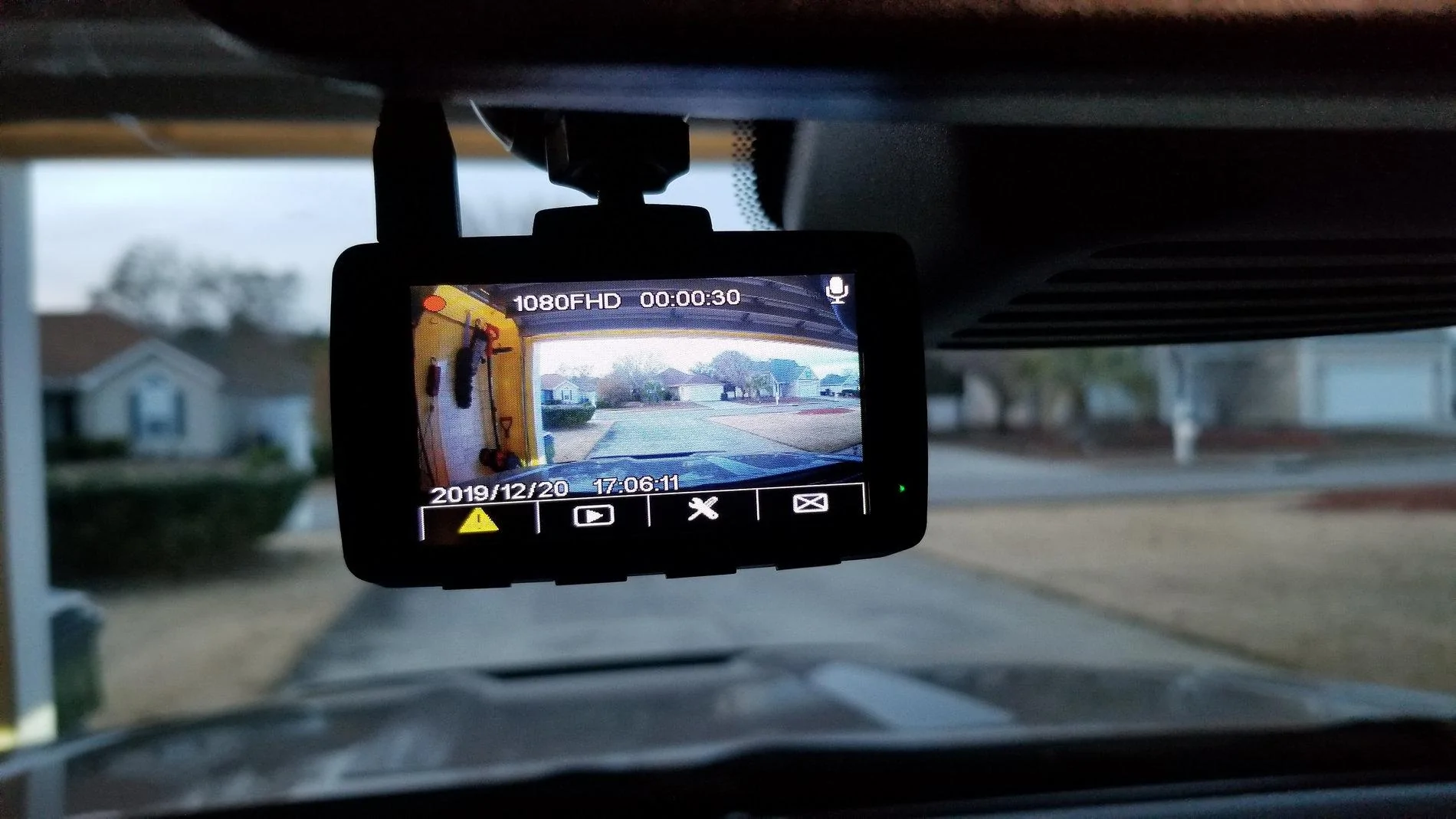

For those who are cheap like me , I bought anthis AUKEY Camera. 1080P I bought it to see if I wanted a better one.. I decided to keep it as it has worked well. Don't need the rear. If someone rear-ends me I am sure the front camera picture will show the bump. Plus I can turn it around anyway. I ran a wire up the A pillar from it front left 12V source. I am going to have a shop find a 12V source in the overhead console so I don't have to0 screw with fuses and taps
