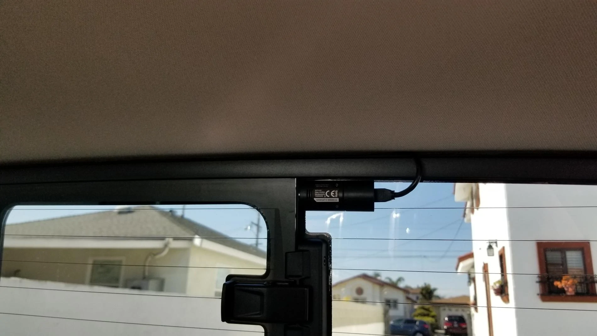

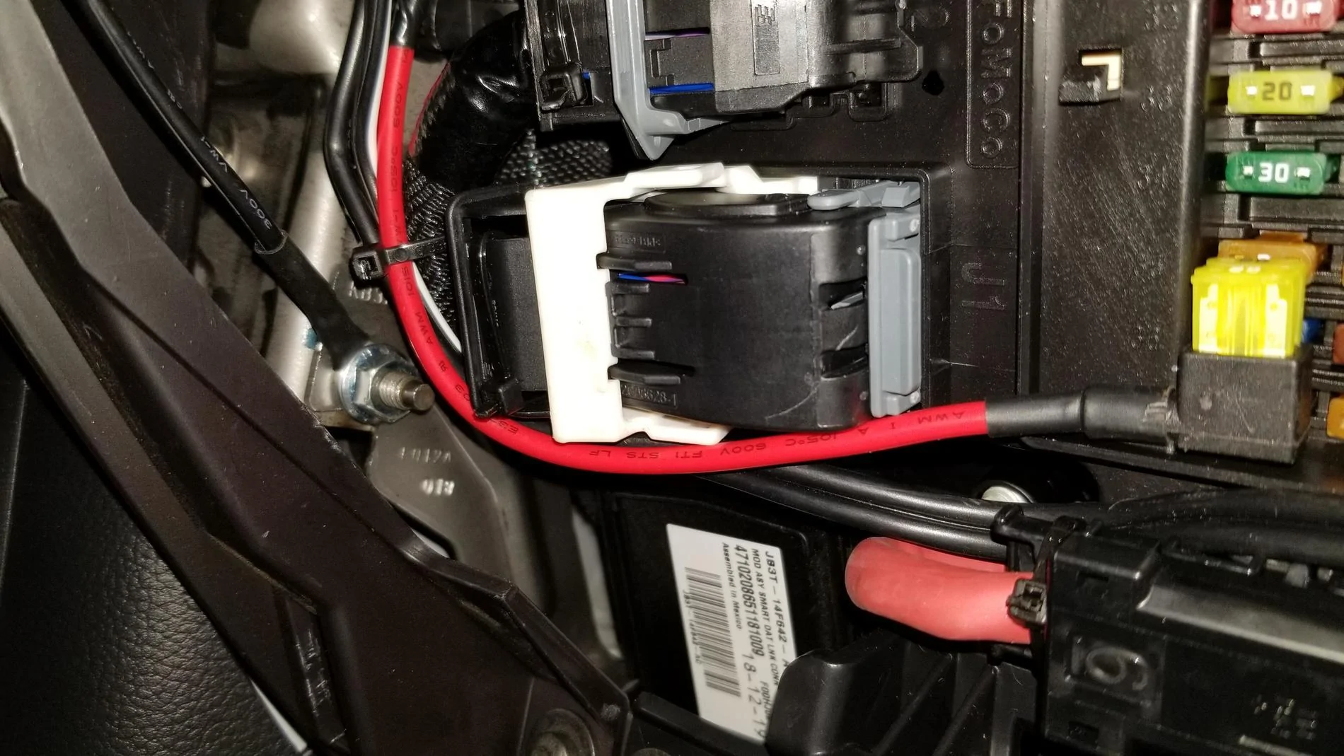

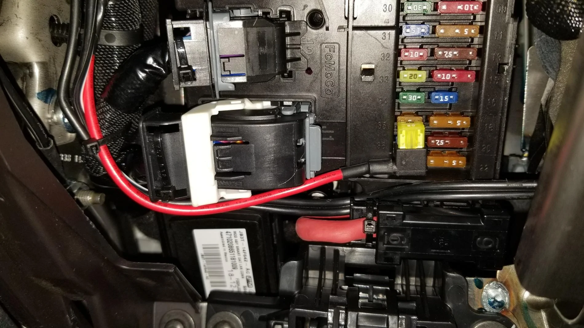

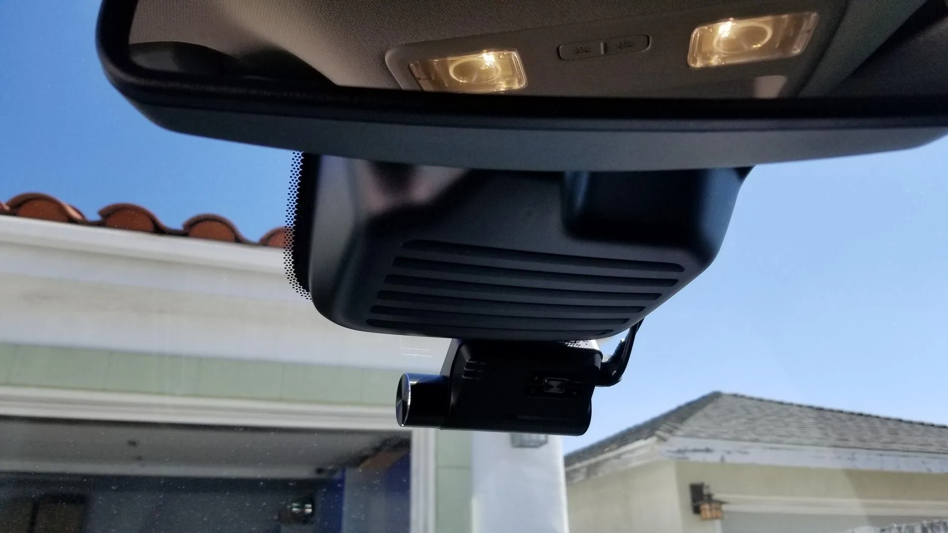

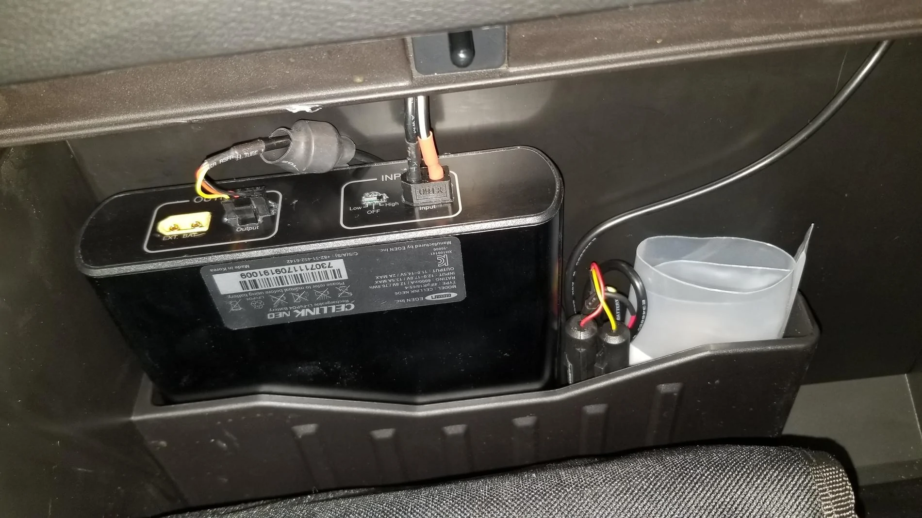

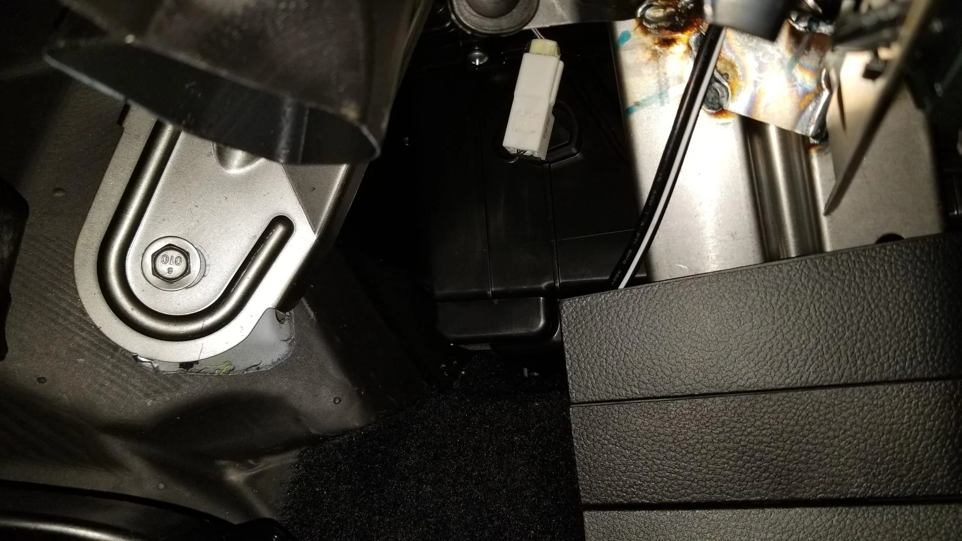

Thinkware F800 Pro installed yesterday. Battery backup is in the glove compartment, ran power to the camera up the passenger side A-Pillar, tucked in the head liner, down and around the lane departure camera housing to the front camera. Ran the rear camera's cabling up from the front camera, tucked in the headliner, down the passenger side A-Pillar, tucked under the passenger side floor door moulding, up the rear of the cab, tucked in the back of the headliner and down to the rear camera. Overall the install was pretty easy, but I just wish I could hide the front cables more... There's no easy way to tuck the wiring behind the lane departure camera housing unfortunately.
Front Camera:
Rear Camera:
Fuse 37 - in cabin fuse box:
Grounding point used:
Power to battery backup ran under the AC blower:
Backup Battery in the glove compartment:
Hey dude!
I have the exact same setup as you. Same cam and battery pack. I used the same tap in the #37 fuse. My camera will not go into parking mode and stays in continuous record mode. I am not sure what I have done! Is there certain settings within the camera that need to be applied? I have it set to parking mode, but most of the settings I am not sure of what they do. Sorry for the dumb questions, I am lost. Install was easy though.

Hey Josh,
So step 1 would be to make sure that you have actually used fuse 37 and not one adjacent to it. If possible, check the output of the fuse holder to make sure the voltage is going to zero when the truck is off. After checking that, make sure that parking mode is enabled in the app and you've saved the changes. If that still doesn't solve it, I believe I had an issue where the 12v switched and 12v constant out from the backup battery were reversed and it caused the camera to never to to parking mode. You may want to check those as a last step.
Good luck and let me know if you are still having issues!

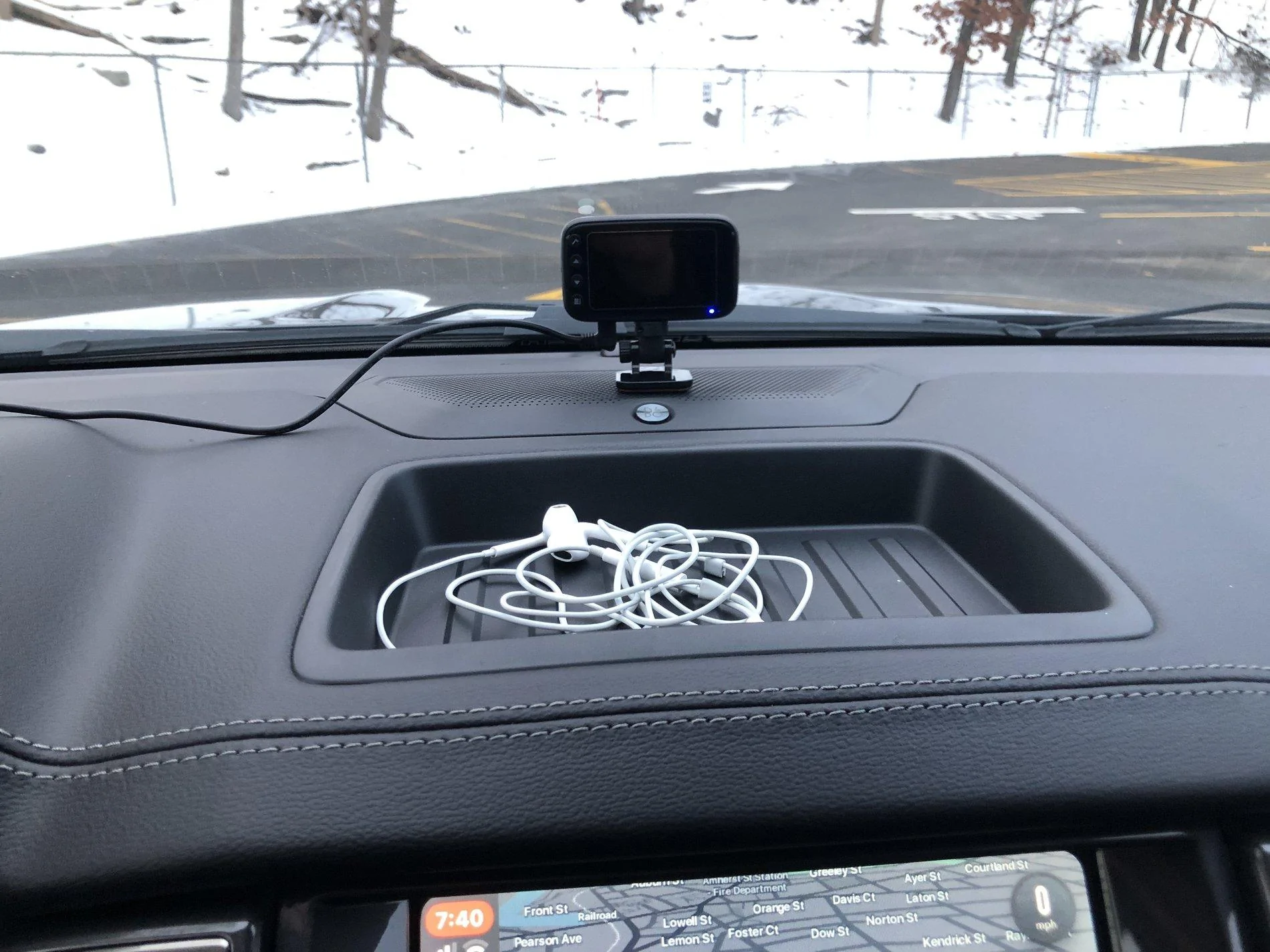

I did this for now, I’ll move it later. My rear cam cable goes down the passenger side, under the glove box, and then down the center console to the back. The husky floor mats hide the cable

I’m not sure the camera is getting the best video it can.

Ive read through this a couple of times....the battery pack is more expensive than the camera from what I see. If following the fuse numbers in this thread, will the camera work in parking mode without the neo external or is that needed? Maybe the external battery is just needed so you can run longer?

You can run it without the battery pack, but you'll need to install a regulator that senses battery level and shuts the cam down when battery power gets below a certain level so you don't drain it too far. If you frequently drive that vehicle, no problem, if it sits for long periods, not so good.
