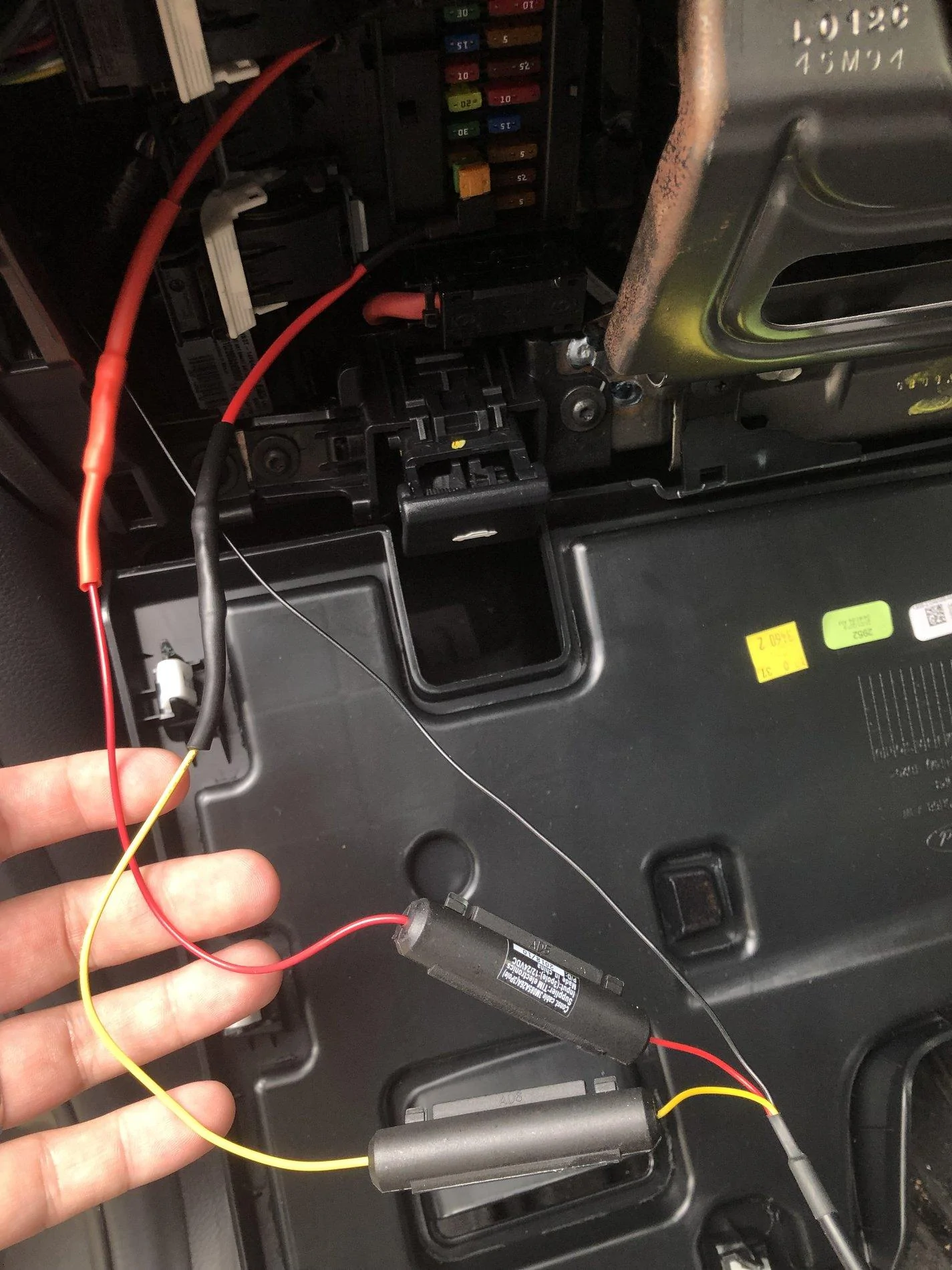

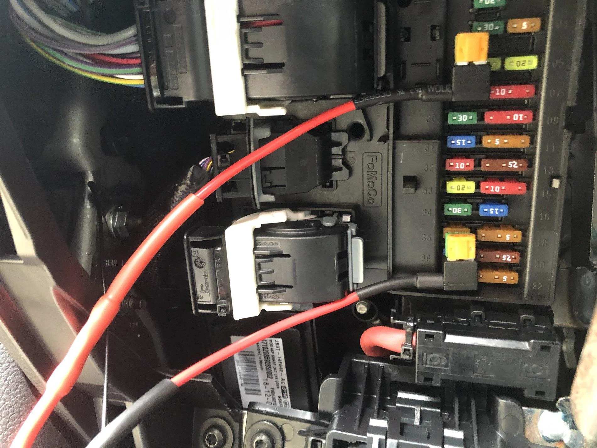

I finally got the Thinkware hardwire kit working after reading lots of advice online and from @j0shm1lls.
I used fuse 29 (Micro 2 Fuse - 30A) for constant power and fuse 37 (Micro 2 Fuse - 20A) for ignition power/parking mode.
You need to butt splice the constant power fuse with the red hardwire cable, and butt splice the ignition power fuse with the yellow hardwire cable.
I used heat shrink cables to make a clean install of the add a fuse cable to hardwire kit.
rangerdanger
Oct 9, 2018
194
3,487
2,671
SF Bay Area
So after driving for a few days with the hardwired dash cam, I can report that it doesn't affect the Auto Start/Stop feature and ACC will not turn off the dash cam when engaged.
It could be that since Fuse 29 and Fuse 37 are not used by the truck, those fuses won't affect ACC.

Ditto: I've had my old super-mondo-cheap Blackbox G1W hooked up for two weeks now and I can report the same. Works just fine with Fuse 37 and does not have any issues when stop/start is activated.

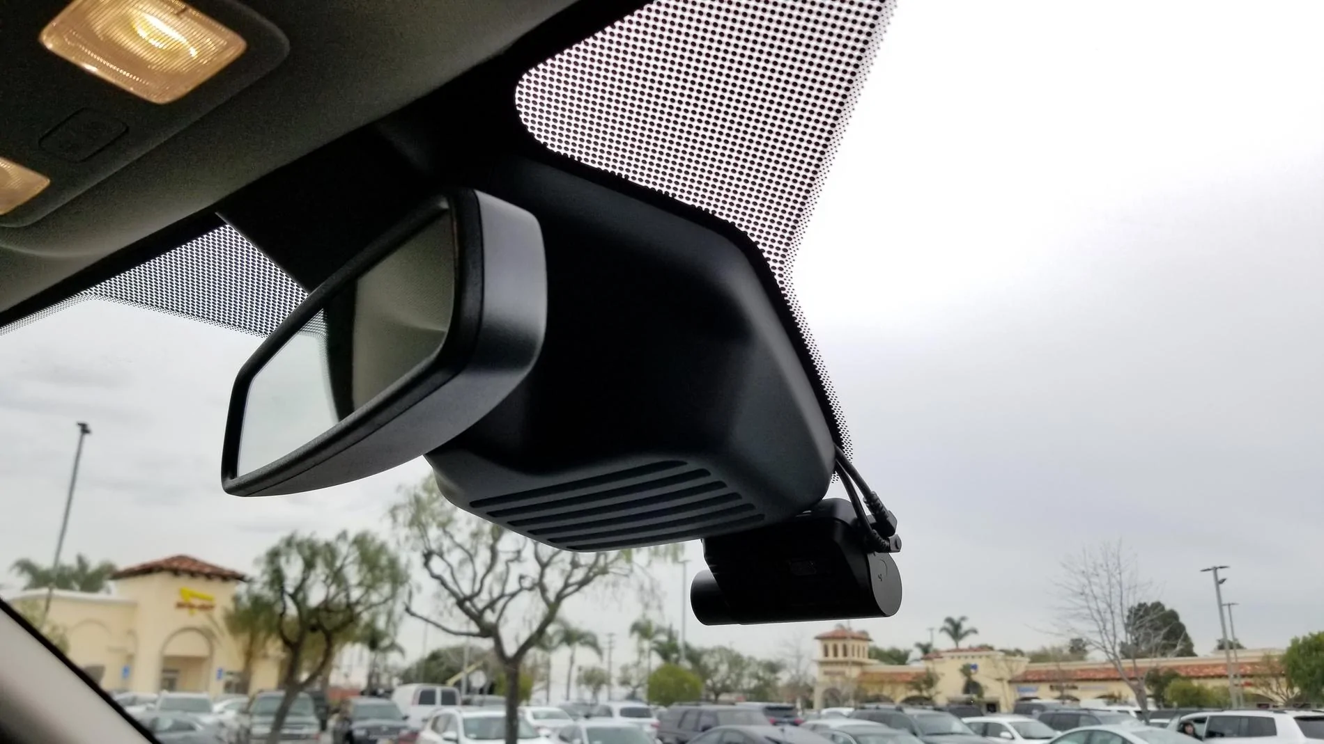

Driver's view:
Wiring tucked:
Sample video front:
Sample video rear:
