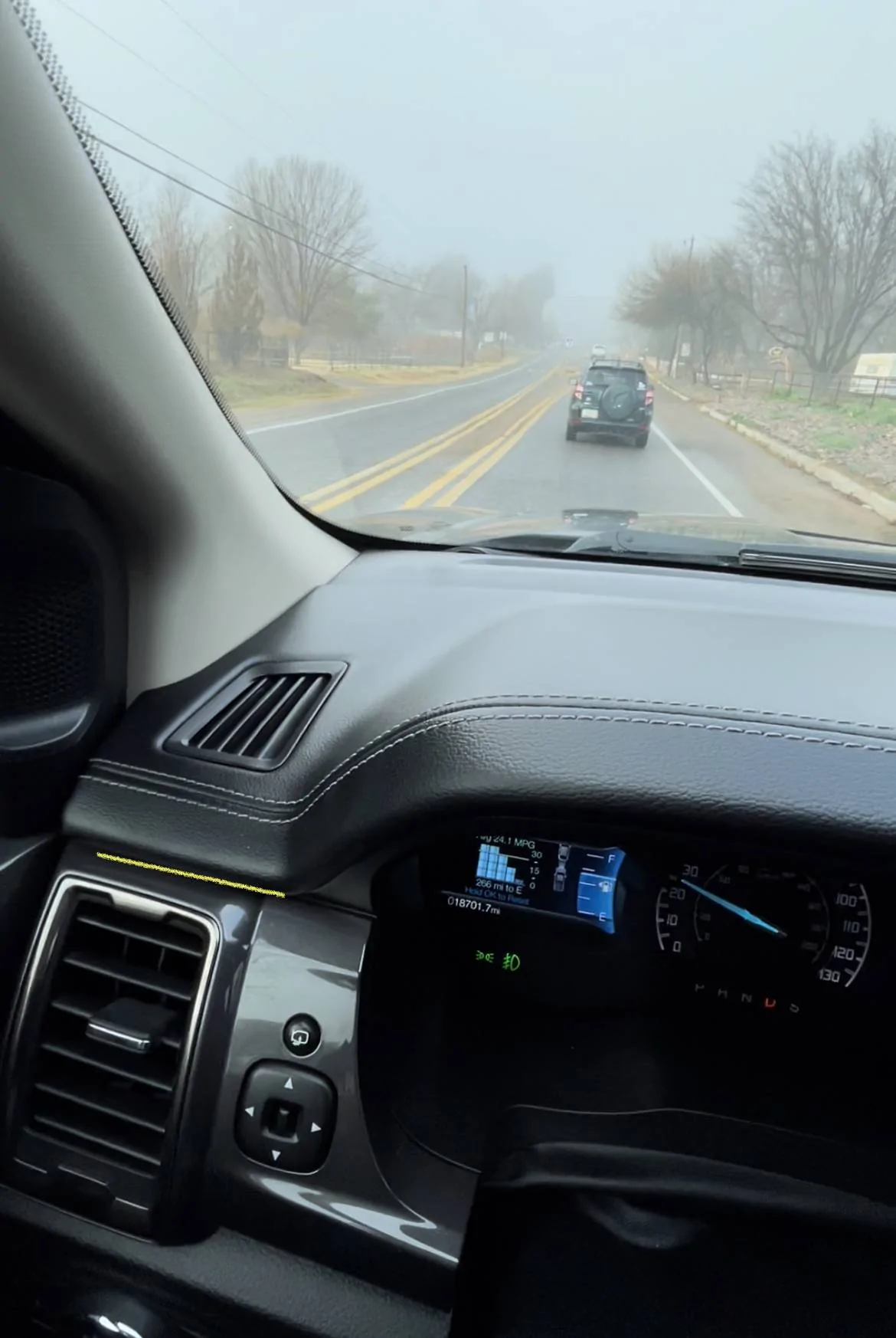

When you heard that the noise is coming from the driver side defroster or dash check this 3 solutions:
1) take off the plastic defroster at driver side only , lifted and put some thin Line of foam or felt cloth tape. ( careful , those blue clips are tight as hell)
2) remove the driver air vent with some plastic tool , in the photo the yellow line put a thick foam or spacer between the plastic dash and the body console. Make it tight !
3) as you know sometimes noises are not exactly comes from where we think… Mine was driver the air duct. Pressing the dash buzzing gone. On cold wether. Well , the issue was that. Driver side ac duct. Was a bit loose. Guide your hand under the pedals until you touch it , put a good amount of Thick foam on any space between the Duct and the console , to avoid moving.
my main language is Spanish but I do my best in English to help the community. Don’t hesitate to ask. I’m an expert finding and fix interior Rangers buzzing or rattling. Hope this helps -Wiss
