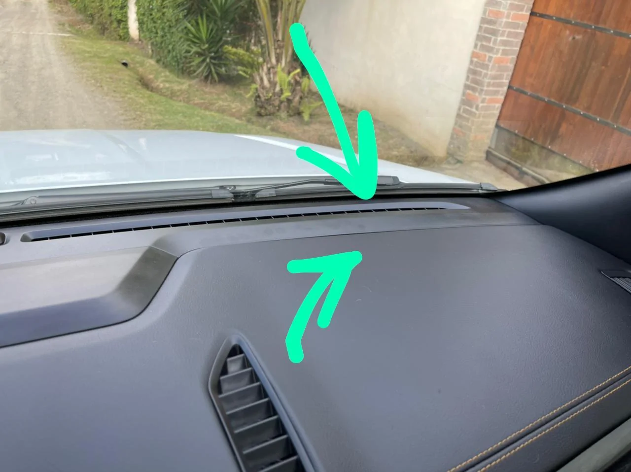

Hello everyone !
I bought my ranger 7 months ago and I started to hear a rattle behind the dash in the drive’s side 4 months ago.
I live in a ranch so I have to drive on a rough road everyday. When I drive there I hear the rattle.
I went to the dealer and they tried 2 times to solve the problem and they couldn’t so they decided to send a technician to my house to test the car there and solve the problem at the same time. At the end we did it.
We put foam between some pieces behind the driver’s side of the dash. I think it was between some pipes.
That day , the technician noticed that an engine of the A/C had a problem, then he asked for a warranty order to chance the engine.
When he did that, he had to remove the dash to have access to engine. Finally, when I went for the the car, I noticed a new rattle in the right side of the dash, to be more specific it sounds like the grill behind the dash is vibrating. I haven’t had an idea when o where it starts to sound.
Then I would like to know in which parts of the grill the dealer helped you to adjust with felt in order to try the same with my car.
thank you,
Pd: I live In Costa Rica...
