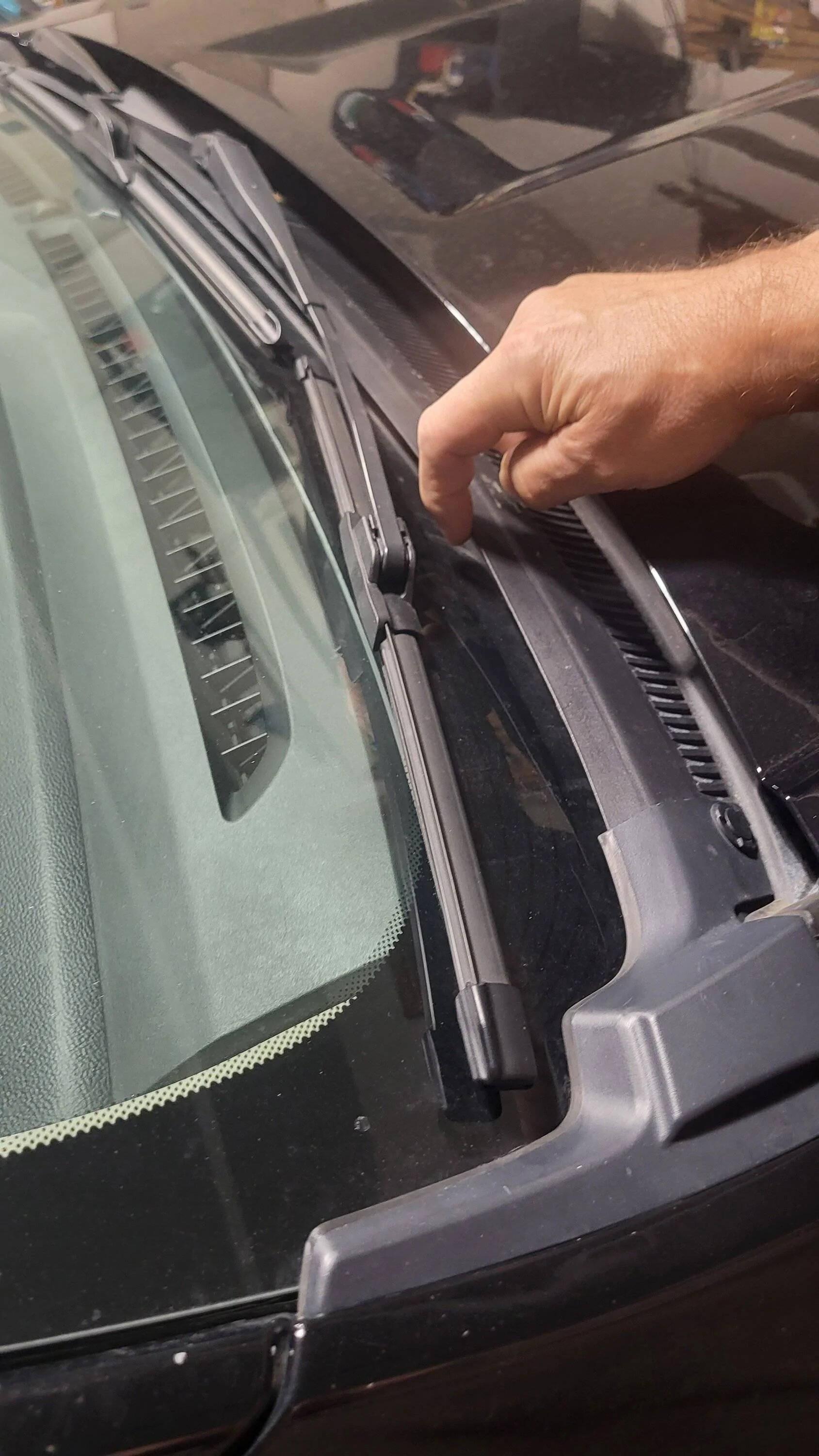

I have a 2020 Ranger Lariat. I found that the rattle that sounded like it was the dash was actually on the outside. There is a black molding just underneath the wipers, it runs across the bottom of the windshield. This molding slips out of a retaining channel. This molding taps the glass which sounds like it coming from the inside. When you hold this black molding the rattle goes away. I tried to press the molding back into the channel but is keeps popping out. Looks like a warmer weather job. Hope this helps guys.
Good info. Please post a pic of the molding.

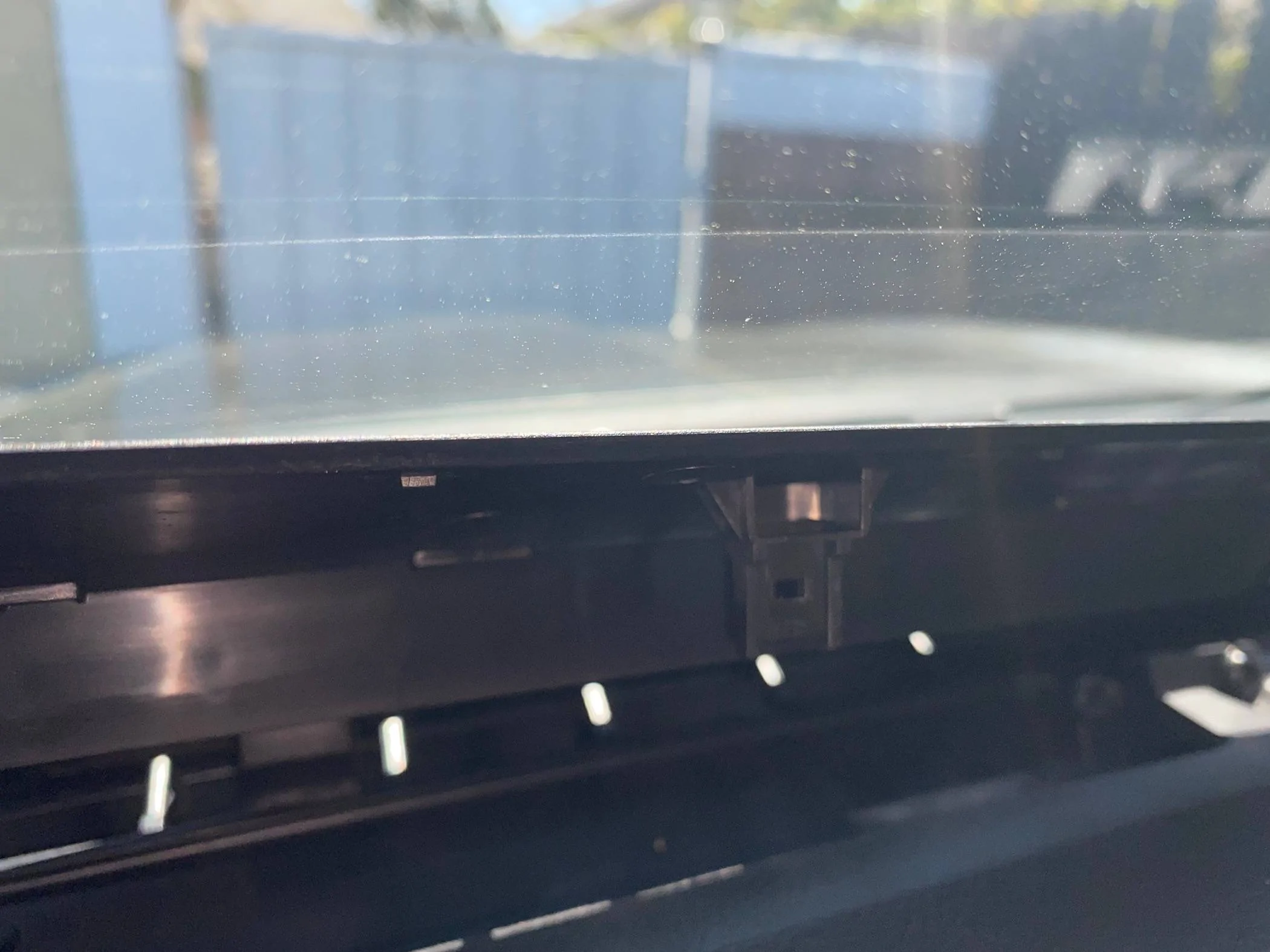

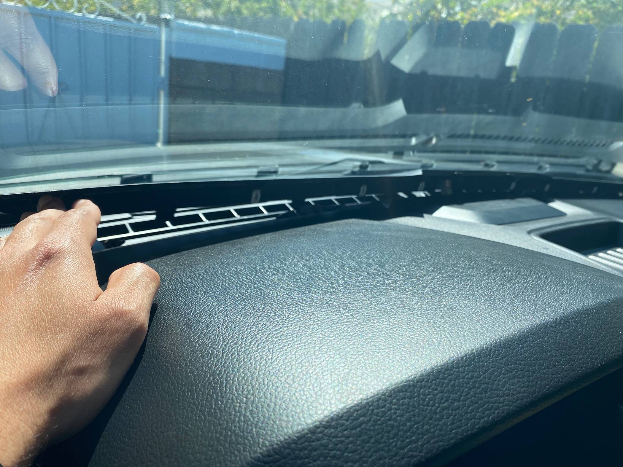

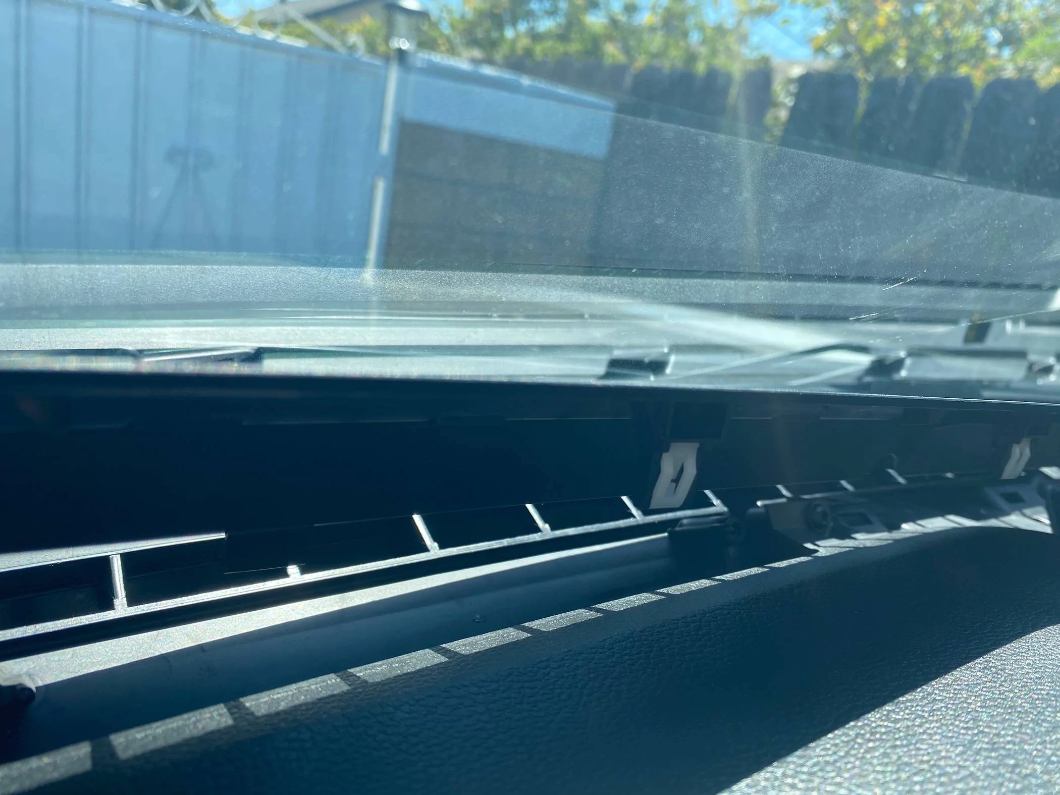

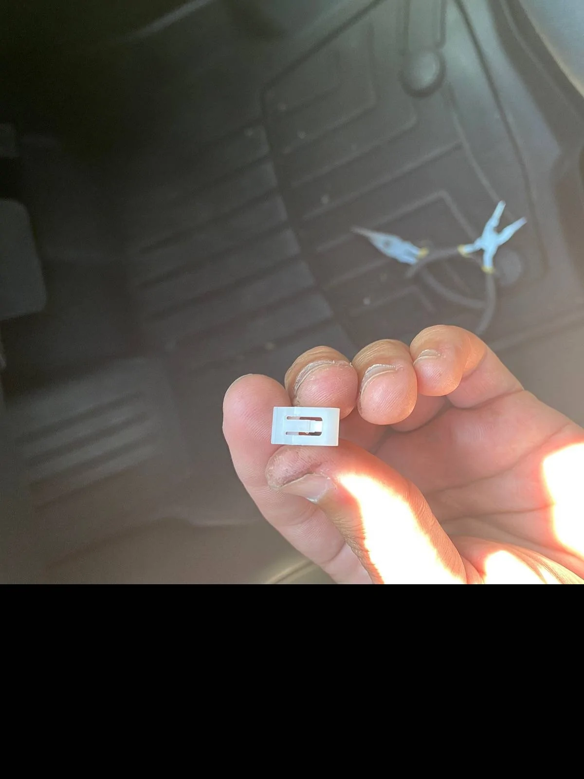

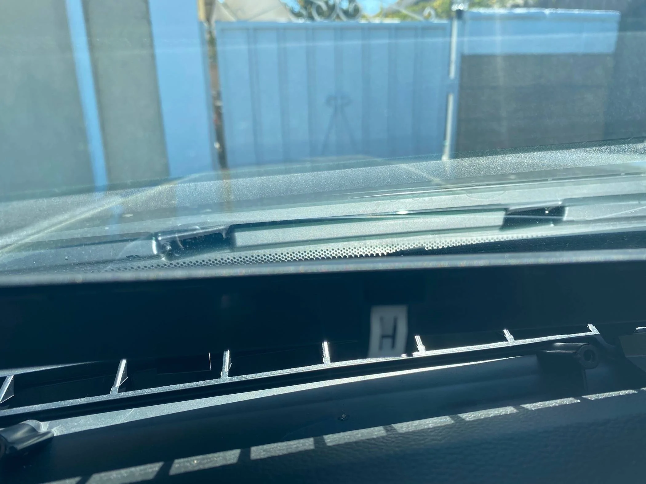

Dashboard Rattle Sound FIX!!! Just wanted to share this with you guys. Purchased this 2020 Ford Ranger XLT FX4 a few weeks ago. Noticed a pretty annoying rattle sound coming from the driver side dashboard area. The rattle would come and go sometimes and other times would not go away. Finally took apart the defroster vent trim piece. After inspecting and experimenting with various potential causes, I finally determined that one of the clips on the trim piece does not actually attach to anything. There is a gap in the dashboard assembly where that clip would attach to. Since the clip is hanging freely, it vibrates and moves around causing a rattle sound. Once I removed that clip from the trim and reattached everything, the rattle was gone. I have driven the truck for about 3 days with absolutely no rattle. Hopefully this can help someone else with a similar problem. My Ranger is a 2020, but I would imagine that this can work for 2019 and newer models as well.

Yes. Mine was a rattle/buzzing sound. It would start and stop randomly. Whenever I had a passenger, they would always ask, “what’s that rattling sound?”. It was right above the gauge cluster closer to the windshield. Finally took the vent apart based off of other forum post suggestions and after some trial and error noticed that one of the white clip fasteners doesn’t clip into anywhere. So that’s what was causing the sound. The white clip was just vibrating back and forth on its post.
