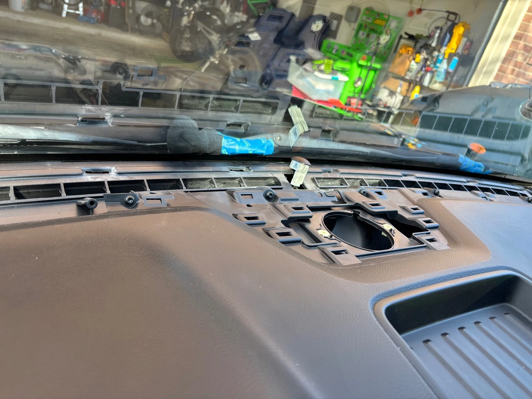

It seems like mine is right in the middle but maybe under the dash. No amount of pressing on anything changes the sound. Has anyone seen a video or instructions to remove the top dash?
My 20’ XLT rattled on the top dash piece. If I put pressure on it with my hand it would stop.
I pulled the piece off and put felt tape on the clips and any other place where there was plastic touching plastic and the noise is gone.

Update:
I got the forward most piece of the dash off with no problems. Just slid a plastic ruler between where the forward/rear pieces meet and clips start popping off. Super easy. Drove around like that with 0 change no matter what I pushed on.
Went back to the wipers. Took the blades off and removed the springs to relieve all tension on the windshield, wrapped the hooks with a sock and painters tape so they wouldn’t tap or scratch the glass. Drove around for a bit and heard absolutely nothing. Seems to be 100% related to the wipers. Maybe I can find some old school ones that don’t have the blade design or some lighter springs. Just glad to know it isn’t deep in my dash somewhere! Thanks everyone.

ohh, i have not thought about the wipers being part of the issue, my rattle sounds more like metal than plastic. Who knows.
